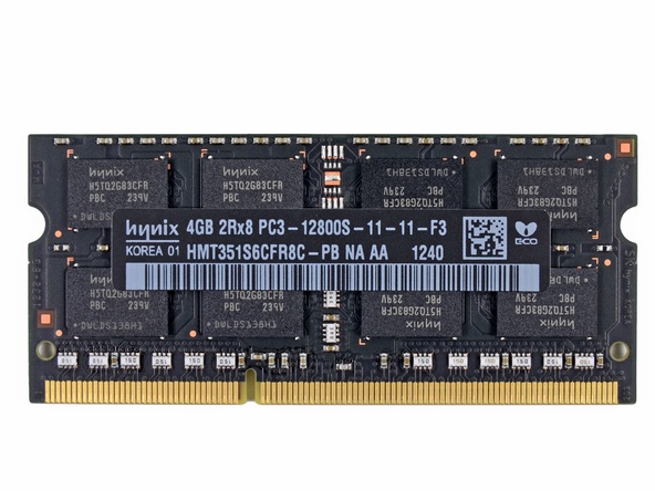

Checked ifixit website. 21.5 ram is CL11. Assuming for now same us true for 27. Those with Crucial ram upgrade should be good to go.
http://www.ifixit.com/Teardown/iMac+Intel+21.5-Inch+EMC+2544+Teardown/11936/3

Good news thanks for sharing! So hopefully my 16GB Crucial RAM will run with 1600Mhz and the 8GB Apple RAM too. How can I see at what frequency the RAM is running? Is there a free application?

Ahh, very good find. It looks as though it wasn't the iFixit tear down that was the problem. It was my speed reading and inability to click on all of the thumb nails.
It's probably safe to assume that the 27" also has CL11. I have to say that it does not surprise me that Apple would cheap out here, but it really makes the mind boggle when one considers the price of the memory upgrades.

Just got my new 2012 iMac set up, I ordered it with 16 gb (2x8) , and then purchased a Corsair Vengeance Kit from Amazon (the one several people have linked in here) it is 1600mhz ram I'm looking right at the box as I type.
The model number of the ram confirms it is 1600mhz, CMSX16GX3M2A1600C10
But when I go to "About this Mac" it does show correctly 32GB, but it's running at 1333mhz not 1600mhz.
And if I go to Hardware/Memory it shows all 4 sticks running at 1333mhz.
Any ideas???

I was trying to make this thread clear. The reason of 1600MHz just running with 1333MHz is because he bought CL10 ram and add it to the stock ram, which is CL11.
Correct.
