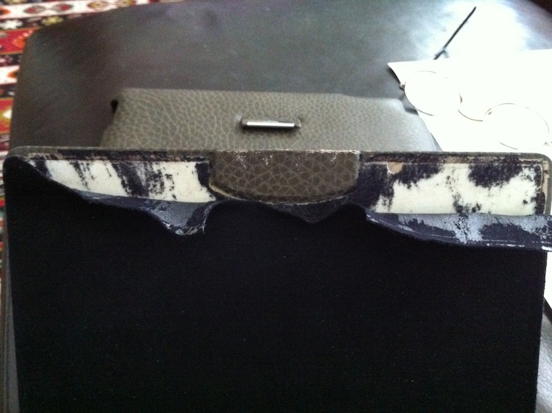

Awesome - I had actually been playing with some magnets to try to figure out what had changed because I was about ready to do what you did - surgery on the Vaja. I paid too much to not keep using it. Giving it a go. I may take photos of the process for others.
Perfect!
First pic when I went Hulk on it not knowing where the magnet was . . . 😱
attachment.php

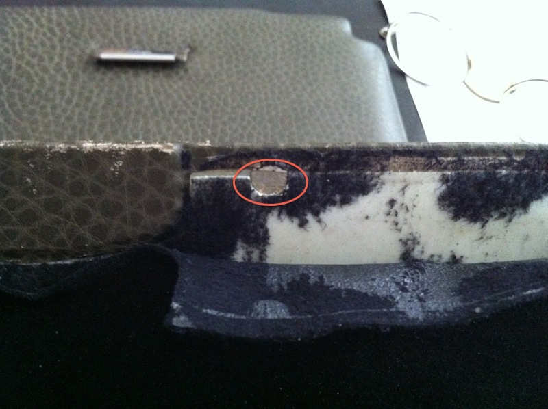

Close up of the location of the magnet. As said flip it. When mine flipped out I couldn't tell which side was which. I would suggest using a pen to mark the original side up to make it easier to know which way it goes.
attachment.php
I then laid the felt back over and tested it and it works great! I had some old Elmer's glue and used that to stick the felt back down. I've got heavy books on it right now and should be good to go in a couple of hours.
Thanks again for the info!
