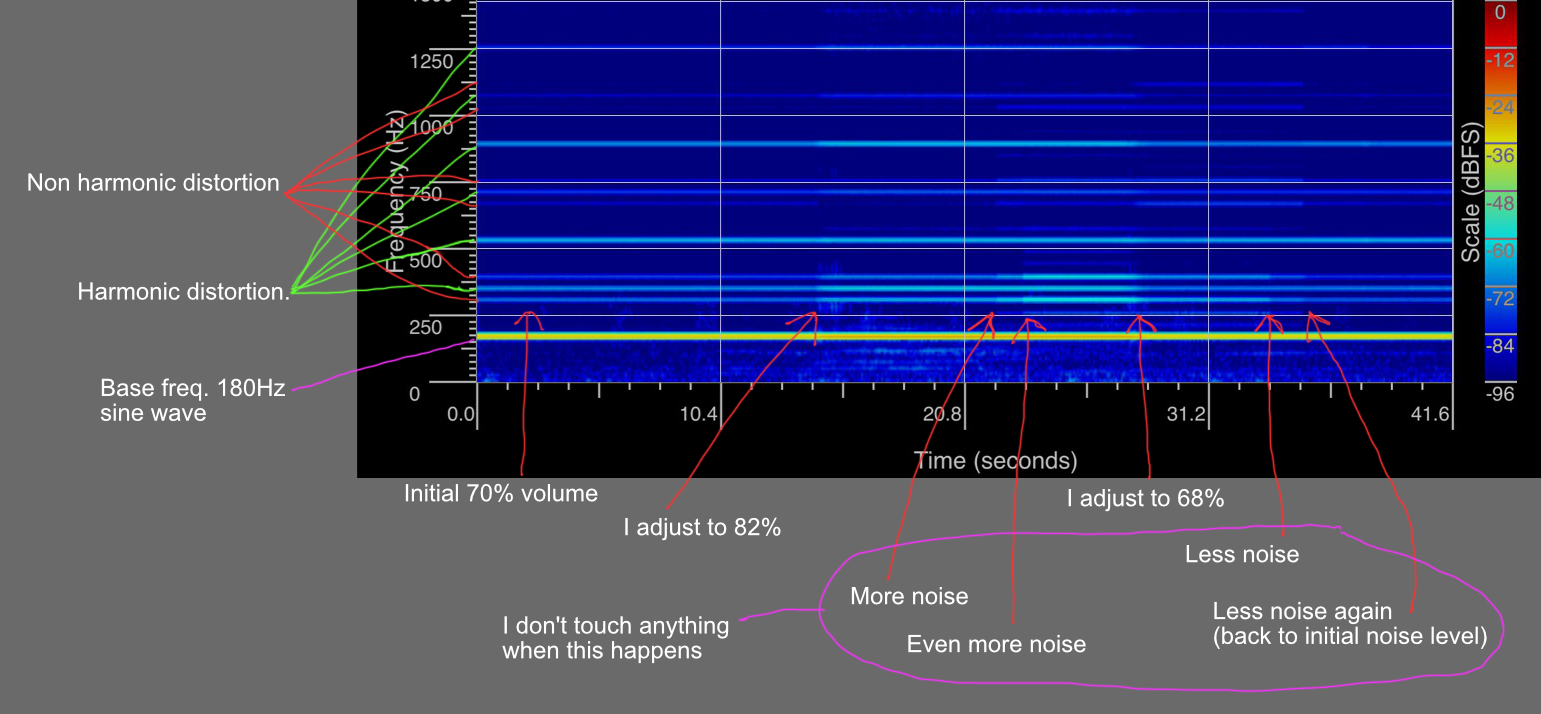

I am now certain that the iPad is defective. I will return it.
I decided to do a science on the problem...
For the technically interested, here's how I determined that the iPad is defective:
Before we begin, let me clarify that the main problem is not that the iPad is unable to play a pure sine wave, it's simply the easiest way to illustrate why it sounds awful. All tests are done in a room with acoustically dampened ceiling, and the devices are placed on towels to eliminate rattling.
When playing back a pure sine wave and comparing the 1st gen and the 2nd gen there's a big difference in clarity.
Above ~500Hz it sounds ok, but below it sounds awful. Worst case is around 180Hz

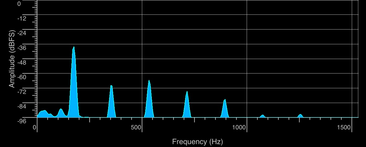

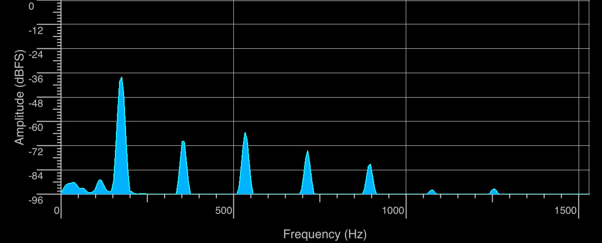

This is a spectrum plot of the 1st gen iPad at full volume, 180Hz sine wave:
This looks nice and clean with some harmonic distortion, which is fine.

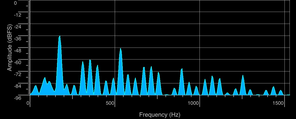

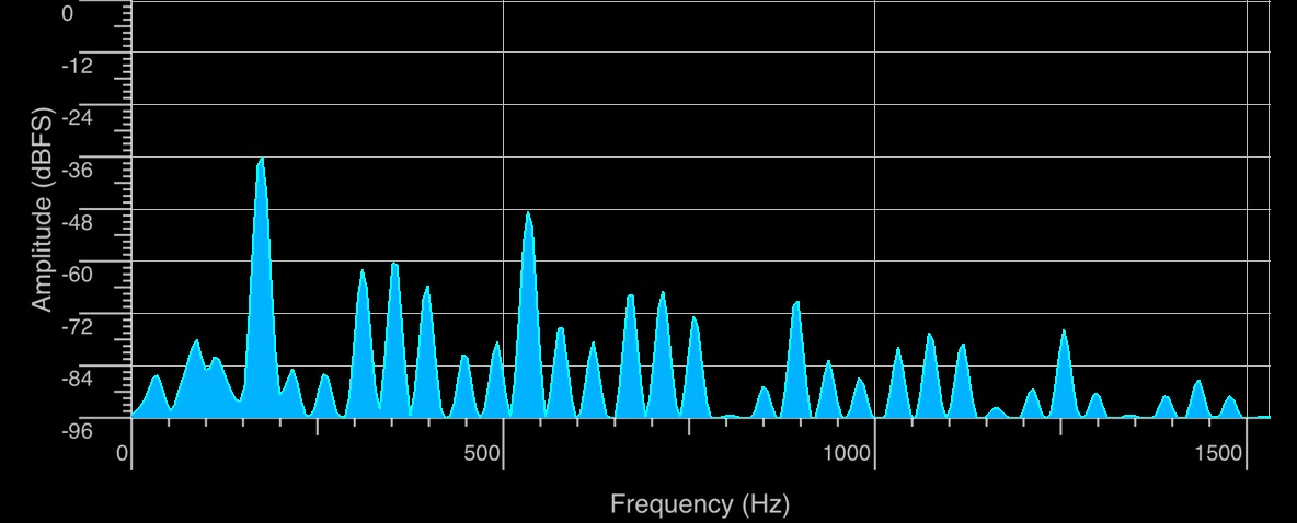

This is the 2nd gen plot at 75% volume:
Lots of non harmonic distortion. Not good.
I have tested all the older iPads I could get near, and they all sound great and produce a spectrum view similar to the 1st one above.
Video of a direct comparison, 1st gen left, 2nd gen right:
Next I tested speakers vs. headphone jack on the 2nd gen iPad. The spectrum view is live as illustrated by me making noises:
It's a little hard to hear the sound from the headphones, but the spectrum view says it all. Headphone out is a clean signal. Speaker output is full of non harmonic distortion.

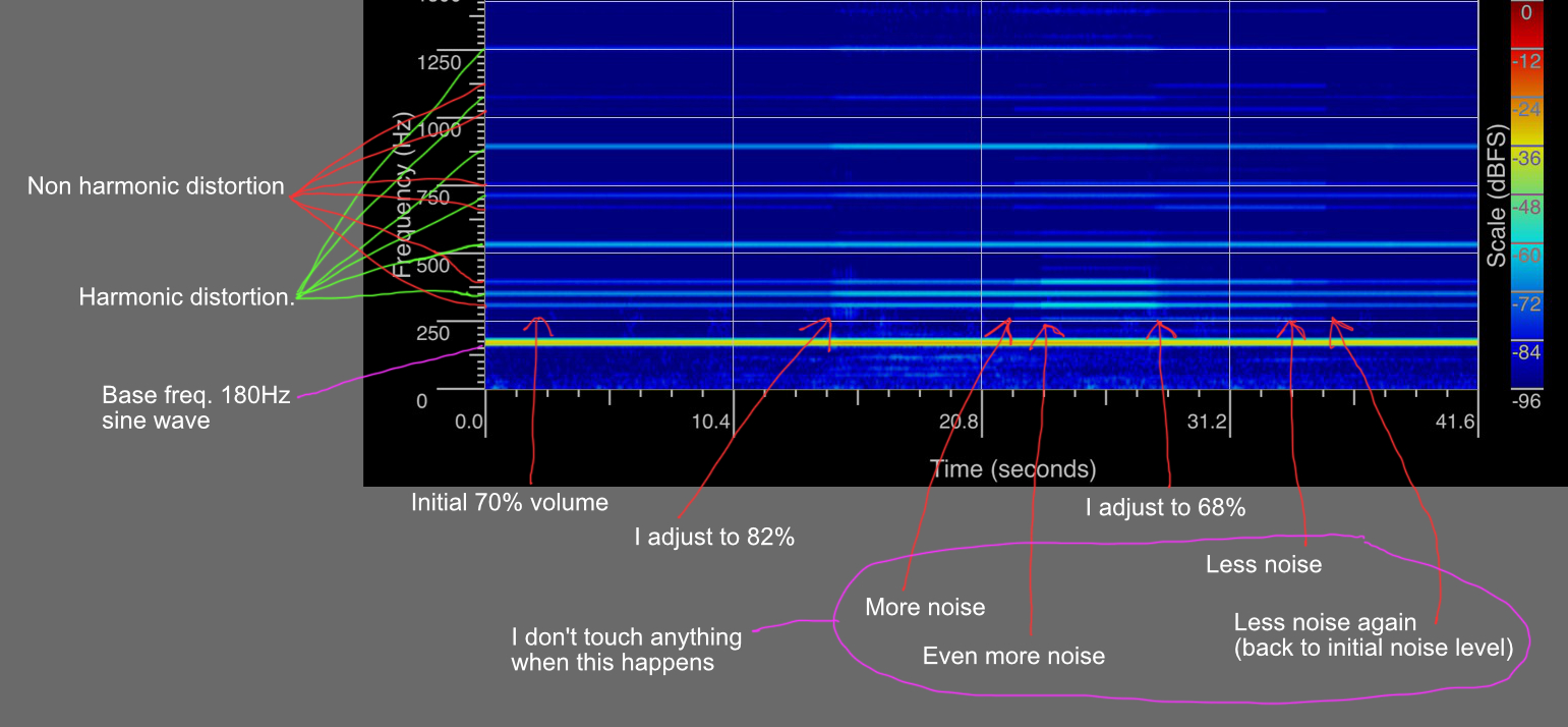

Now please direct your attention to 0:32 in this video. The distortion gets worse by itself.
When playing below ~75% volume, some distortion is present at a constant level. At around 76% volume the distortion increases after 10-15s and again a second later. When lowering the volume, the distortion decreases after a few seconds in two steps.
At higher volumes the two step increase is significantly faster. Above 90% it happens almost instantly.
Here's a waterfall view of that phenomenon.
(Please excuse the crudity of this model. I didn't have time to build it to scale or paint it)
After restoring through iTunes and setting up as a new device, the problem persisted.
