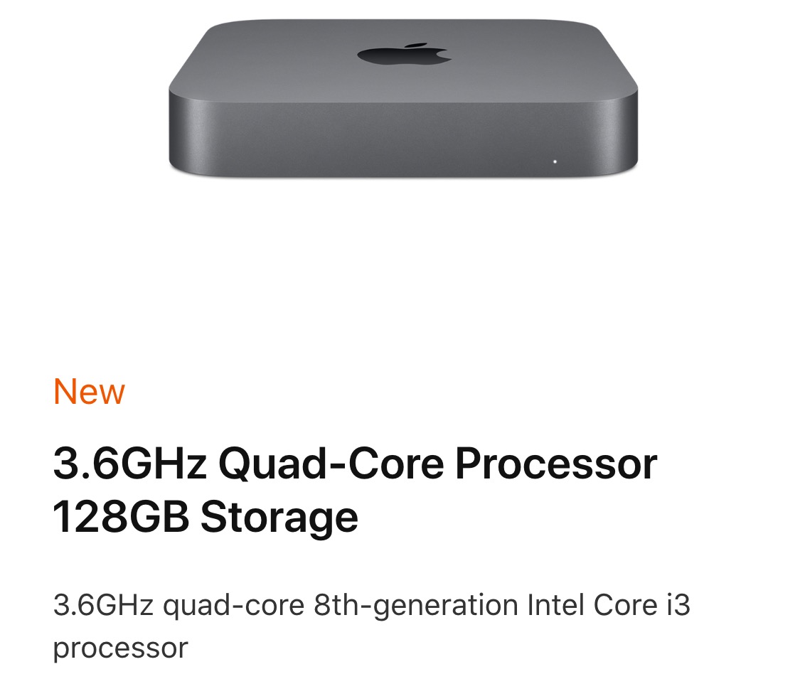

The 3.6 gHz quad core i3 CPU for the 2018 mini will run the coolest. You'll likely never hear the fan.
