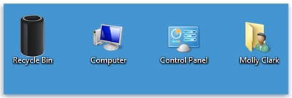

Apple made fun of the BSOD in the Finder, it would be fair for MS to return the favor..
