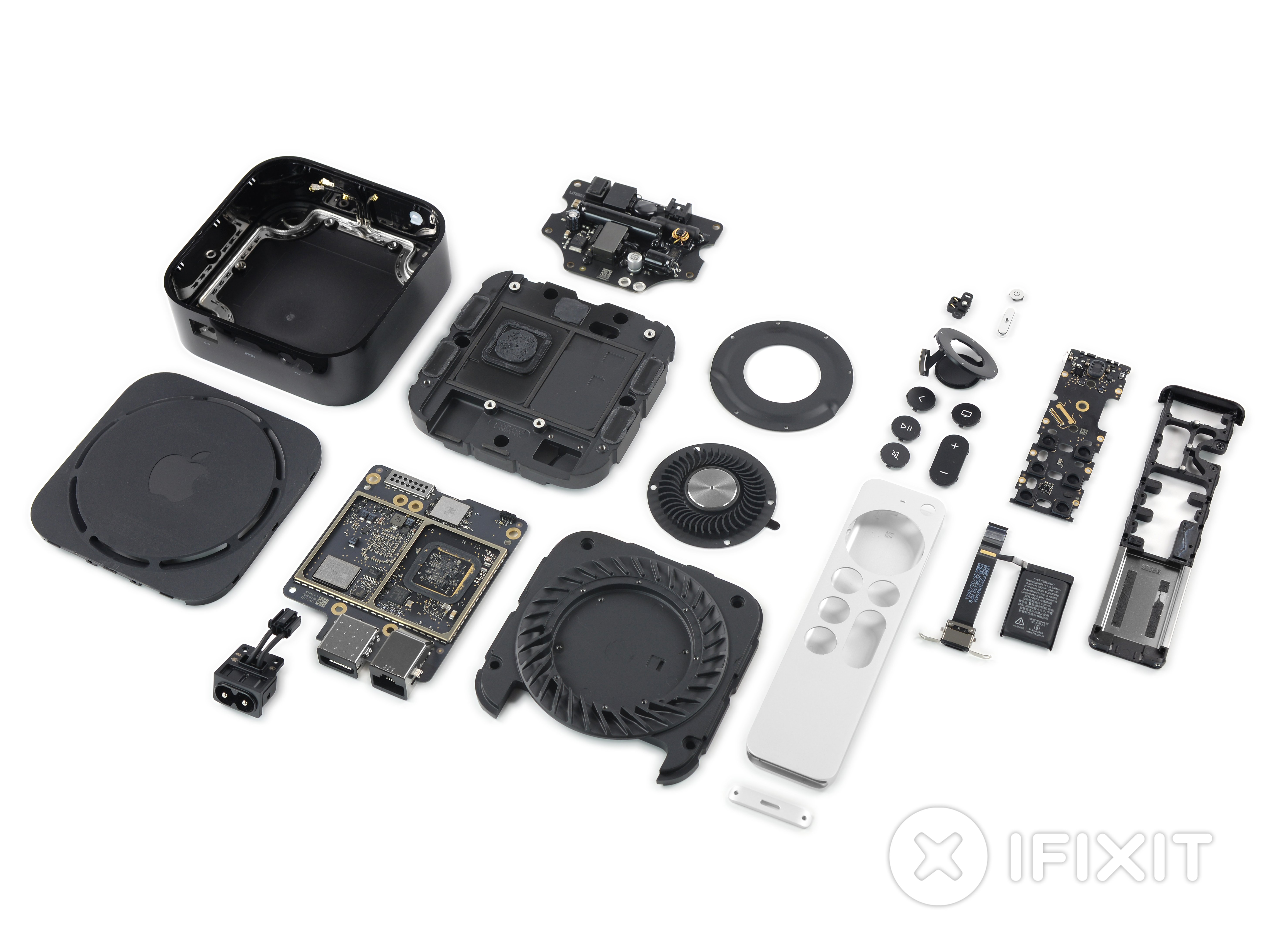

Step 1 of iFixit tear down
"...Kinetic Technologies MCDP2920 DisplayPort-to-HDMI Converter ... "
It is a discrete converter.
Just like the AppleTV 4K 2020
" ... Kinetic Technologies (formerly Megachips) MCDP2920A4 DisplayPort 1.4 to HDMI 2.0 converter ... "
Same parts used in multiple products means lower bill of materials cost for Apple.
If good enough for 4K TVs then will cover the overwhelmingly majority of the conference projectors and random TVs available. And Apple doesn't have to do much new software driver wise.
