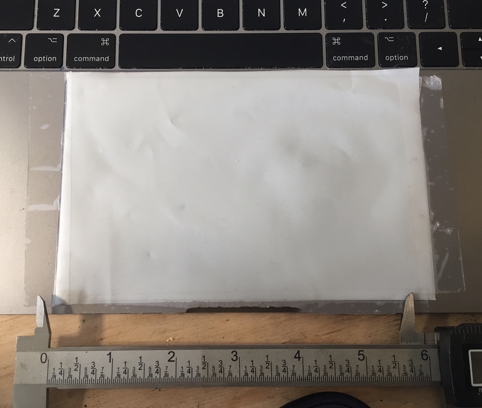

OK, I've got a solution to Random-Cursor-Jumping that's inexpensive and seems to work as well as my best solutions to date, but low friction. Teflon sheet for heat press transfer. I got 3 sheets 16 x 20 for $6.75 on Amazon.
One layer over my 2015 MacBook Pro 15" oversized over sensitive track pad. I just typed for an hour and not one random cursor jump! (Most recently I had 1/16th inch teflon, but it wouldn't lay flat and was expensive.)
It lays flat, attaches with scotch magic tape, thin as a manilla folder. On the less plus side, it's brown, and has a slight texture. But yo! my expensive MacBook Pro now works better than Tim Cook's!
It's also called "Teflon baking sheet " so maybe there's some in a kitchen near by..... someday they'll be in the Apple Store in a little white box for $49.95--or maybe they'll just get around to fixing the problem..... Maybe Jony Ive came back to take the helm of design after a couple of months of using this new elaborately-dysfunctional gadget....

One layer over my 2015 MacBook Pro 15" oversized over sensitive track pad. I just typed for an hour and not one random cursor jump! (Most recently I had 1/16th inch teflon, but it wouldn't lay flat and was expensive.)​
Can you post some pictures of this?

Someone asked that I post a photo of my teflon trackpad cover. Sorry it took so long. It's not pretty. I see it's trashness as a protest. It's not great design if it doesn't work properly. Thickness of the teflon sheet: .25mm or .010" Just held on with Scotch Tape, which I replace every couple of months, so this tape is about two months old.
