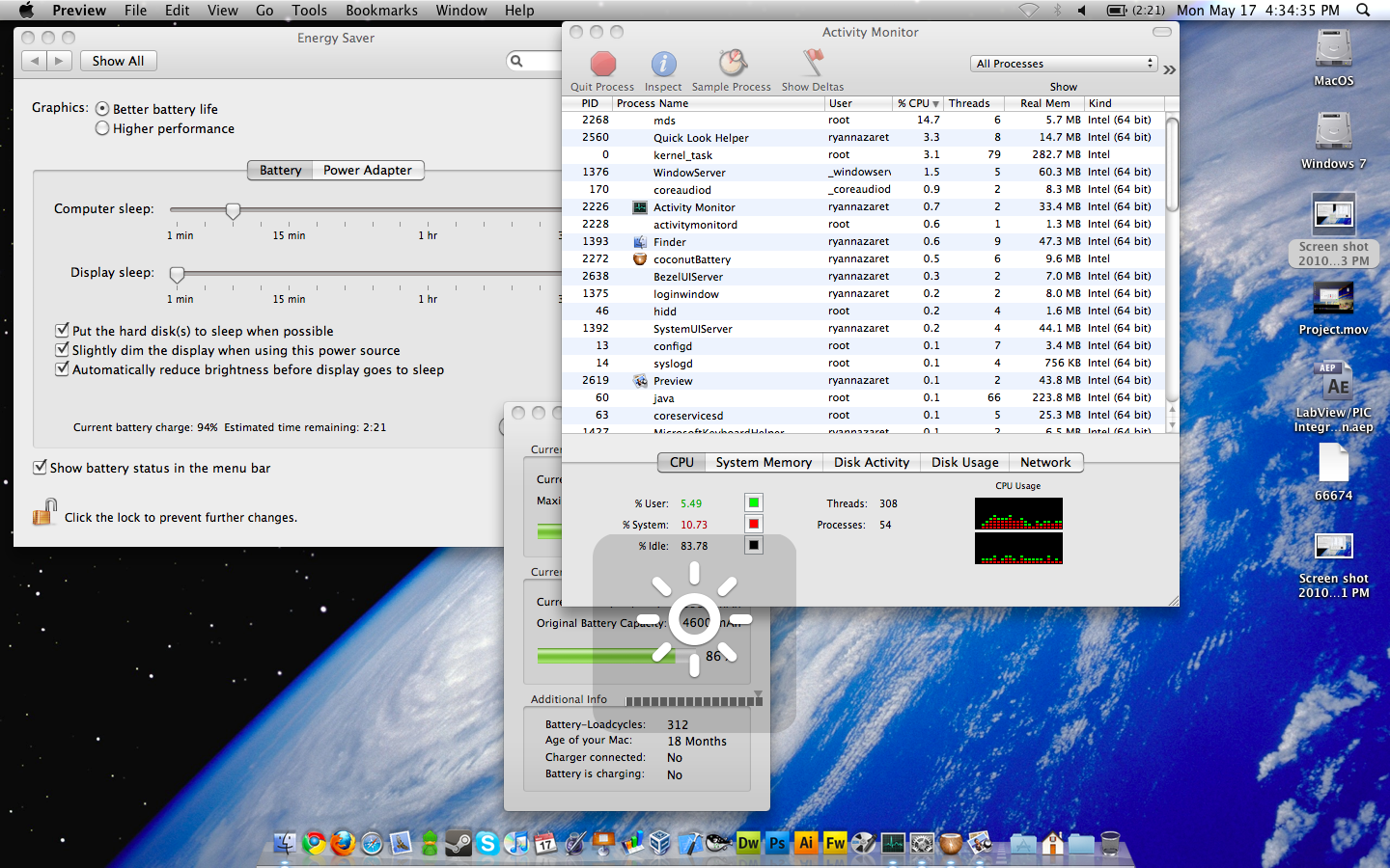

I've never had the correct battery life with Snow Leopard. My MacBook Pro came advertised with 5 hours of wireless productivity. Right now, I can hardly get over 2 hours. Battery health is at 86% with 312 cycles and 18 months old. I've exaggerated the power saving in the screen shot... and still only 2:21 with 95% charge left.
If you have iStat Menus, uninstall it. It's a power leech. I get 1/2 an hour to 1 hour of extra battery life with out it running. Check the Activity Monitor and see what you have running. MDS is the culprit in my case, which is for Spotlight. Even if I disable spotlight, the mds process eats up lots of CPU usage. I can even disable it with terminal... and yea, still does that. I can end the process, and it comes right back.
With 86% battery life, I should theoretically get 4:18 from a complete charge.
