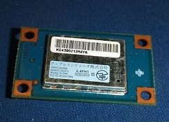

I am wondering if the G5 has Bluetooth on it or not. The description doesn't say. If it doesn't have it, can it be added via an add-on card?

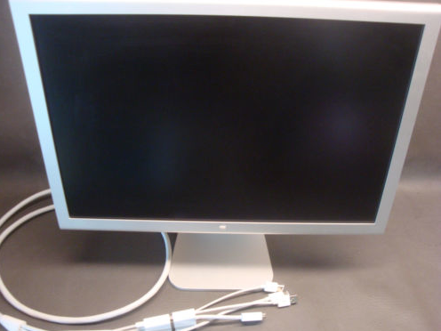

Do you have a power supply for that Cinema Display? They don't work without one, and the description states that it does not come with one.
That was one thing I wasn't sure about. I have power cords, but does it also need an external power pack?

You can easily add Bluetooth to that with a Bluetooth card. The problem will be finding the Bluetooth antenna. For a card, you can use one from an eMac, non-late 2005 PowerMac G5, iMac G4, 2006-2007 Mac Pro, or 2007 iMac. If you get the Intell board (it's blue coloured instead of green), you'll get Bluetooth 2.X. The green PowerPC Mac cards are a bit more expensive and are only Bluetooth 1.X.
Cool, thanks! I'll look around for the blue 2.x ones I think.
Yes, it uses it's own proprietary power brick. For the 20" Cinema Display, you'd need the 65W adapter; they're available on ebay for something like $40 last I checked.

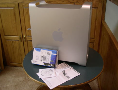

I placed a bid on and won an Apple PowerMac G5, Dual 1.8 GHz/4GB/OS X10.5.8, 2 HD-75 GB/1TB, Radeon 9800 Pro on eBay today.
I also bought a used 20" Apple Cinema Display to go with it.
This will be my new project/hobby computer to work on or just use. From the description, there probably isn't much it really needs. But maybe I'll look into doing something with SSD's if I can.
It was fun rebuilding the iMac G5 and now I have a new PPC Mac to use! I'm excited for this one too.

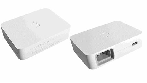

I ordered a Genuine Apple Power Adapter 90W for Apple 23" Cinema Display (A1097) (661-4379) which, according to Apple, will be compatible with the 20" display I bought yesterday.

The cinema display just arrived! The shipper was actually within my state and not too far away so it arrived quickly.
However it was the most poorly packed parcel I've ever come across! But it did the job and it arrived undamaged so that's what counts!
Now I have to await the arrival of the computer and the display's power adapter.
While talking about different Airport+BT cards, I found a nice overview lately. It is unfortunately an ebay auction (not mine), but may help some people in distinguishing these cards,also names the compatible models:
http://www.ebay.de/itm/Apple-AirPor...ng_Interne_Netzwerkkarten&hash=item257e09fecc
Though I still think a USB BT dongle will be cheaper.

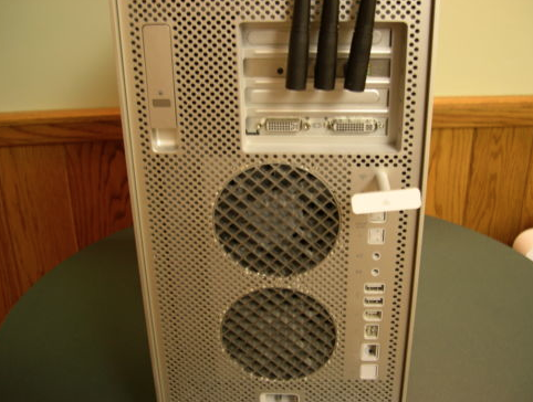

The G5 just arrived via FedEx. It was very well packed with form-fitting foam and bubble wrap and in a strong and sturdy box.
Though it's made of aluminum, I'm surprised at how heavy it is.

I also ordered a Bluetooth card for it after confirming that it doesn't have one already.

I'm posting this message from the G5. Everything seems to be working just fine; the G5, the cinema display and its' power brick.
I must say though, this is probably the heaviest computer I've ever lifted! What did Apple do, put lead in the bottom of this thing? I had to schlep it up the ladder-well to the third deck of my apartment building where I live. It was about as bad as when I moved in and moved all the furniture!
Anyway, I'm going to break out the Leopard disc and do a clean install on it now.
