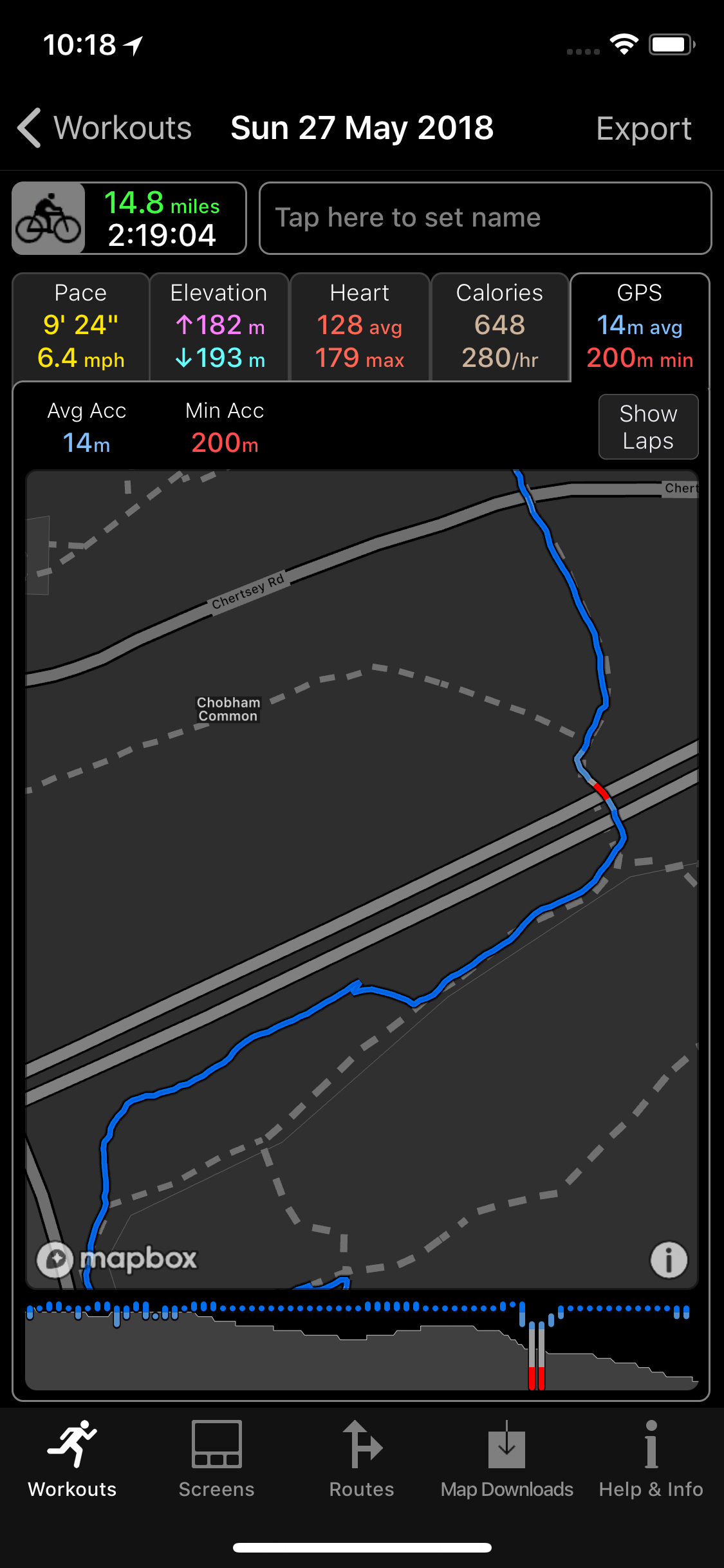

Used it for the first time today. What do the red and green lines along the route on the map? Is this the gps signal strength?
Is there any way for it to announce your average speed along the route every mile or set distance? Other apps let you do this but there doesn’t seem be an option for this.
Is this when there is a black map in the background such as on the Info screen map on the watch, or the analysis map on the iPhone app? In both cases the colours denote speed: red for slow, yellow for average and green for fast. If you change to show a different metric then the colours change accordingly. For instance elevation shows various shades of purple from pink (steep uphill) to blue (steep downhill).
If you want to see the GPS strength at each point then go to the steps tab on the iPhone and select "GPS". This will show the route in blue where there was a good signal, grey where it was average and red where it was poor.

Can anyone get 5 blue bars GPS strength with just the watch, no iPhone? Max I can get is 3 bars with just the watch alone. If I have my iPhone it jumps straight to 5 blue bars.
It does sound like your watch GPS is struggling. Is this outside? I find that it can have trouble getting GPS inside a car or train, but it is usually fine when outside.
You say in another post that it happens with every app, so it does sound like a watchOS or hardware issue. Have you tried rebooting both devices and, if that doesn't work, then unpairing and re-pairing the watch with the phone?

Yes, the watch often gets 5 bars, and should get them in an open area. The app can give you a lot more information if you need it. For example there is an option in the Map settings on the watch to show the accuracy in metres instead of bars.
Also for a workout you can export a GPX file that includes the accuracy in metres for every position on the route (if you switch that field on in the iPhone settings).
You can also display a graph of the signal strength along the route. Here is an example where you can see the colour change from blue to grey to red (the colours of the bars) as I went through a tunnel under the main road. You can also see the GPS accuracy in metres at any point by tapping the profile below the map.
It sounds like there is an issue but hopefully these diagnostics may help you to get more information about it.
