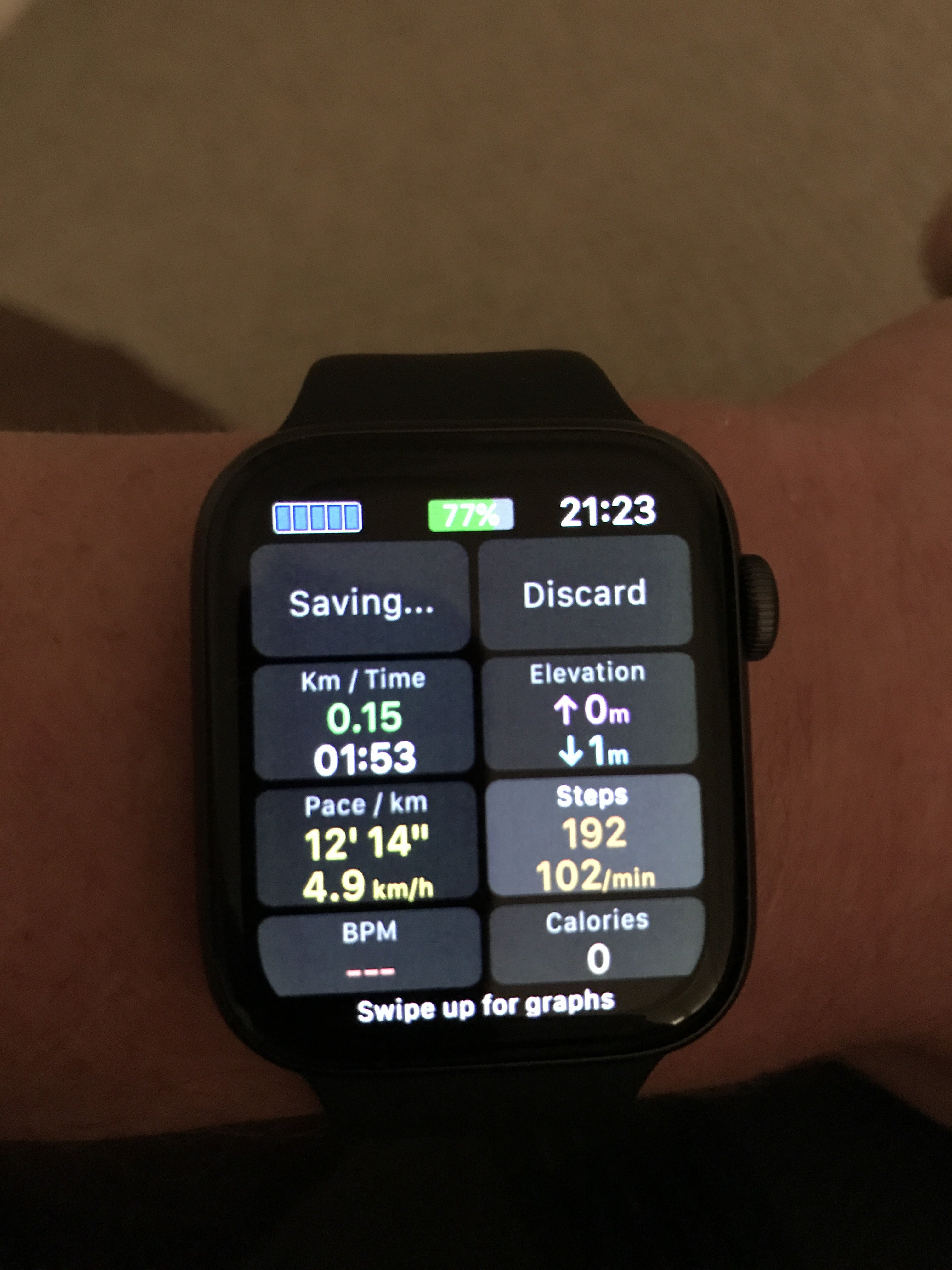

I linked the app on the phone to Strava (authorization) but the upload isn’t direct. Have to go in the workout list and export.
My BPM is not picking up since the new update. Although the green led’s are on under the watch.
The bpm works with other apps.
And I’m stuck on the “saving” screen at the end of the run. Although I can find the run in the workout list.
May be I’m doing something wrong
Oli.
Previously uploading to Strava required exporting as a GPX file and then going to the Strava website and uploading that file, or by using a third party app to export from the Health system. With the latest version you can now export directly to Strava from the app. Do you want every workout to be automatically uploaded so that you do not need to press the export button? I will implement this in the future but I wanted to make sure it worked first before doing it automatically.
The lack of a BPM sounds like a permissioning issue. Please check the Settings app on the iPhone and go to Privacy and then Health, and check that all the switches are on for WorkOutDoors. If they are on then it could be an issue with the watch app installation so please try uninstalling the watch app (not the iPhone app), rebooting both devices, and then reinstalling the app.
How long did you wait for the "Saving" message to change to read Done? It can take several seconds to save longer workouts on older watches.

BPM issues.
Yep, it was on me. Played with settings and actually removed persmissons by mistake. Put them back on and it worked.
Saving screen.
I have series 4, it was instant up until now.
The issue I mentioned is now gone. I removed and re-installed the app (on the watch only) and it is all ok now.
It would stay on the saving screen indefinitely. I would kill the app (press side button on the watch and slide the app to the left to shut it down), and restart the app, and it was still on that screen.
This issue is gone.
Thanks again for your quick and efficient support. Sorry for lack of knowledge... Apple Watch is new in my tech world 🙂

Glad to hear that everything is working now. The Saving issue is a bit worrying. Previously the save happened in the background but I found that AW2 and earlier users were having problems with watchOS 5 locking the app whilst it saved the workout, which was confusing. To get round this I now show the Saving message on the button until it has finished saving, so that it is clear what is happening.
Hearing your problem makes me worry that for some reason watchOS failed to tell the app that it had finished saving, so I may need to adapt the logic to cater for that. Thanks for letting me know.
I think the "saving" screen issue was just a glitch resulting of my own mismanipulation with the phone and watch.
I have used the watch and app a few times now and everything is instantaneous.

The watch shows quite a lot of stats at the end of a workout, including distance, time and calories, as well as maps, profiles and splits for most metrics. Sorry that the app doesn't show VO2 Max at the moment. I had a look into it and Apple only provide the figure when the user really pushes themselves to extremes. This is understandable but it does mean that the field would be blank for most people for most workouts, which I thought may be confusing. I may revisit it at some time though. I plan to look into recovery metrics at some time as well.
You are the first person to even mention the inverted text on long press feature, so it's good to hear the someone is using it! The idea was that it was a temporary state to allow you to focus on a particular metric, but I may make it remember the settings between workouts in a future version.
