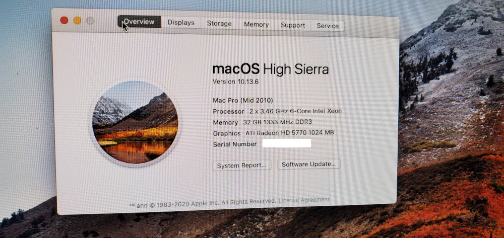

I'm new here. I just got a Mac Pro 5,1.
I really like the specs on it.
However I can't update it any further than High Sierra.
Any suggestions? Tips?

Mojave is probably the best OS version for a 5,1 Mac Pro. Requires a metal capable GPU. Disk drive performance takes a hit under APFS if you still have mechanical hard drives. High Sierra is the best version for mechanical hard drives because you are not forced to use APFS.
Technically you can run later OS versions (with tinkering) but it comes with its own downsides.
What are you using the machine for? Running dual boot with Windows? Legacy software (32-bit)?
