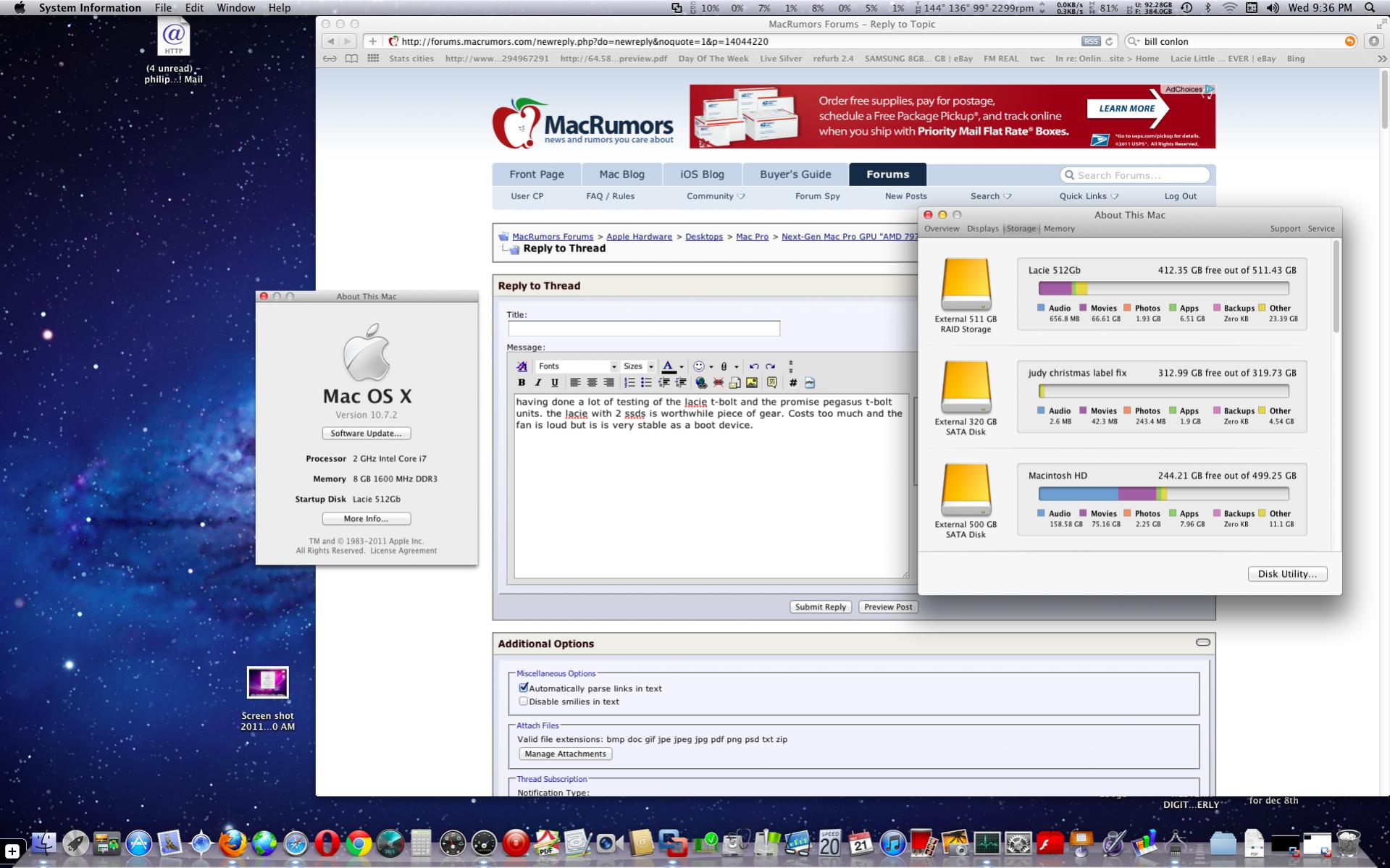

having done a lot of testing of the lacie t-bolt and the promise pegasus t-bolt units. the lacie with 2 ssds is worthwhile piece of gear. Costs too much and the fan is loud but it is very stable as a boot device.
I also built a fw800 to dc cable that allow it to be powered as a portable device. It also runs without the fan if you use samsung 256gb series 470 ssds. Based on my testing a pair of t-bolt plugs on a new mac pro would be a decent addition.
the lacie device needs a few mods and lower price to be really good but it has great promise as a really fast boot device that can be moved from machine to machine with ease.
Not to knock the promise pegasus as it is a better device then the lacie in many ways.
For mac pro users it is not needed. sans digital has plenty of lower cost raid solutions along with a few other 8 bay raid providers.
