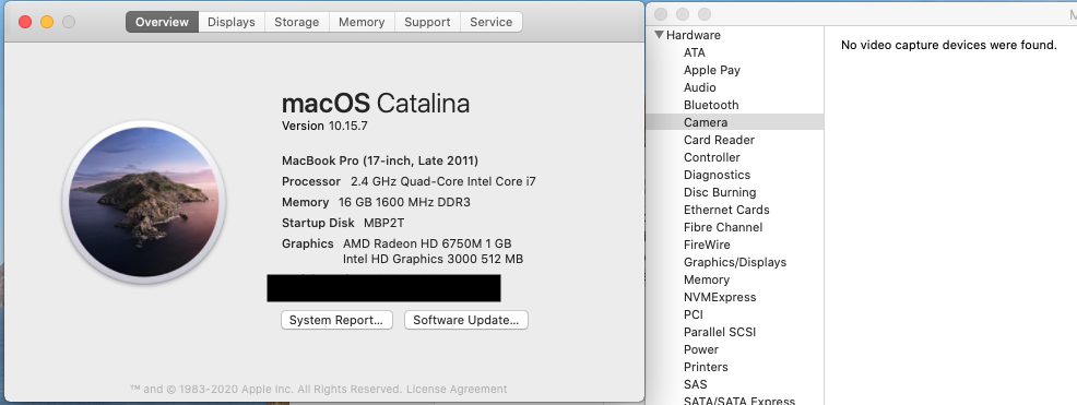

Same here on an 2011 MBP 17" -- confirmed that the camera only works in a safe boot.

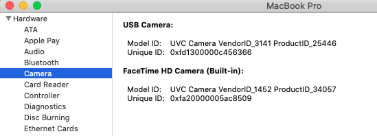

ok, a bit more digging and this smells like a permissions issue. This is what happens when I plug in a USB cam:
Built-in!?!?!?!?!
But, when I go into Photo Booth I still get "There is no connected camera." 😪

I’ve seen this happen a number of times when loading Catalina on 2011 15” but usually if not always was on 2011 15” that still had the dedicated gpu running. Once that’s disabled and reloaded, issues with camera or dvd not working were resolved. 2010 15” dvd never works with Catalina patch that I’ve seen.
