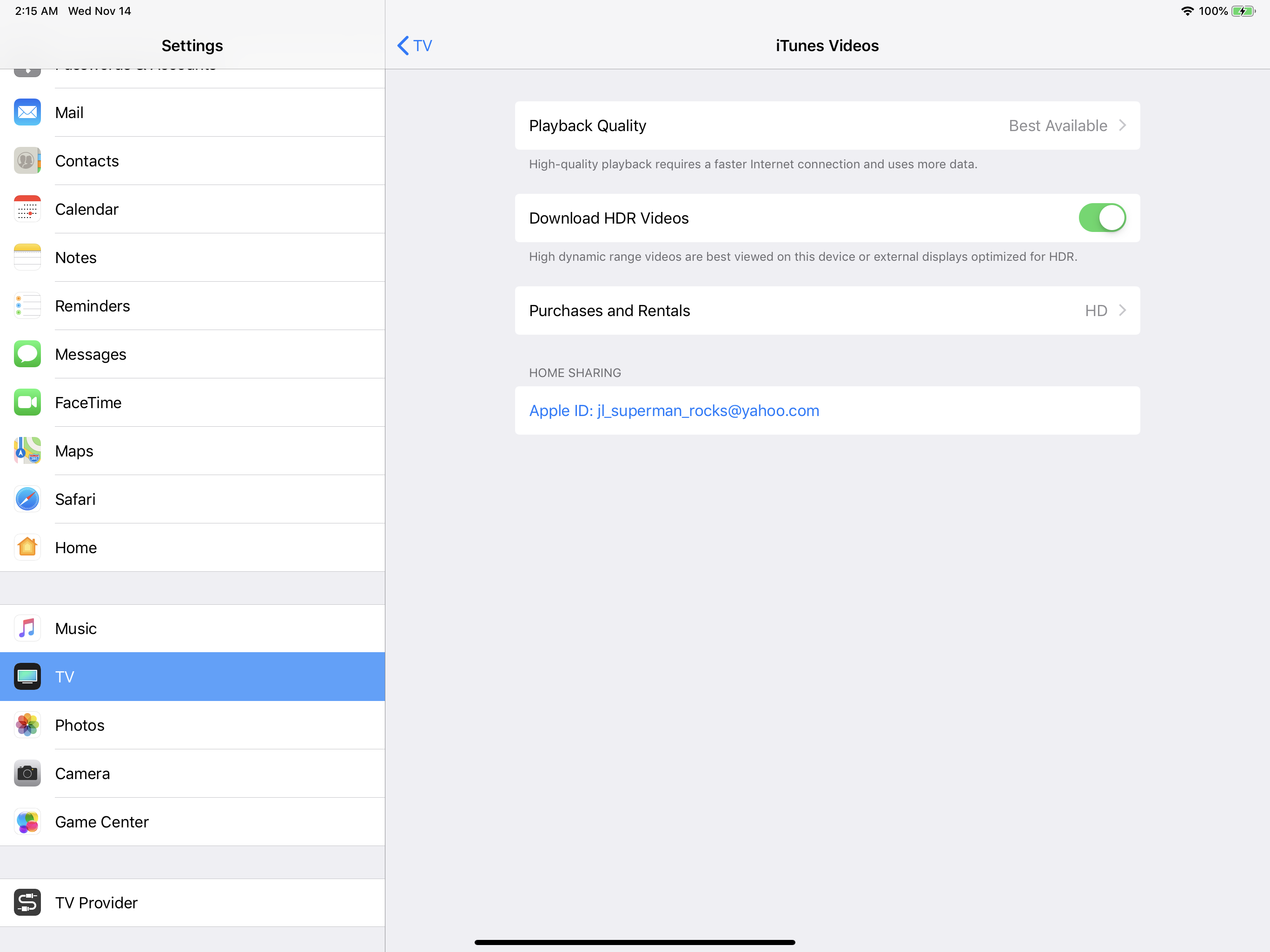

Maybe this is why they aren’t specifically mentioning HDR on the website anymore. On my 2017 iPad Pro there is a toggle in iTunes Video Settings to ‘Download HDR Video’ so I wonder if this option will remain on the 2018s. These HDR videos do utilize the wide color gamut of the iPad screens but it’s interesting that they don’t technically meet the brightness or contrast specs of HDR10.

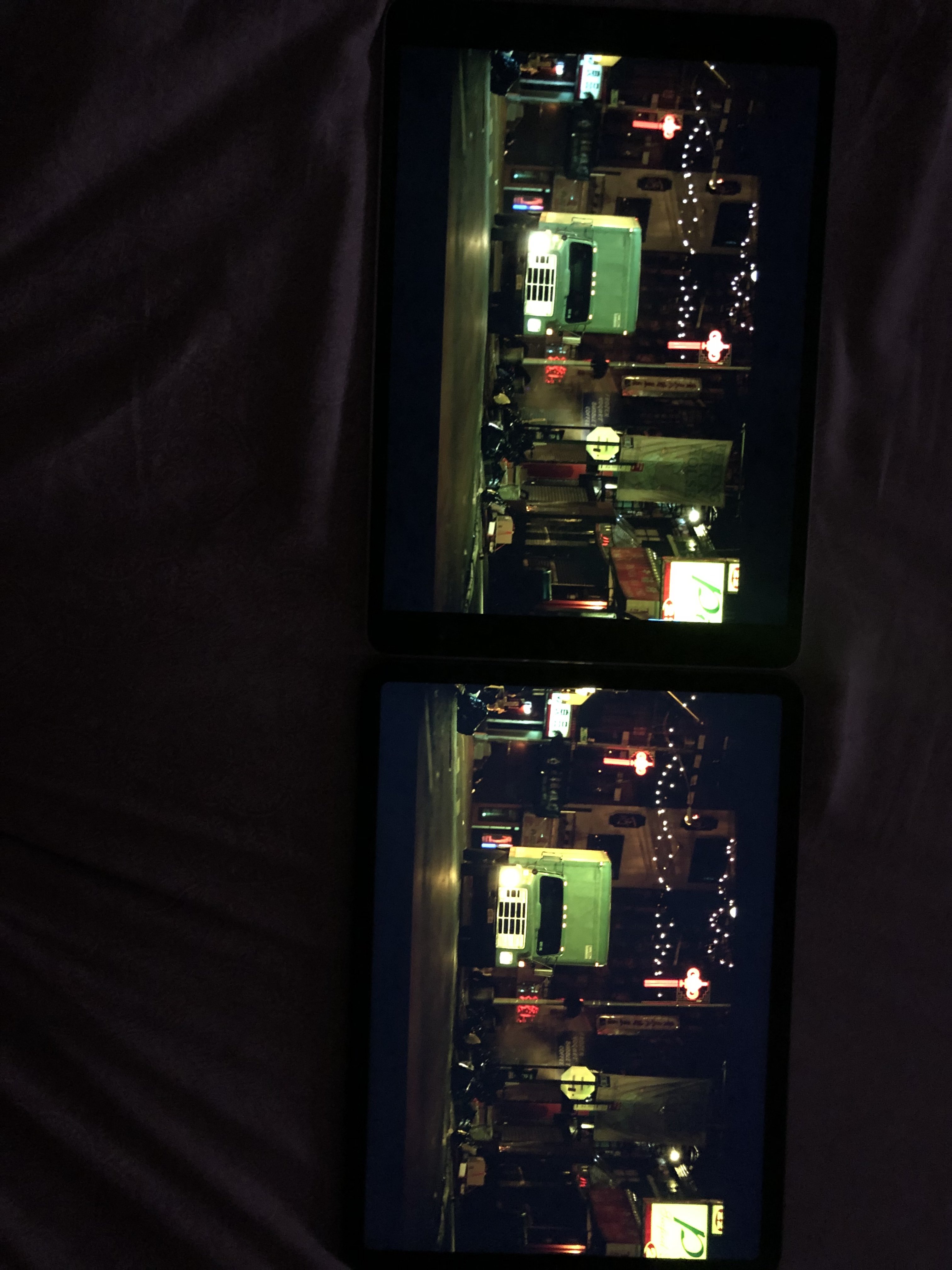

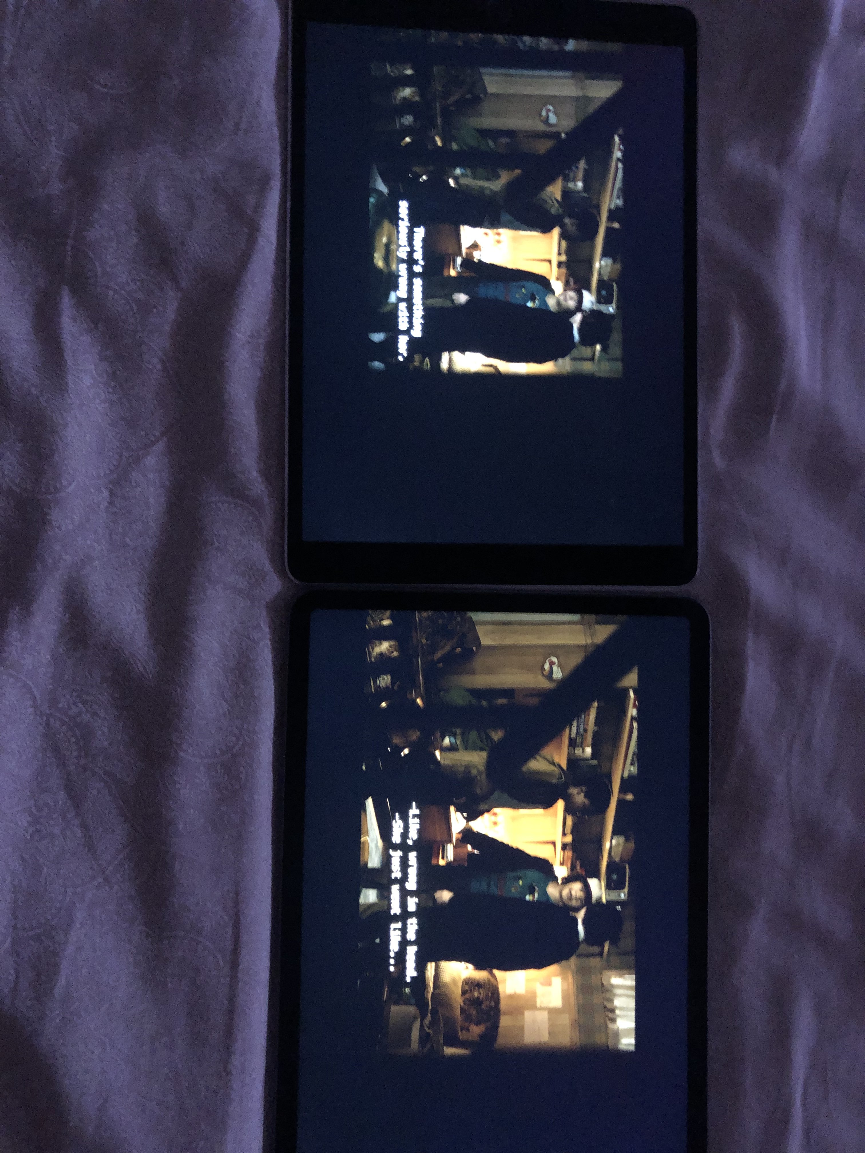

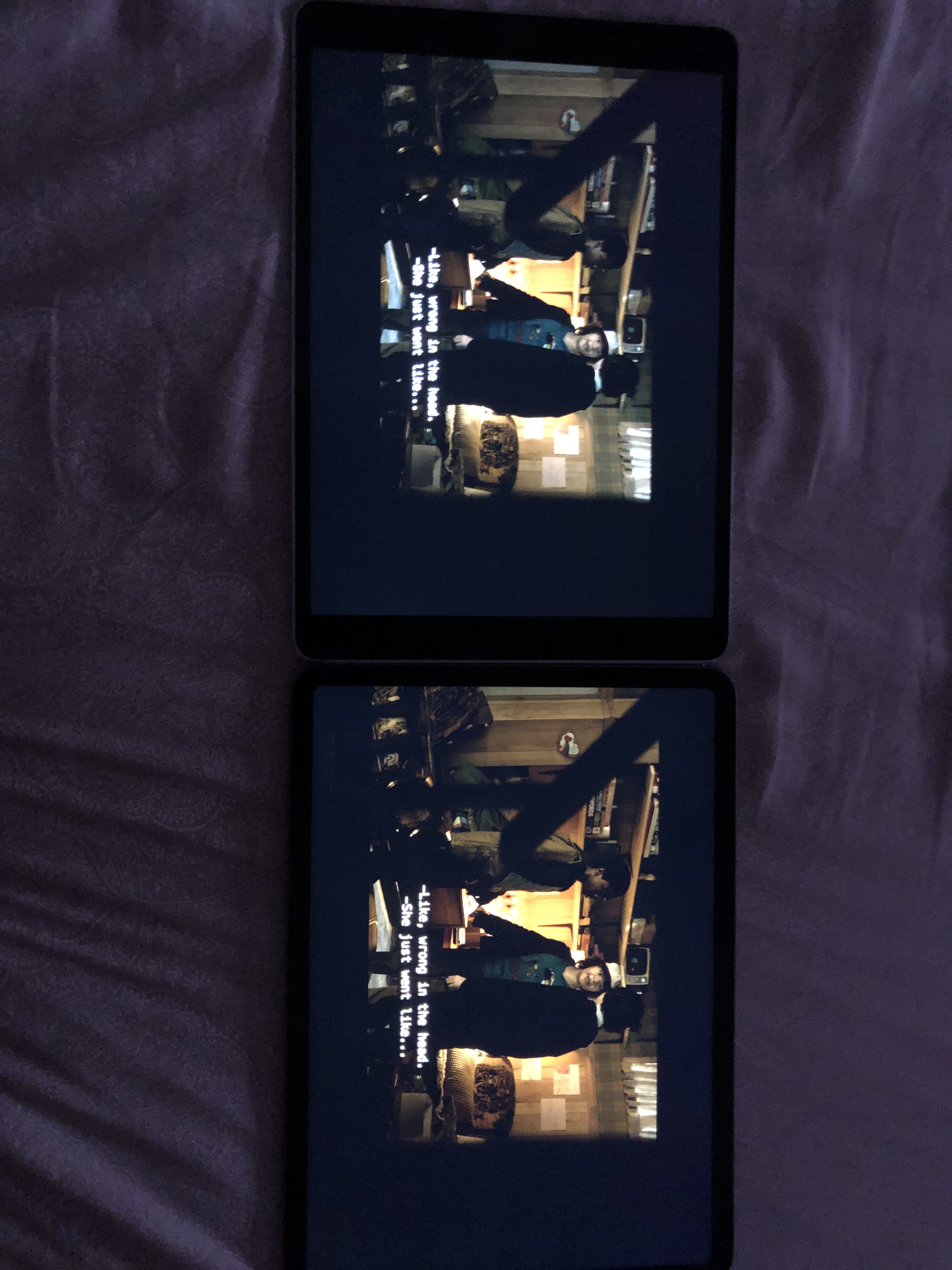

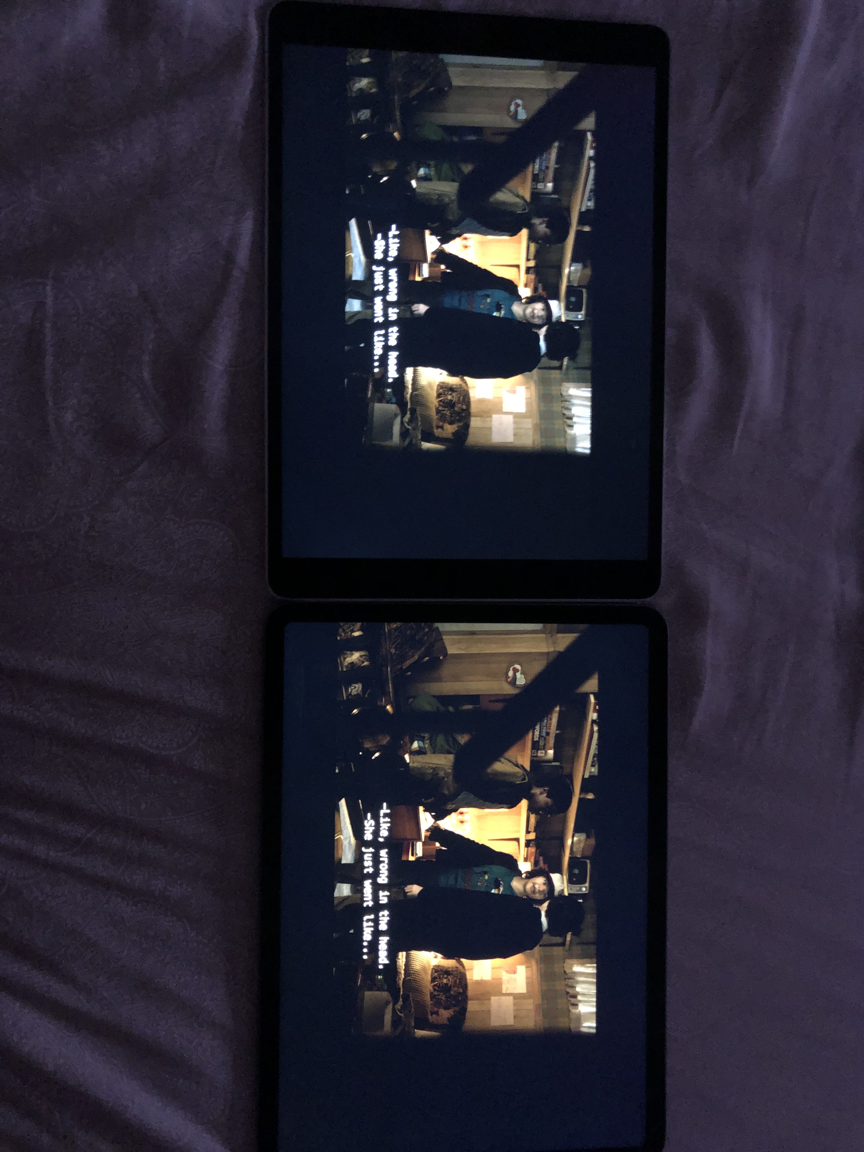

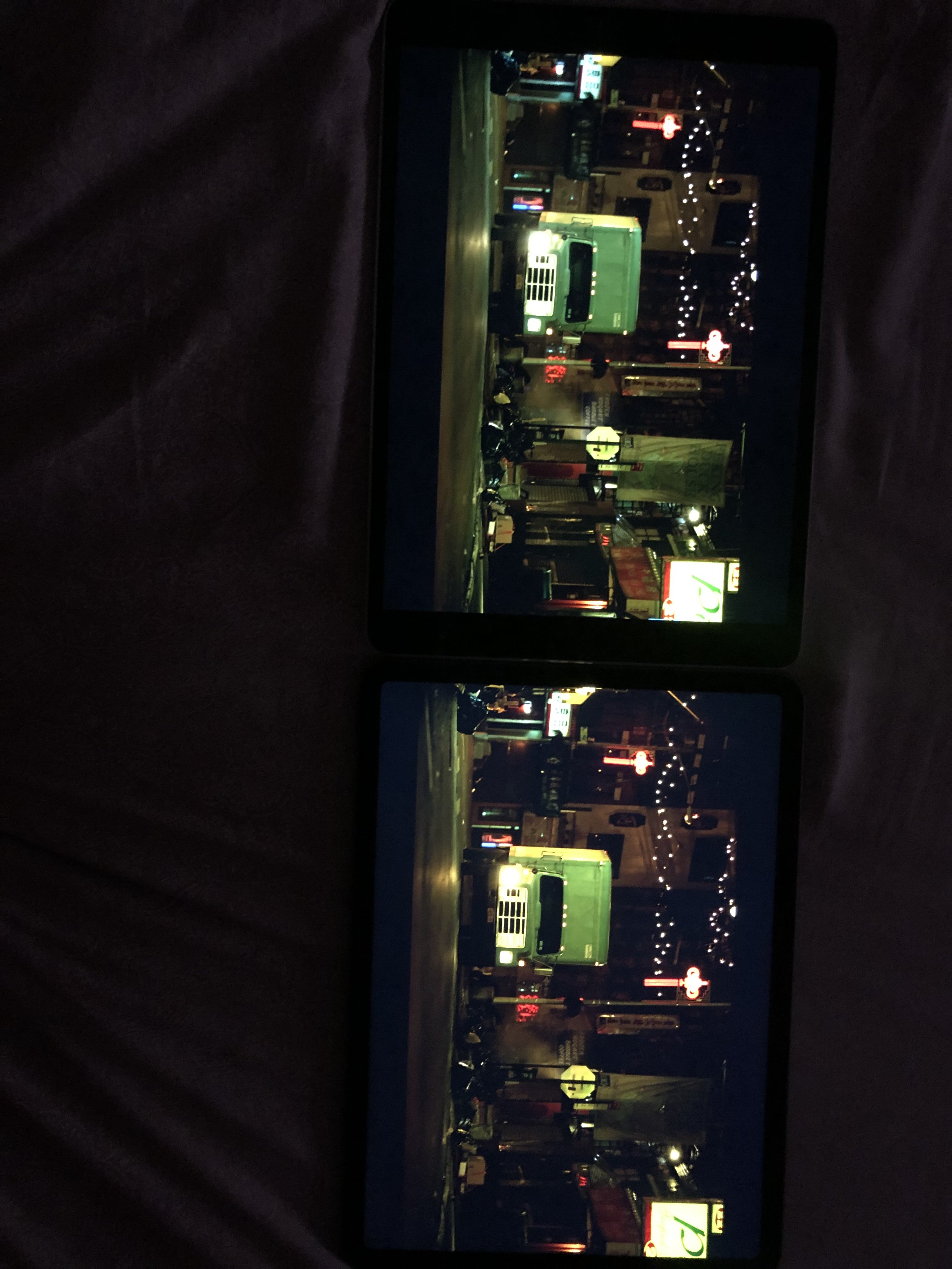

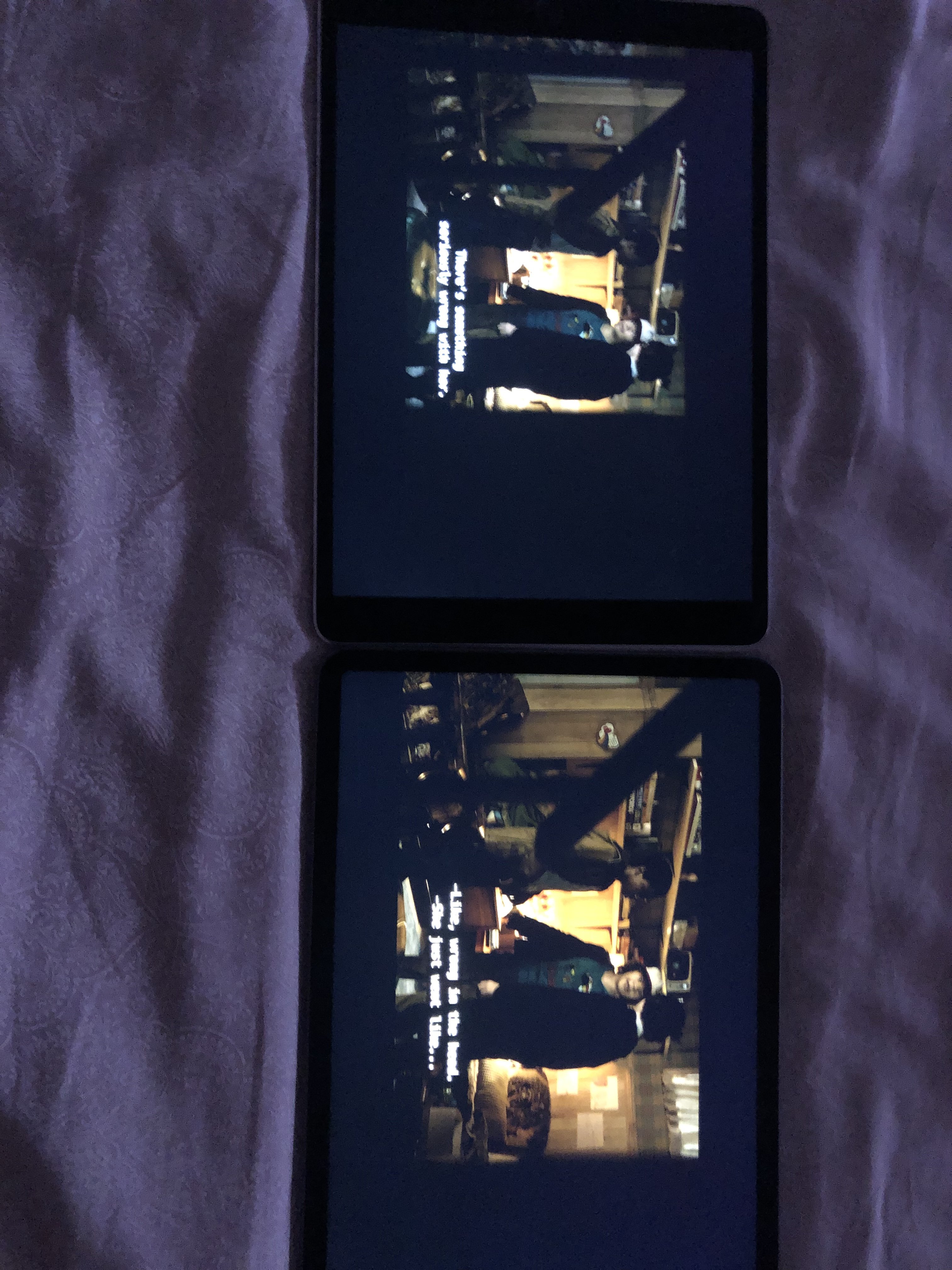

I don’t know if the iPad 10.5 plays true hdr, but definitely the iPad Pro 11 the hdr is better than the 10.5. I made a comparison, left is the 10.5. I don’t know if the pictures are good to justify, but with the naked eye even my wife that doesn’t understand technology she is preferring the colors of the iPad Pro 11.
