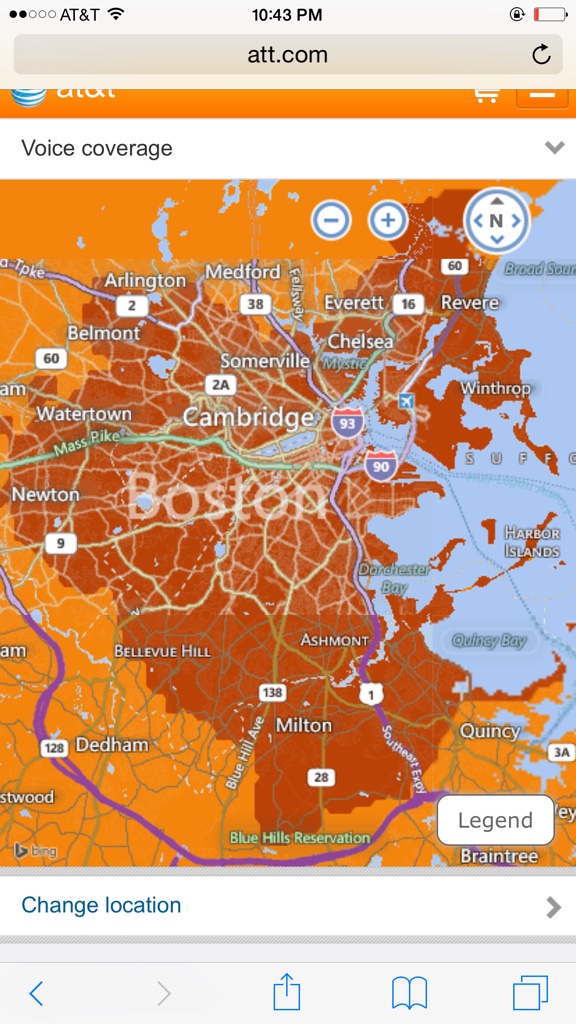

    Yesterday At&t updated their map and there is VoLTE in Boston city area, VoLTE covers mainly city for now, but this is the first step and I appreciate it.

    Haha. TMobile service in Boston is pretty absymal
    Here's the coverage map. Are you in range? Works great in Brookline
