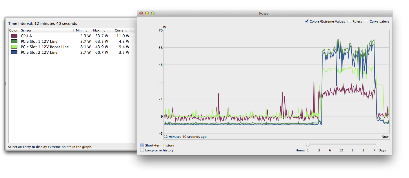

You can measure the power being drawn through the 4 PCI slots and the 2 PCI leads using Hardware Monitor. There's a free version but I think it only does temperatures, unfortunately.
One thing to be aware of. While slots 3 and 4 are labeled correctly as "line", the labels for the slots 1 and 2 are "boost line" and the leads 1 and 2 are "line". I suspect they've been mis-labeled. I contacted the developer about this but the labels are based on Apple's tech docs and so we have to live with it.
I've attached a history window configured to show a breakdown of power draw on my system. I only have the one PCIe card, so I haven't enabled any of the unused sensors. The high power section was the Valley benchmark on the extreme preset. You can see that the card is drawing around 170W, with around 40 - 45W being provided by the slot itself and 60 - 65W coming from each 6-pin lead.

So either the PSU is dying, or there's not enough power going to the PCIE slot?

The GTX 680 has a TDP of 195W, and the Radeon 5870's TDP is 188W. If your MP has a power problem that could fry the GTX 680, then the 5870 could also be in danger if you push it too hard.
You probably summarized the possible causes. Here's a picture of the MP's PSU label, there are 6 +12V rails. One of them that supplies graphics power could be failing or the power traces on the motherboard could be damaged. It's time to let the professionals check it out before doing more damages.

That's why I suggested measuring the power draw using Hardware Monitor. It would help to see where the power is being drawn from. It would probably not be a good idea to load the card until it's confirmed that the slot and both boost lines are fully functional, though.

So when I'll be running the monitor, what should I pay attention to in power settings?
Once you've installed the application, there's a comprehensive user guide under the Help menu > Hardware Monitor Help.
You should pay particular attention to the "Displaying history data" section.
So what is what? PCIe Slot 1 12V Boost Line - is that the 6 pin connector? and PCIe Slot 1 12 Line pcie slot isleft? which one is the second cable..
sorry, kinda confused about this....i dont know that much about computers
That's how they should be labeled but they're not. Well, on my Mac Pro 4,1 that's been flashed to 5,1 they are like this:
"PCIe Slot 1 12V Boost Line" refers to PCIe slot 1
"PCIe Slot 1 12V Line" refers to 6-pin connector 1
"PCIe Slot 2 12V Boost Line" refers to PCIe slot 2
"PCIe Slot 2 12V Line" refers to 6-pin connector 2
