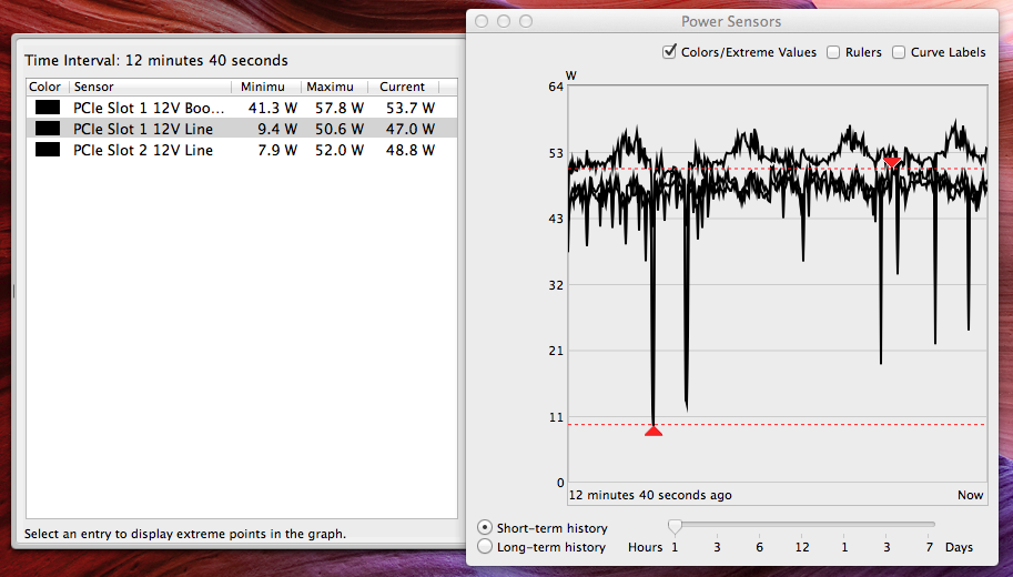

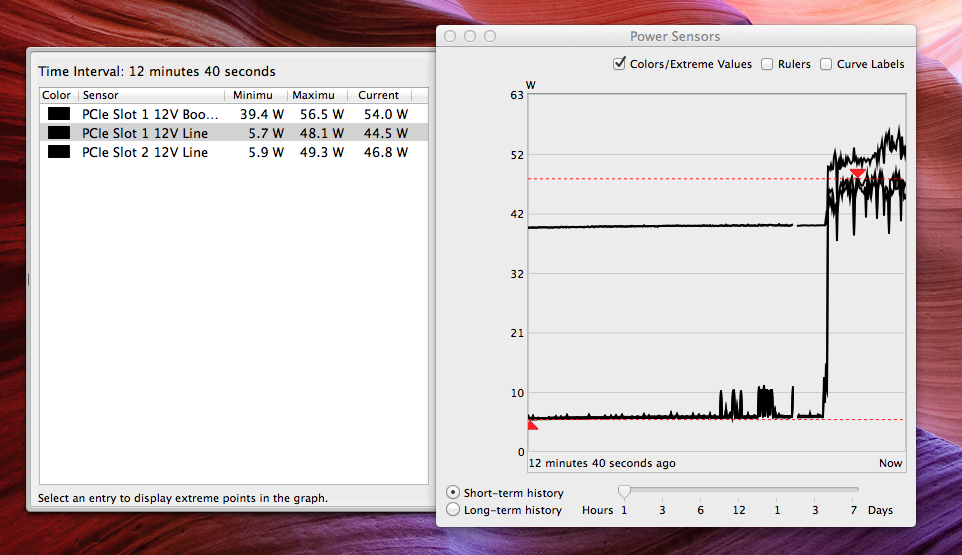

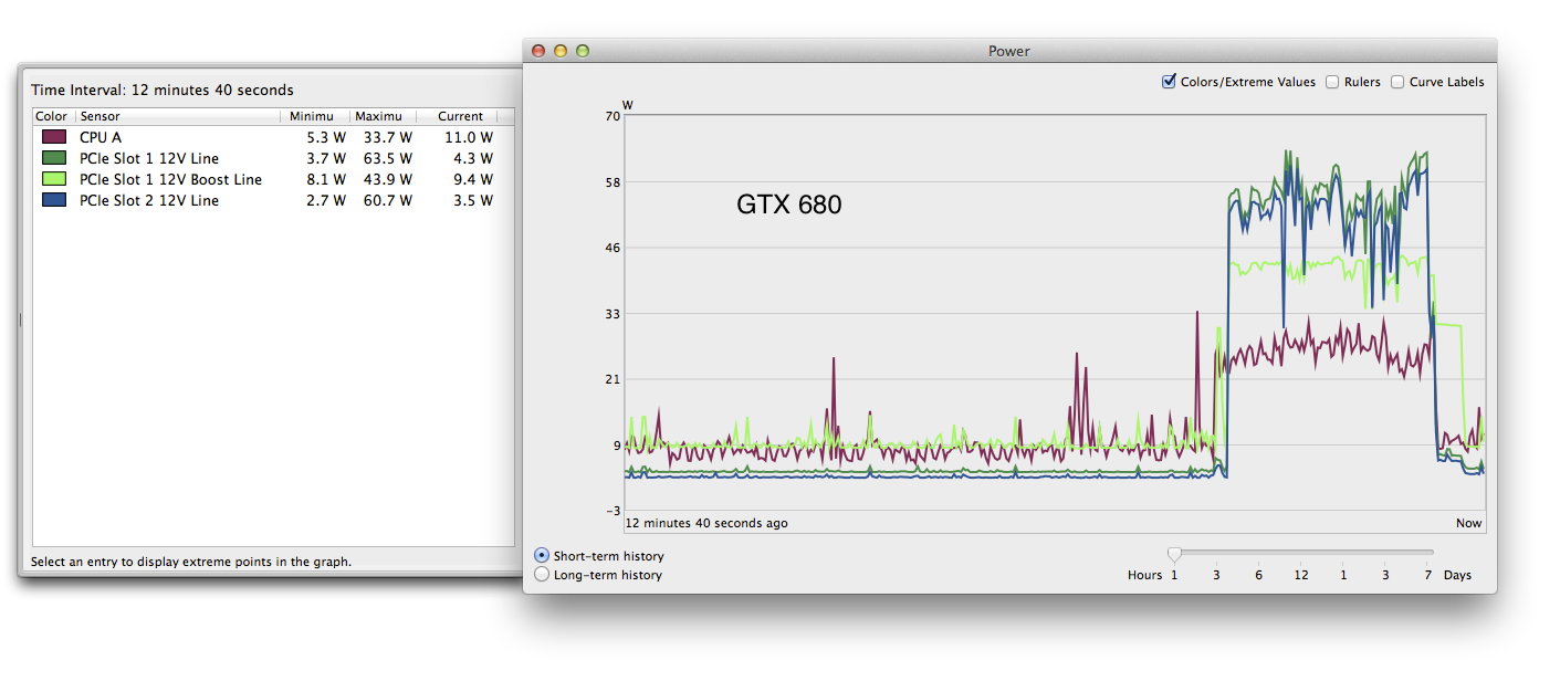

Max draw from the PCIe slot was at 57.8W and 50.6W + 50.6W from 6-pin aux lines. And thanks a lot! That's something that wouldn't even cross my mind to look at.
Again, thanks🙂 I feel much better now - I can actually tell the apple techs something logical 🙂

The weird thing is that the min ouput from your PCIe slot is 39.4W, that is way too high compared to cal6n's 8.1W.
*snip*.
That may just be how ATI cards idle. I'll pop my 5870 back in later this evening and see that mine behaves in my Mac Pro.
Incidentally, what settings did you run in Valley, kunia? Was it the extreme preset with AA off? It's just that the benchmark's bugged with AA on with ATI cards.

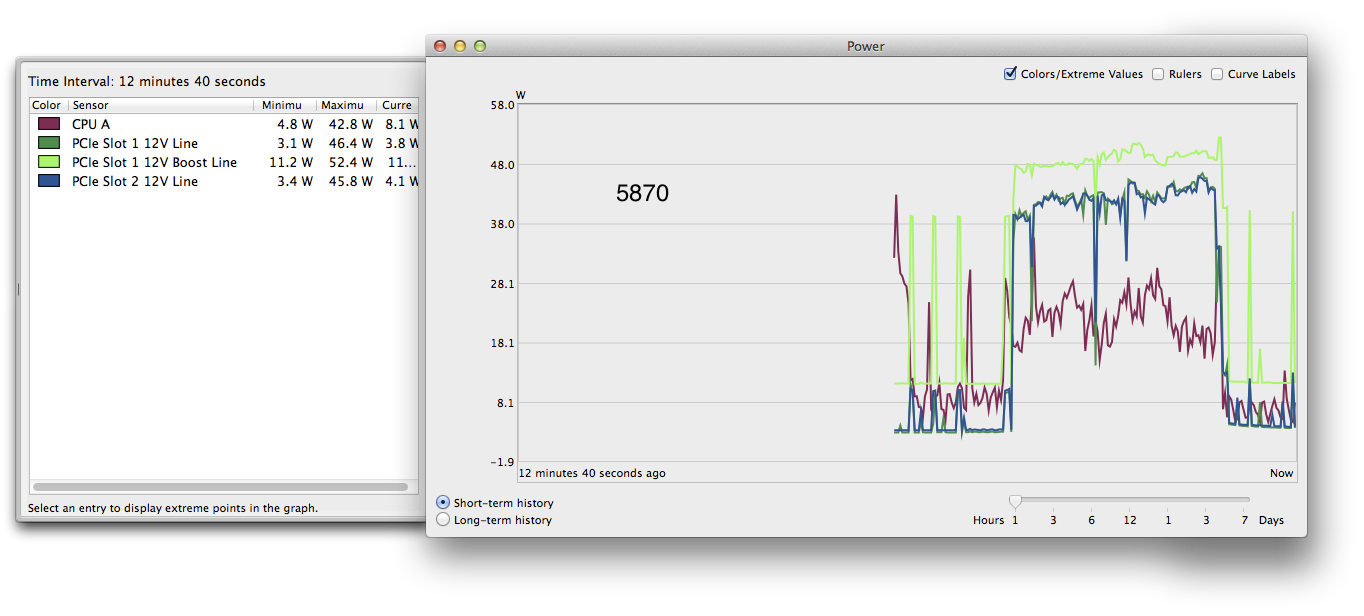

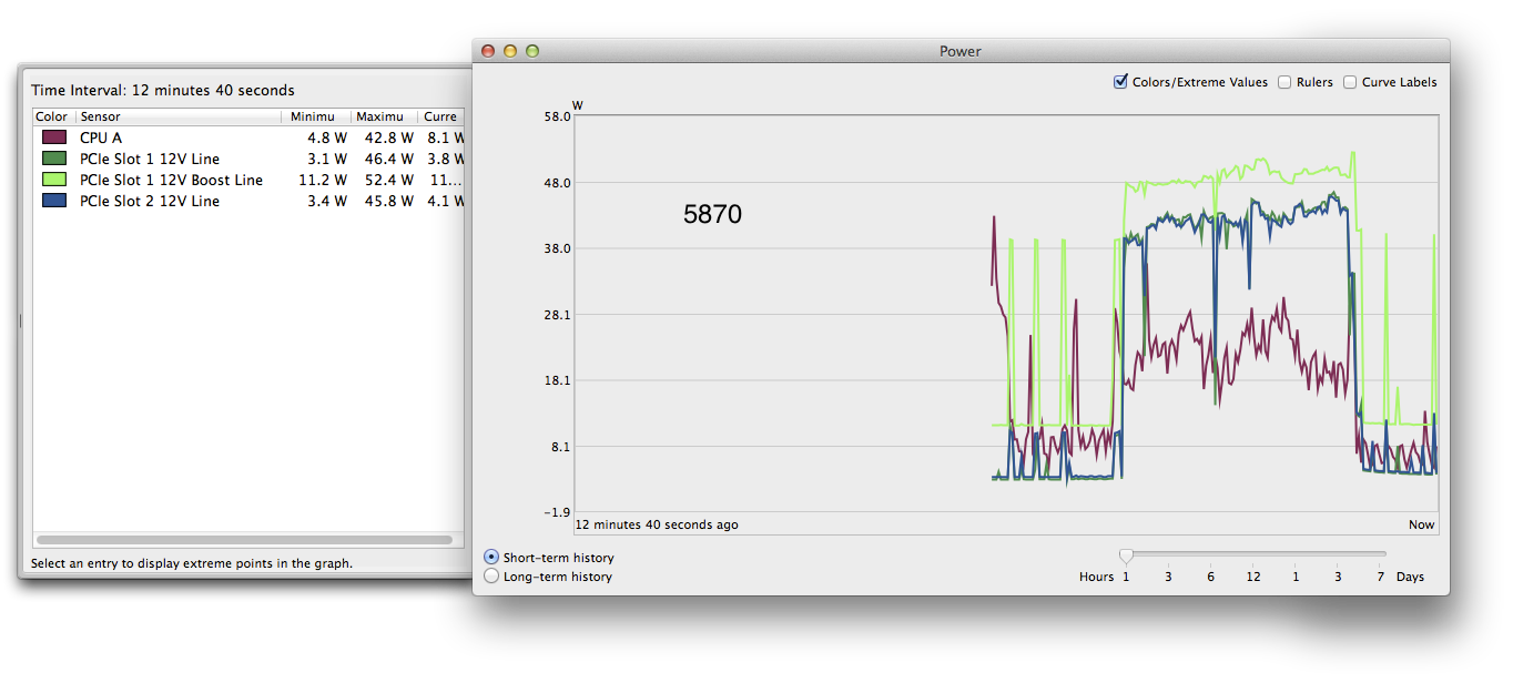

Here's the 5870's power window.

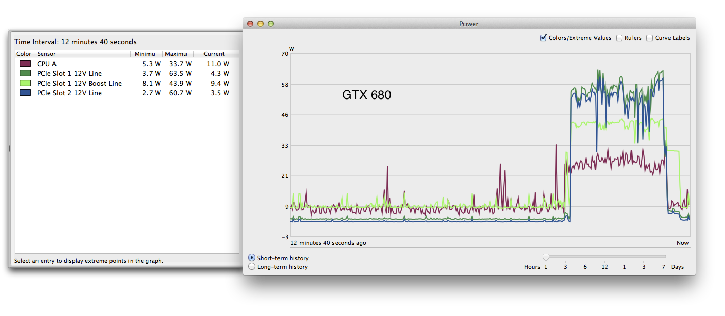

The boost lines are providing less power than the slot, unlike the GTX 680. However, my 5870 idling behaviour is different from yours but similar to what I see with the GTX 680.
I don't understand why your 5870 is drawing 40W at idle through the slot, but I'd say it's worth taking it to Apple.
