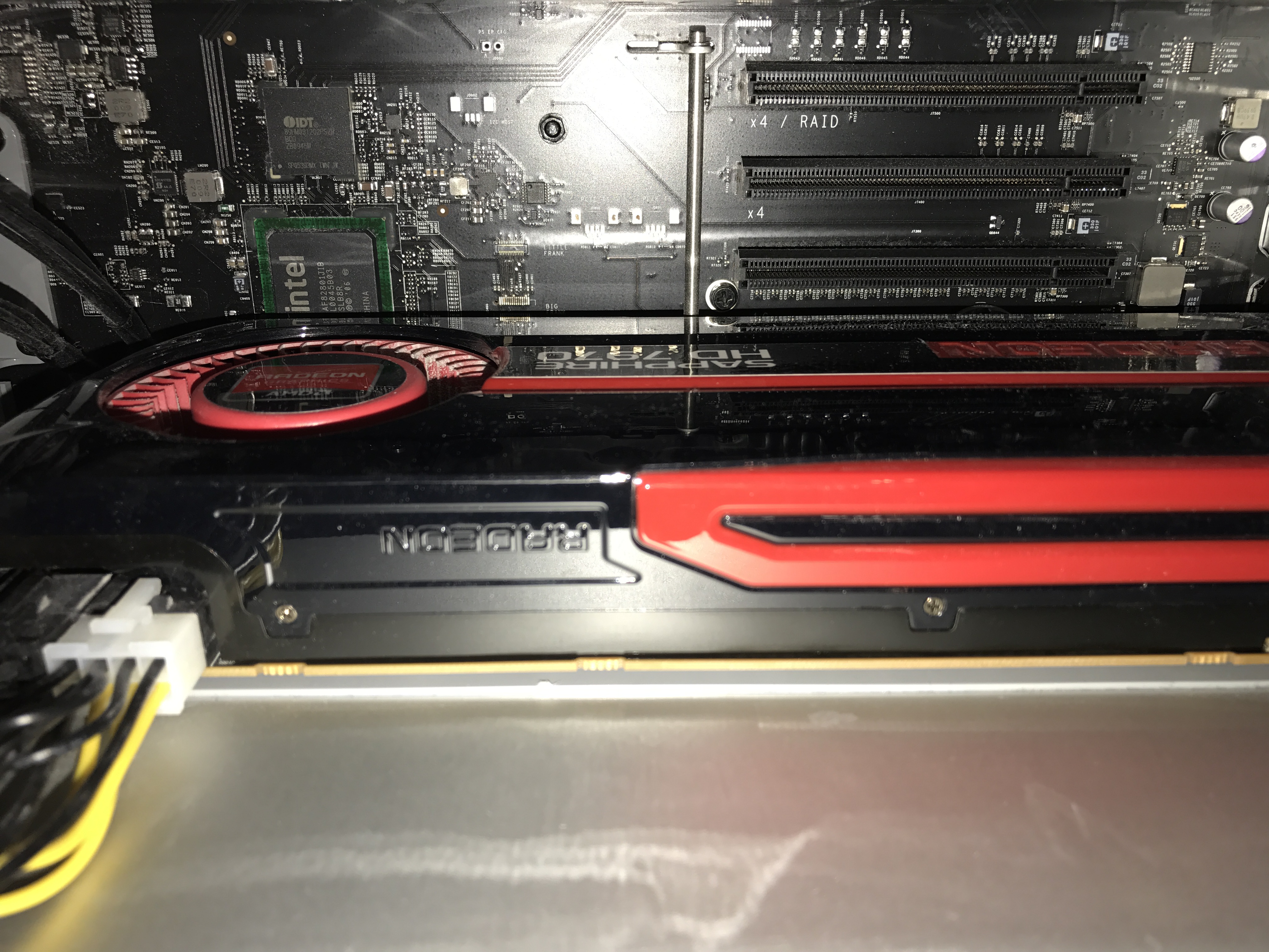

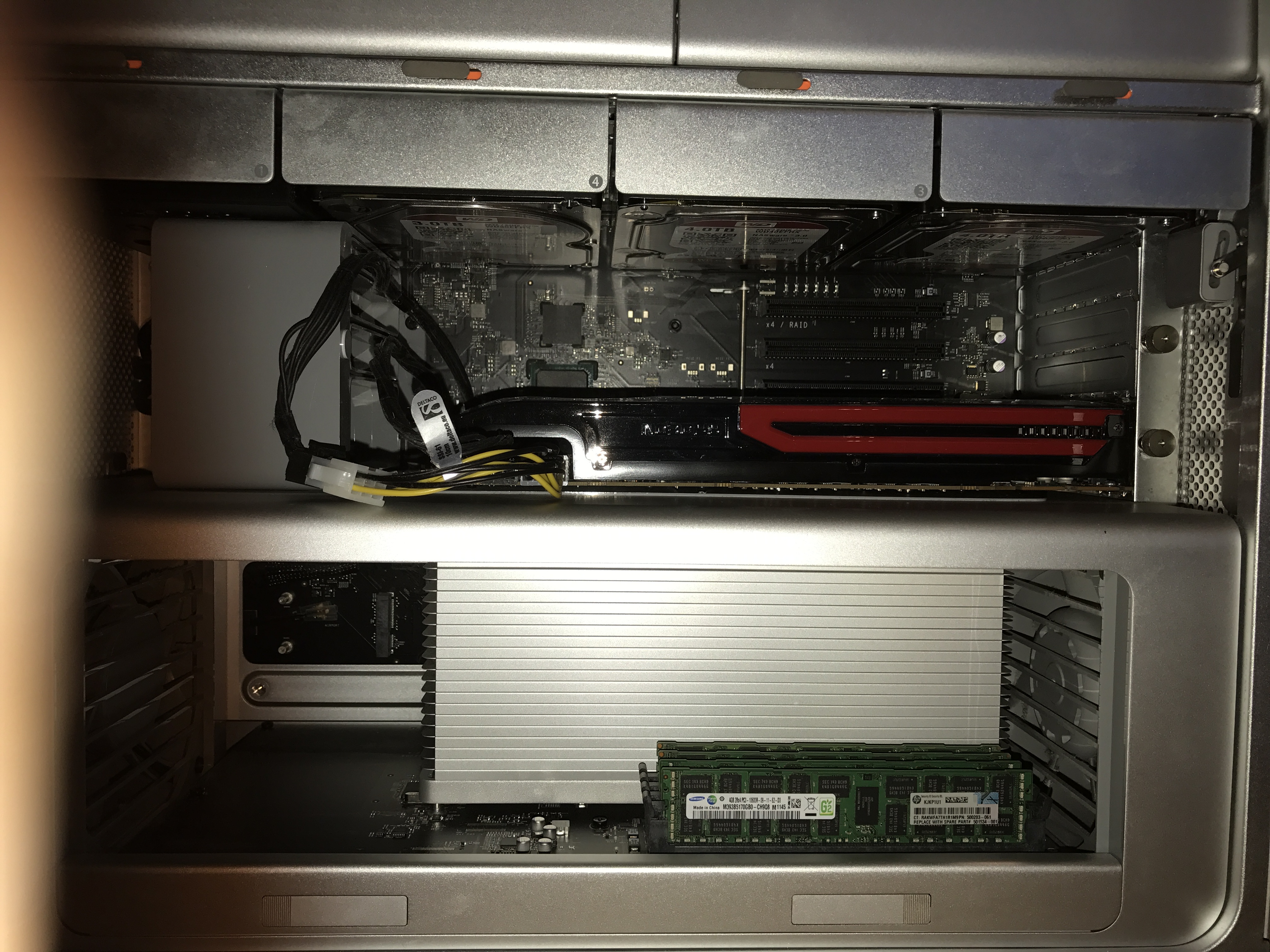

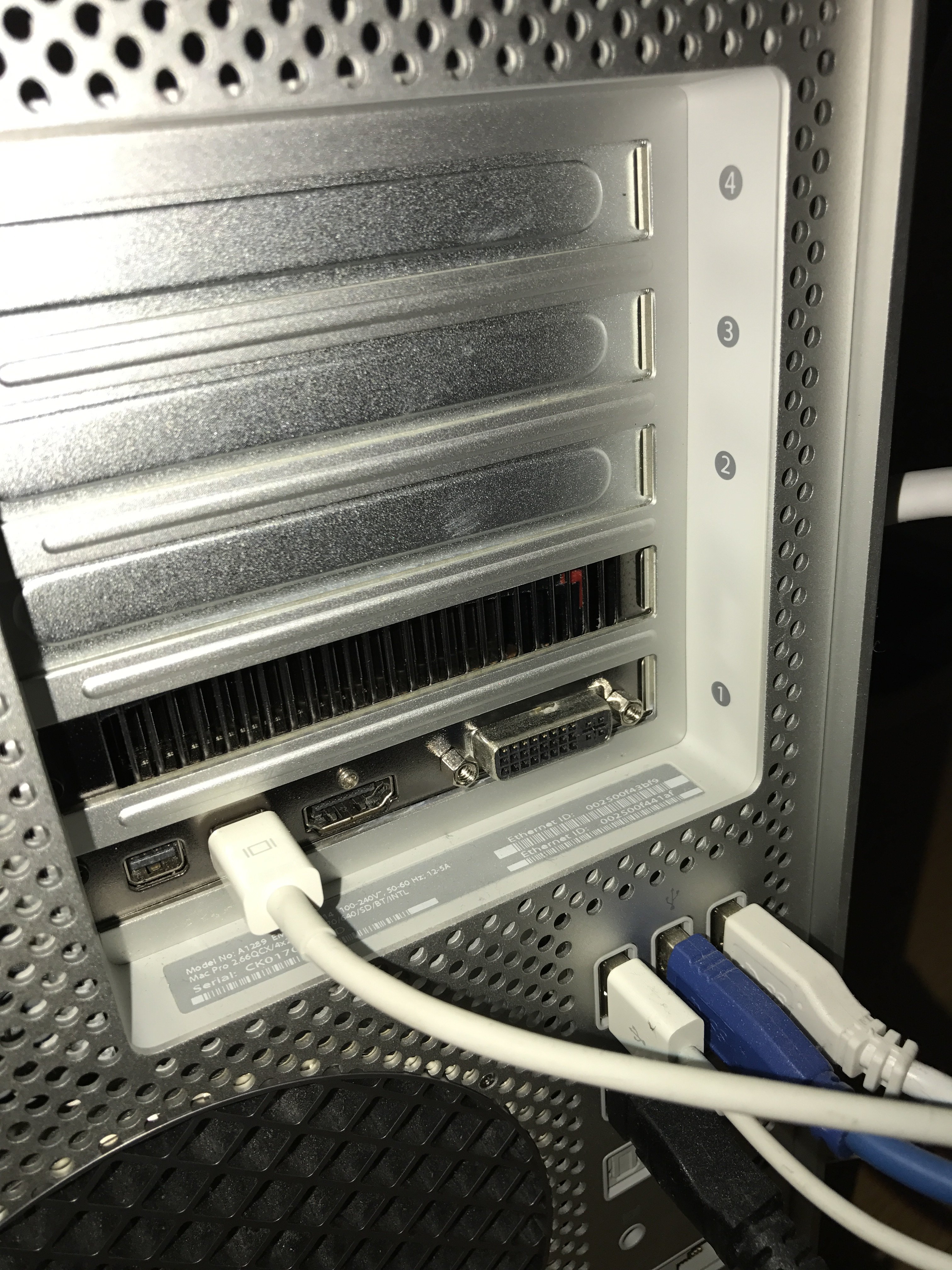

I currently have this one installed
http://wccftech.com/sapphire-unleashes-radeon-hd-7970-3gb-monster-28nm-dx11-graphics-card/
Its suppose to be a good card, but if we divide my needs in two, video editing, and xplane.
Im thinking i could have two separate cards, and install them for different needs, in periods.
For video rendering in FCPX, you think a dual setup of the 7970 cards would be a good choice here?
Will it handle 4k files better?
How about the setup, is it pretty straight forward? Do i normally have enough PCIe slots for this on my machine?
How about PSU, need to upgrade that one for dual?
Tried to take a couple of snapshots this morning.
Or would you suggest another setup for this purpose, like the ones you have?
Regarding the sim, would you go for the the Titan 12, or the 980Ti, disregarding the price?

View attachment 685044 View attachment 685045 View attachment 685046
Your slots are basically empty, so dual 7970 is not a problem at all. However, you have to think about how to power both cards at the same time. The PSU is fine, just how to deliver the power. Here is the thread that about dual 7970 setup.

I tried to read up on the two links you provided regarding powering.
The first one looks great, but all my drive sockets are occupied, so i guess its not possible then?
The Pixlas mod seems to be a little over my head for what i dare to do inside these machines :O
Are there any ready made solutions you can buy in shops?
A question about dual setup and cooling, wouldnt stacking those cards blow hot air from the one below right into the one above?
