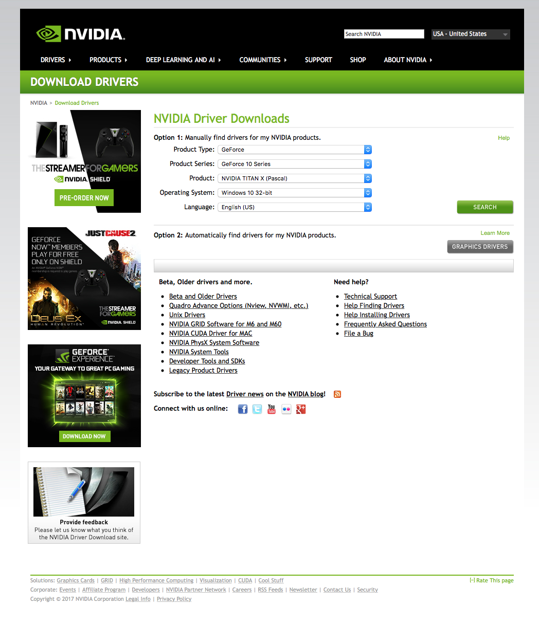

http://www.nvidia.com/Download/index.aspx?lang=en-us
In the Operating System window, you need to click on it and scroll down to "Show all Operating Systems" then choose 10.11.6.
Lou
Thanks, will it work with any 980ti card?
[doublepost=1486227844][/doublepost]But, there were no OSX drivers there, either under 900 series or 9 series?!
^^^^Yes!
Did you reach this page?
Lou
^^^^They're not "600 series" drivers. the Nvidia Web Drivers are drivers for any card supported in the Mac environment. Sadly not the Pascal series. I have a GTX 780 with the "a" chip. this card works with Apple drivers as well as Nvidia's drivers and the Cuda driver.
Reactions: Synchro3
For the MacOS Nvidia drivers, you don't pick the download based on the hardware, you pick the download based on the MacOS version (down the specific build number in fact).
By far the easiest way to get the right driver is to look up your exact OS version and then go here:

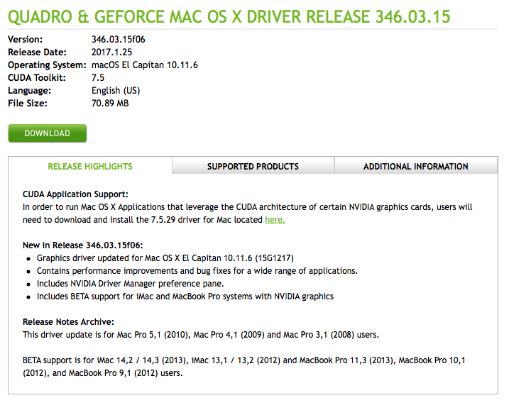

They ARE 600 series drivers. Why don't the drivers show up if you select 700 or 900 series? Try it. The drivers will NOT show up if you tell it you have a GTX 980. No OS X is available in the operating system selector. You HAVE to say you are using a 680 for it to show OS X. The GTX 680 was the last "officially" supported NVIDIA card on the 2010 Mac Pro. As I have said, I have already encountered a few issues running my 980 on my system.

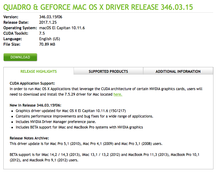

Also, did you even take a look at the driver's supported products?
Supported Products
GeForce 600 Series
GeForce GTX 680
GeForce 200 Series
GeForce GTX 285
GeForce 100 Series
GeForce GT 120
GeForce 8 Series
GeForce 8800 GT
Quadro Series
Quadro K5000 for Mac, Quadro 4000 for Mac
Quadro FX Series
Quadro FX 4800, Quadro FX 5600
Where is the GTX 900 series in that list?

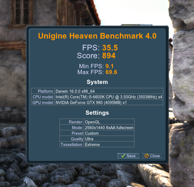

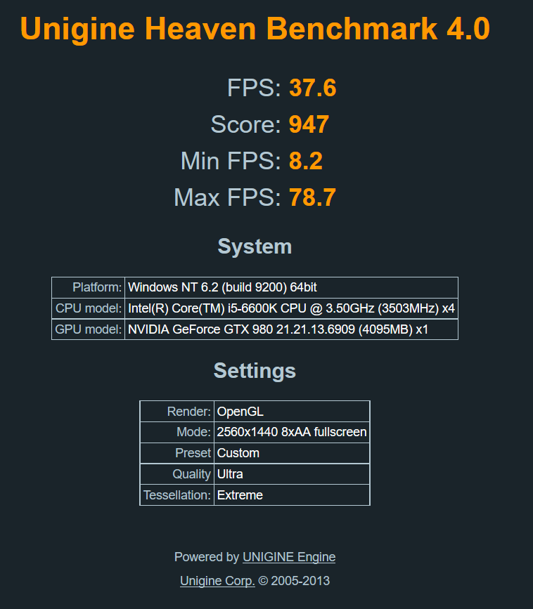

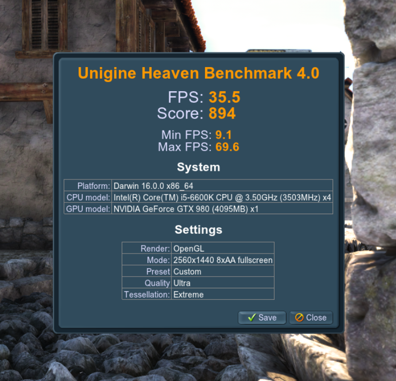

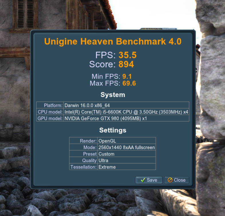

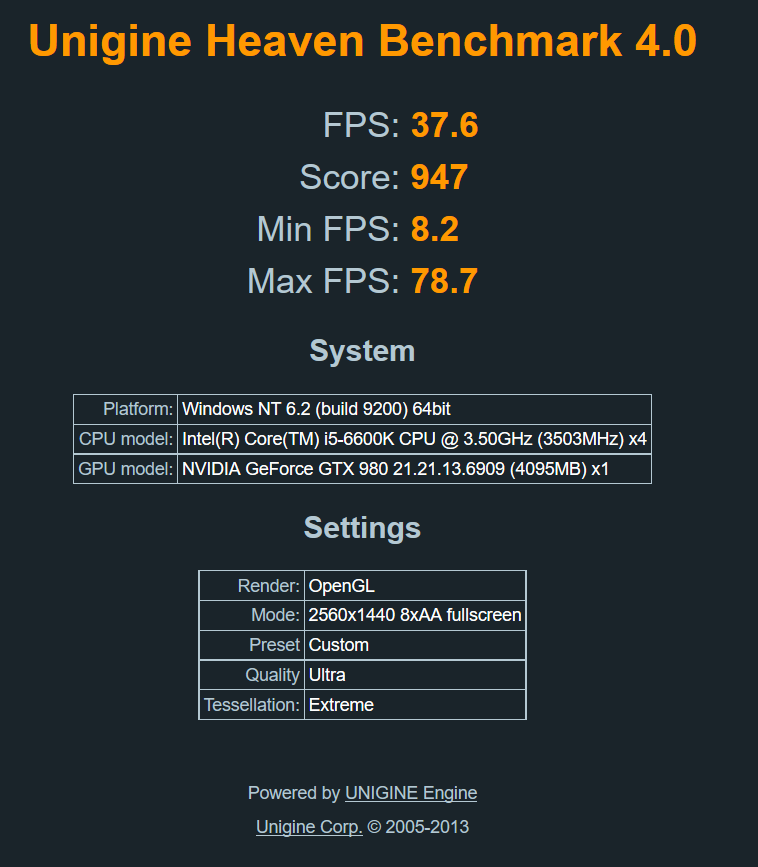

That's due to the high CPU overhead in macOS graphics APIs and affects all GPUs, no matter if they're "not supported", "supported" or official Apple ones.
In my Skylake Hackintosh, the performance of a GTX 980 is virtually identical in macOS and Windows 10, since the CPU isn't bottlenecking the GPU anymore. Just have a look at this Heaven benchmark, it's just 2 FPS (~6%) difference, not notable at all:

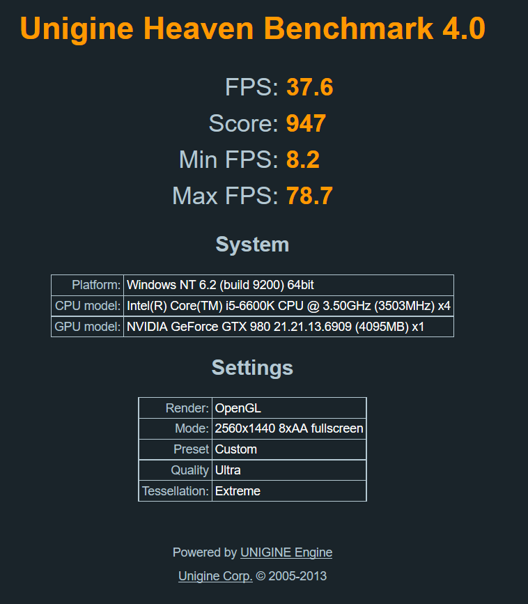

View attachment 688349 View attachment 688350
