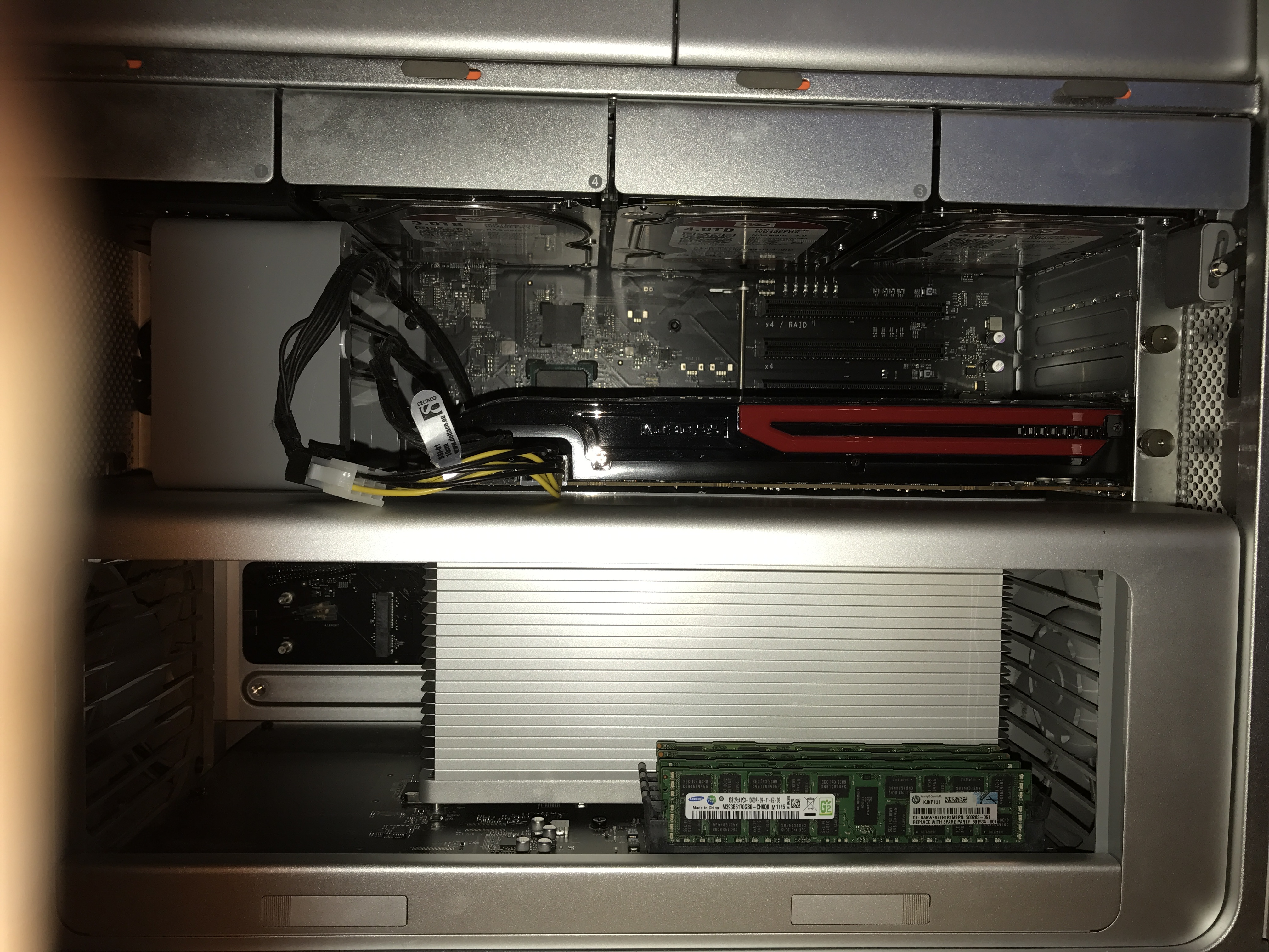

Hmm, that looks pretty tight? Its about same size as my 7970?
Awesome, then ill be getting two 7950s.
So what i need in addition, is a 6 pin splitter?

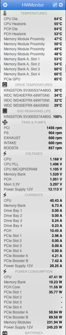

Ive been rendering for an hour on my 7970 now, heres the current draw and temps, doesnt look bad, only a few degrees difference
