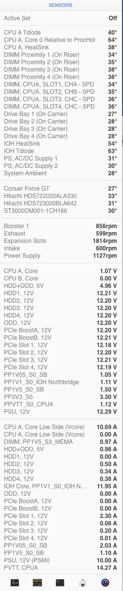

I just ran OpenGL Extensions Viewer and ran a test. It failed 4.2 and 4.3. Also, using iStat menus my Power Supply fan is spinning at 1126 RPM.
Something is really going wrong here.

I just plugged my GTX 780 Ti Classified back in and everything is now operating as normal. The Expansion Slot fan is running over 900 RPM, but dropping still. The Power Supply fan is spinning at 600 RPM.

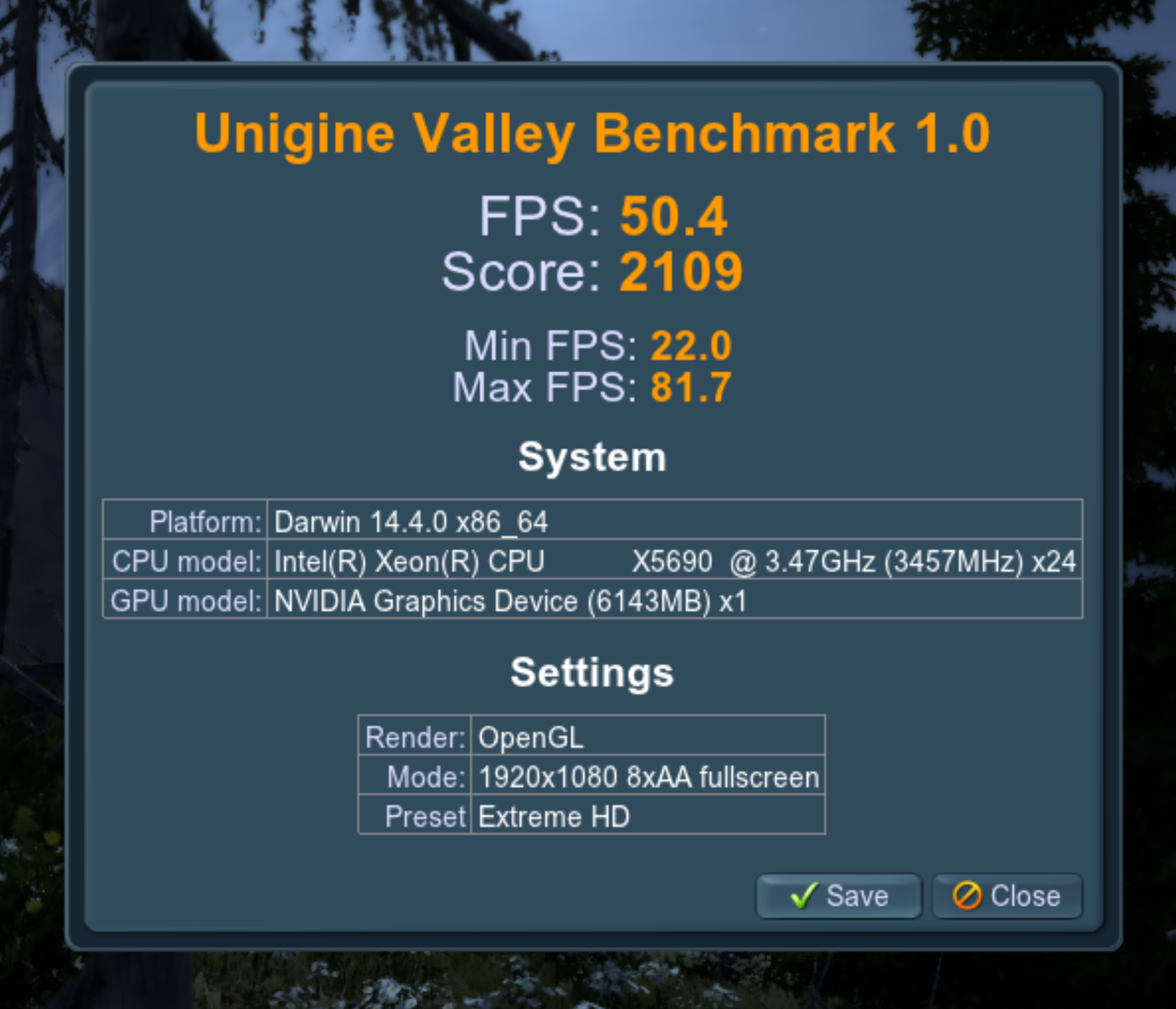

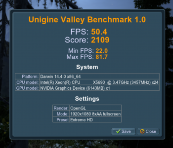

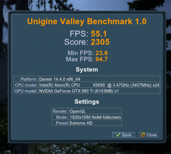

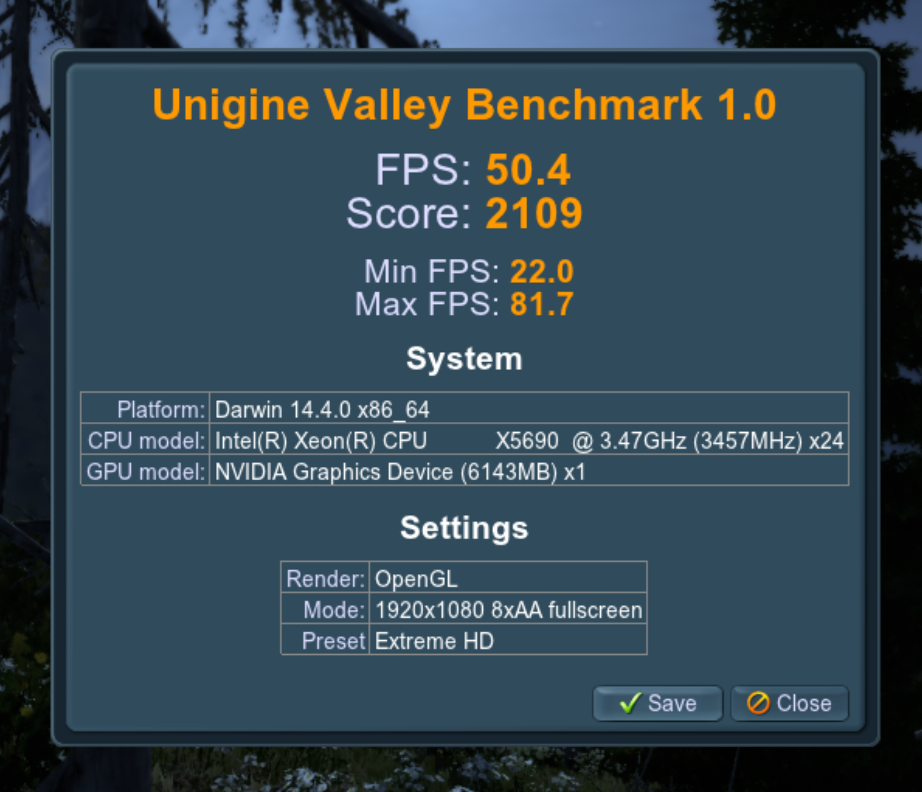

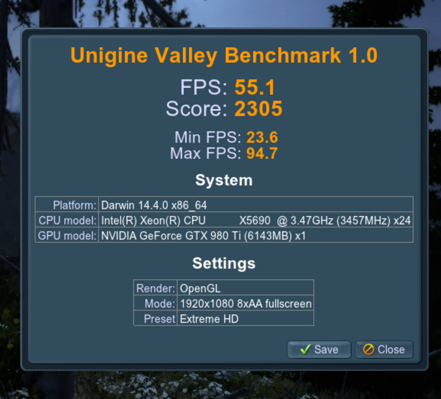

there is a new web driver out. Recognizes the 980ti for what it is instead of "nvidia device". Can't find any information on the driver, but hope this makes things faster.
New drivers obviously are now optimized for the 980ti. Using the Unigine Valley demo I originally had a 2109. Now with new drivers it's up to 2305! Impressive.
