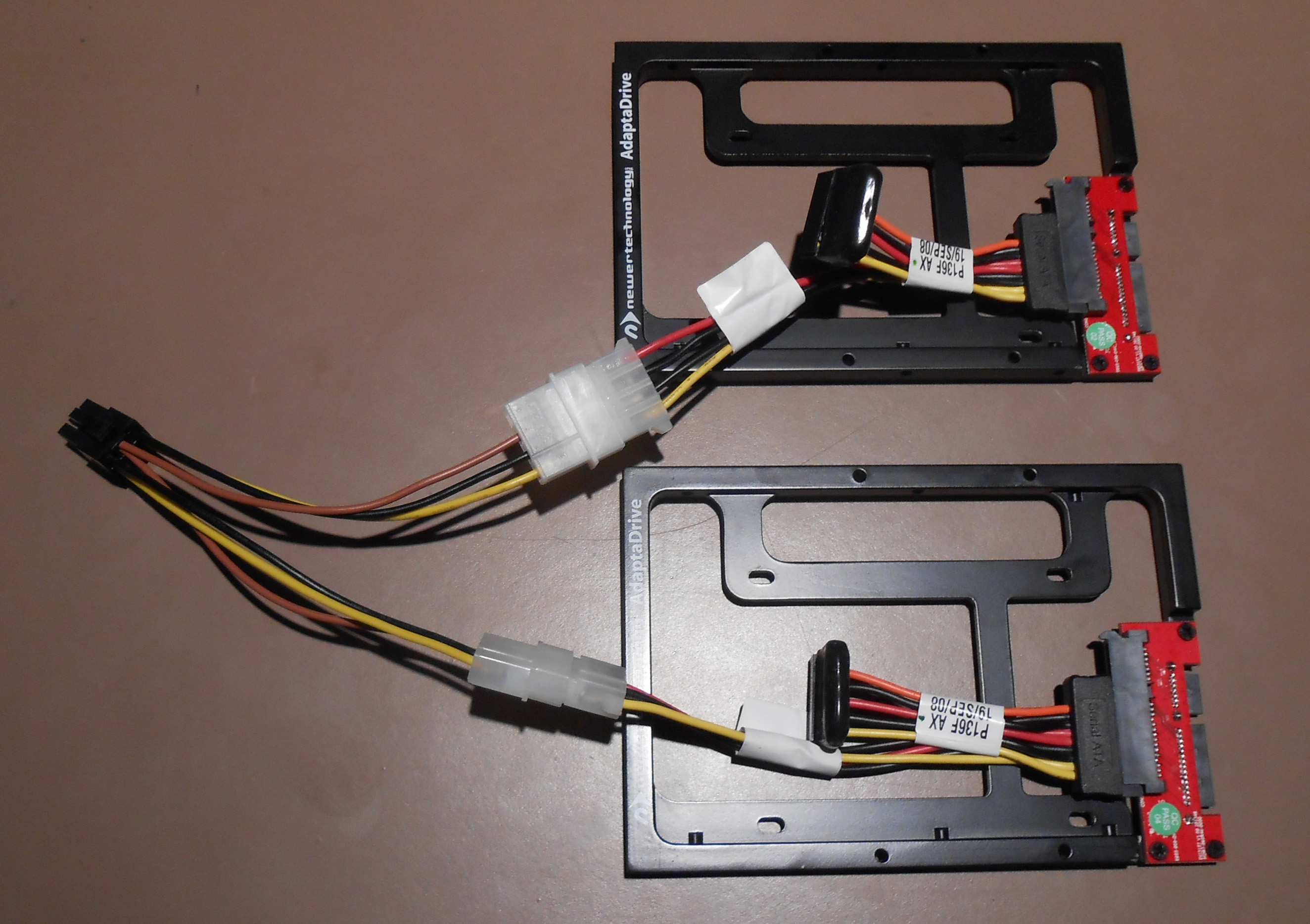

OK... if you use a (2x) mini 6pin -> 8pin from the (2x) mother board PCI ports, you have your 1st 150W power to the GPU 8pin socket.
This is an elegant and easily removable solution I have for feeding the remaining GPU 6pin socket.
This includes the following...
(2x) Newertech AdaptaDrive 2.5" HDD/SSD tray adapters for the Mac Pro internal drive bay slots ($13/each)
(2x) male 15pin SATA -> male 4pin molex power cables ($2 each)
(1x) (2x) female 4pin molex -> male 6pin power cable. ($2)
The AdaptaDrive adapters mate up perfectly with the Mac Pro internal drive sleds. Simply tie wrap the SATA -> Molex cables to the tray adapter to prevent them from accidentally unplugging. These trays can be removed at any time simply by removing the internal drive bay sled.
This gets you another 110W (55w x 2)
Total of 260W power.
As others have said, 6-6 and 6-8 cables seem to power the 980 Ti just fine, but if you're unsure this is an elegant solution.
BTW... no reason the cabling on this solution could not be used to take power from the (2x) Optical Bay SATA power ports if you're not using an internal optical drive.
AFAIK one SATA port provides 50 Watt, not 75 Watt. So the setup above gives only 100 Watt, not 150 Watt.
My understanding is that he mean
1) 2x mini 6pin from the mobo to power the 8 pin (150W -> 150W)
2) 2x SATA port to power the 6pin (100W -> 75W according to your number)
So, this should be technically safe.
75W + 75W + 55W + 55W = 260W
There are many ways to skin this power cat, but this was an easy way if you don't want to do excessive wiring or tapping into other cMP power lines.
