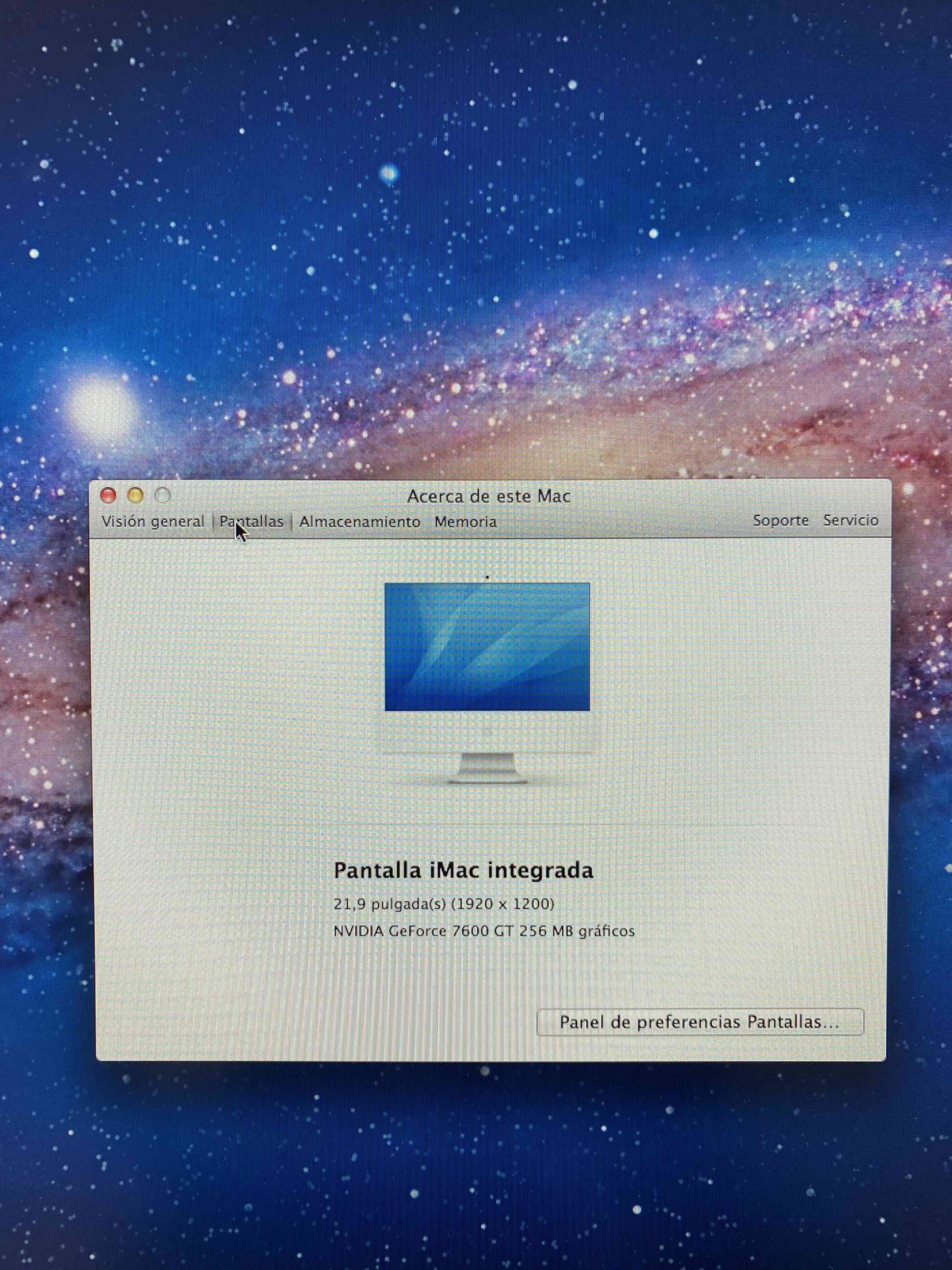

BTW, the only thing that happened to me when I installed it a while ago (on the HDD) and now with the file from the Apple website (with another installer). Is when you go to more system information, the model or year does not appear (next to the model icon). And when you go to the screen it says 21.9" (that model does not exist) when it should be 24". If anyone knows how to fix it, please let me know haha just curious. It works much faster with the change from HDD to SSD.

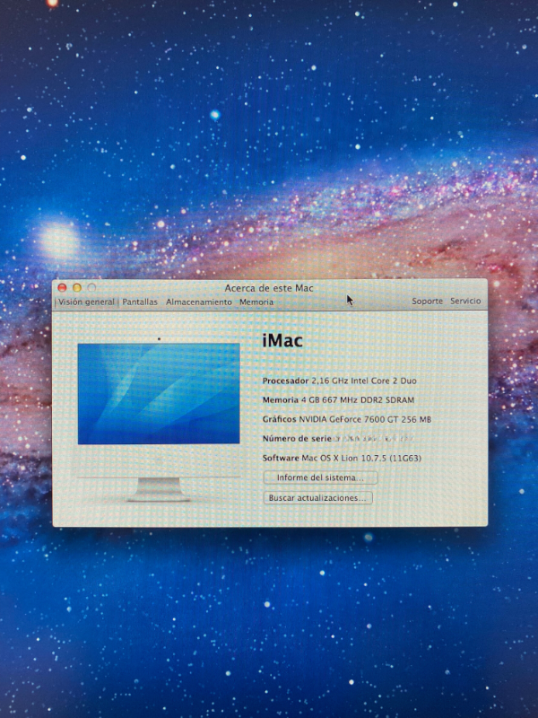

Hello! I attach the photos of what I told you. It's an iMac late 2006 24". When you go to more system information, the model or year does not appear (next to the model icon). And when you go to the screen it says 21.9" (that model does not exist) when it should be 24". If anyone knows how to fix it, please let me know haha just curious.

Click on "Informe del systema..."
Show a screen shot of the first window, showing the hardware details (Hardware Overview)
2nd line "Model Identifier" should be "iMac6,1"
Are you the original purchaser (and have had it since new?)
I would probably try replacing the PRAM battery. If original, nearly 20 years old, it is likely dead, which can affect how the hardware configures itself at boot
Thanks for the quick reply. Yes, where you say it shows iMac 6.1 and the PRAM battery I changed too because I thought the same thing (before installing the SSD) because it was already happening with the HDD, but it seems that it has nothing to do with it.
I'm not the original buyer. It did show it before (because there were photos in the ad) but when the system was reinstalled it always showed up like that.
