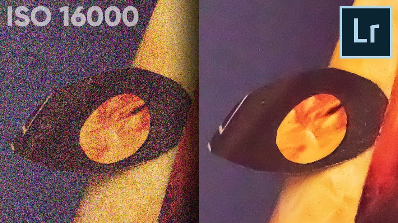

This is a visual representation of what mine looked liked in real life, of course exaggerated.
New one is not like that at all, looks like the right
