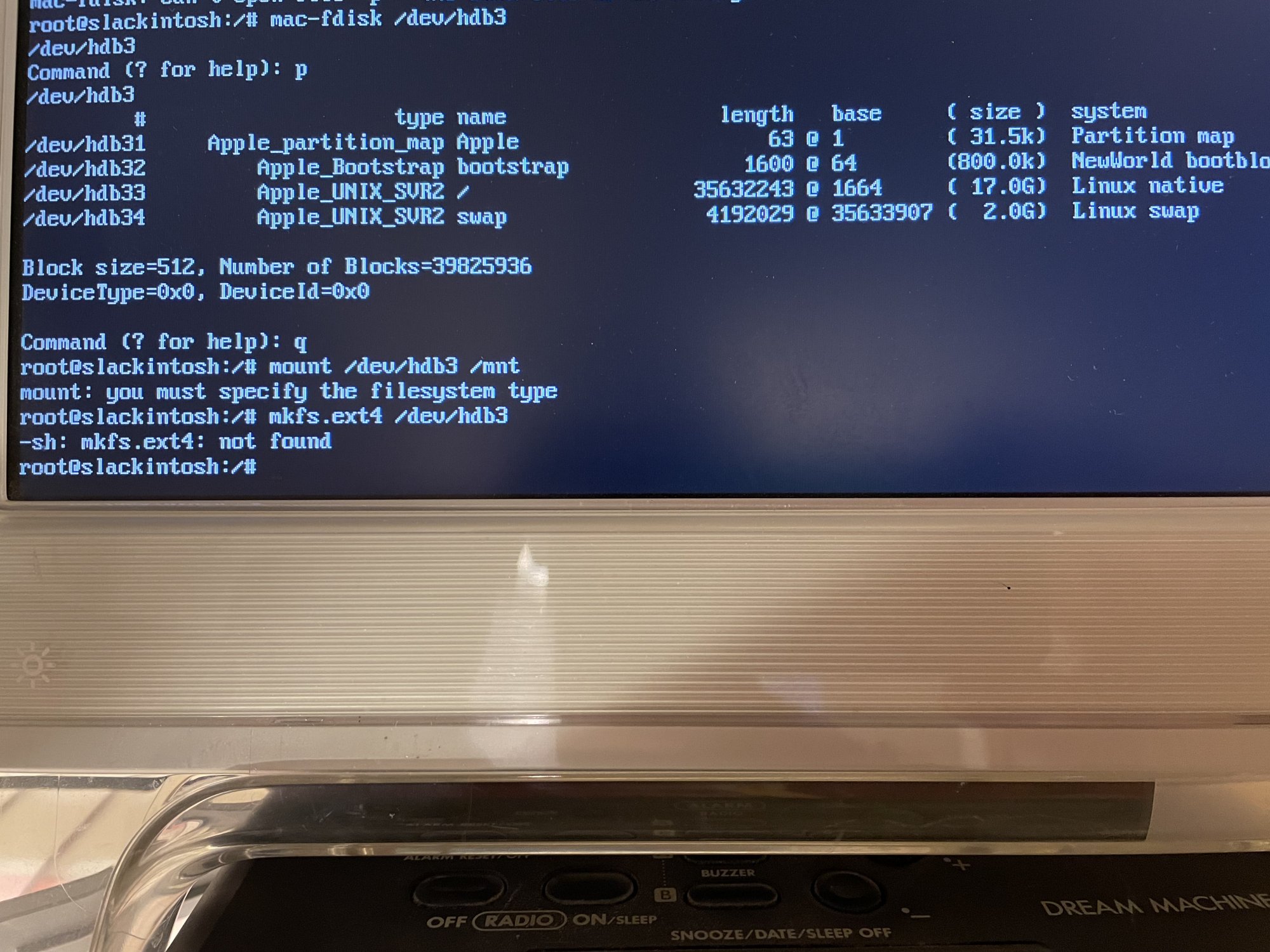

Here is a photo of Mac-fdisk small p for my partitioned hard drive. You will also see trying to format the drive using mkfs.ext4 was basically an unrecognized command. I did try to mount the HD and was met with the statement, specify file type.
Ah. It looks like you sub-partitioned a partition, not the drive. What does p after mac-fdisk /dev/hdb say?
You are correct. I was wondering why my partitions were labeled that way, I went back and reinitialized the drive and repartitioned it. I had partitioned /dev/hdb3, not /dev/hdb. However, after doing that, the mount command and the mkfs responded as shown above. I will revisit it today.
First try simply re-running the installer now that you have a correct partition table. Maybe it detects the Linux partition(s) now.
If it still doesn't detect any Linux partitions, try formatting your root partition with mke2fs -t ext4 /dev/hdb3 (assuming it's /dev/hdb3).
mkfs.ext4, if it exists (apparently it doesn't in Slackintosh/Slackware...), is just a shortcut to mke2fs -t ext4 anyway.
After formatting, try mounting the partition (mount /dev/hdb3 /mnt) and re-running the installer.
That was the problem! After partitioning the WHOLE disk, I went into setup and BOOM, I'm walking through the install process as we speak.!! You've been a ton of help and I thank you. I can only hope now, that once the install is complete, Slackingtosh doesn't have any issues with the nvidia GPU. We'll see!!
