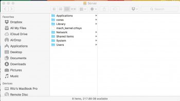

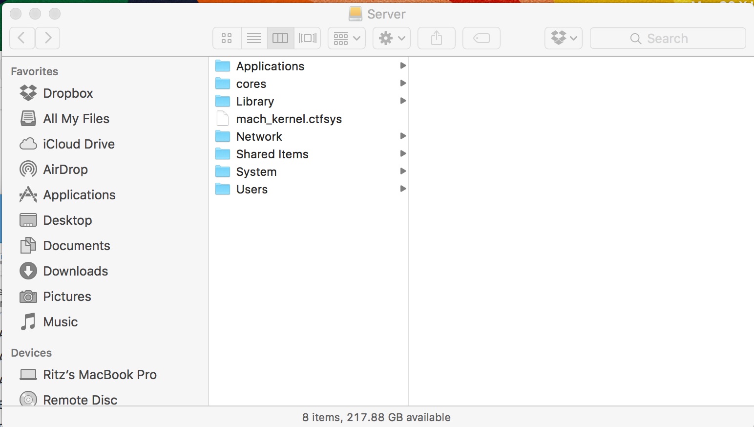

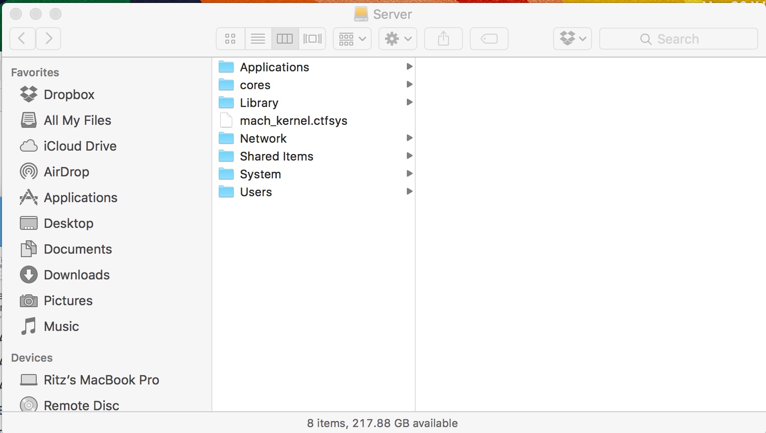

Here is the folder that I installed "OSinstall" + "Essential.kg"
Isn't EFI for intel only?
