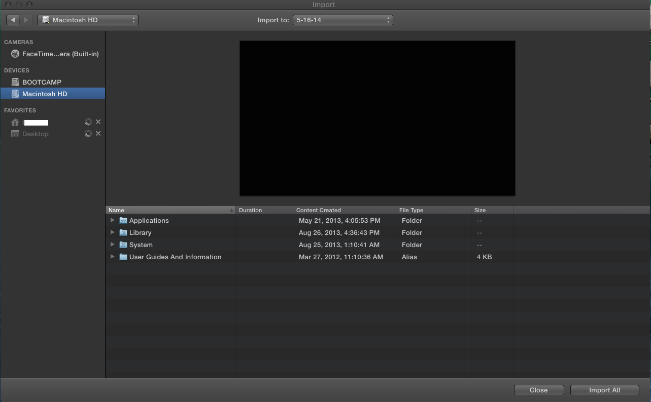

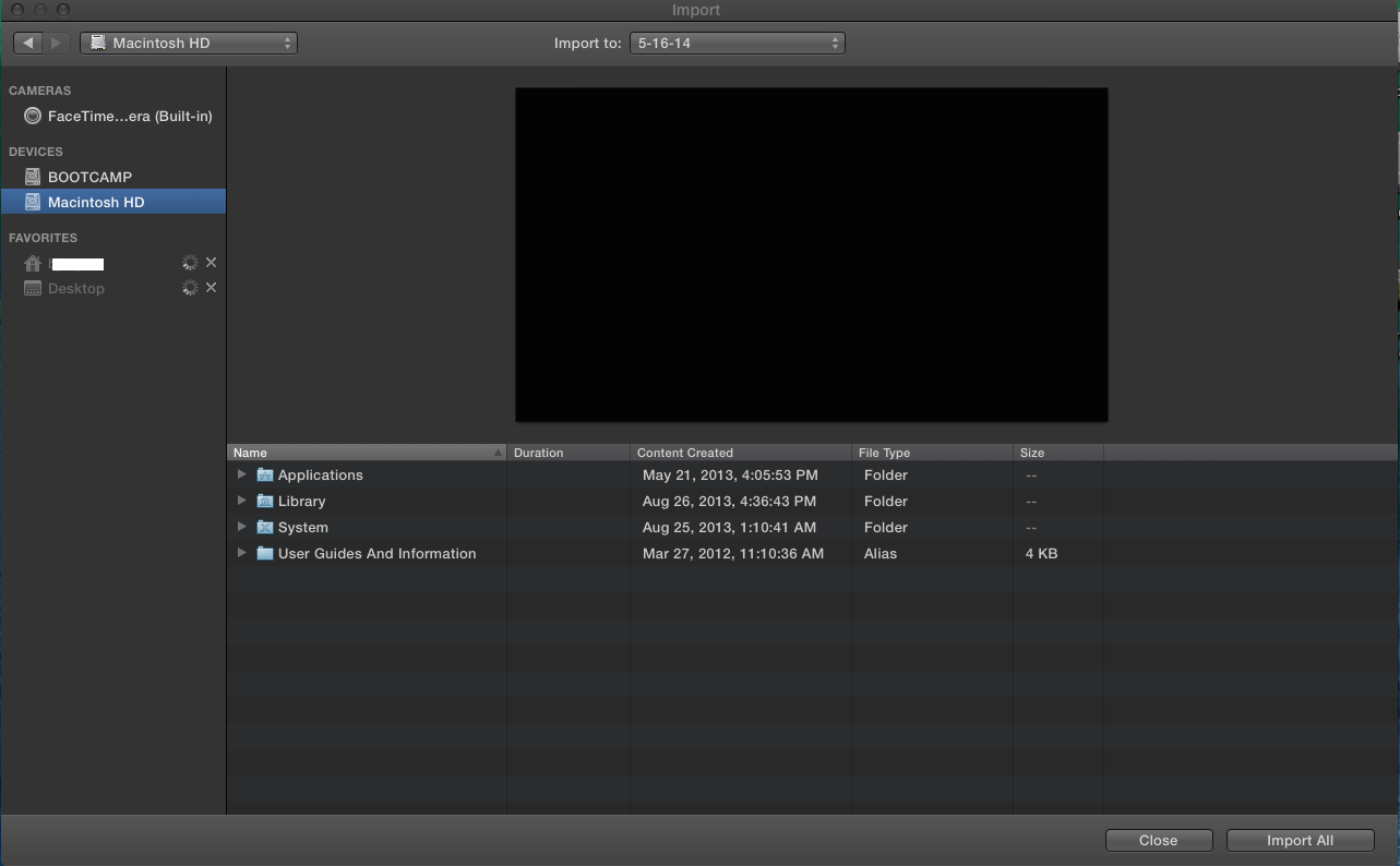

Finally ran into an issue with the Users folder being hidden. My Favorites list in FCP won't show up.
iMovie import
Here's a screen shot of iMovie import when /Users is hidden. Notice the spinning icon under Favorites. I proved its a bug by doing a chflags for /Users and it works fine when unhidden. Sure hope apple reads my feedback and gets this fixed. Who know what other apps will be affected.

Breaks Final Cut Pro / File > Import Media
I was at an Apple Store today for a one-to-one learning how to best use Final Cut Pro X. The person wanted me to use File > Import Media and it would not work (appears to just hang) with the /Users folder missing. She tried to convince me something must have gone wrong with the installation of 10.9.3. Not clear if it's that or iTunes 11.2 (others noted in this forum it could be either).
The "sudo chflags nohidden /Users" work-around does get Final Cut's media import functioning again.
Clear it's a bug, and it breaks one of their "Pro" applications. Hopefully they'll get it fixed.
Just posted something about Final Cut being broken. Looks like both iMovie and Final Cut were affected in the same way.

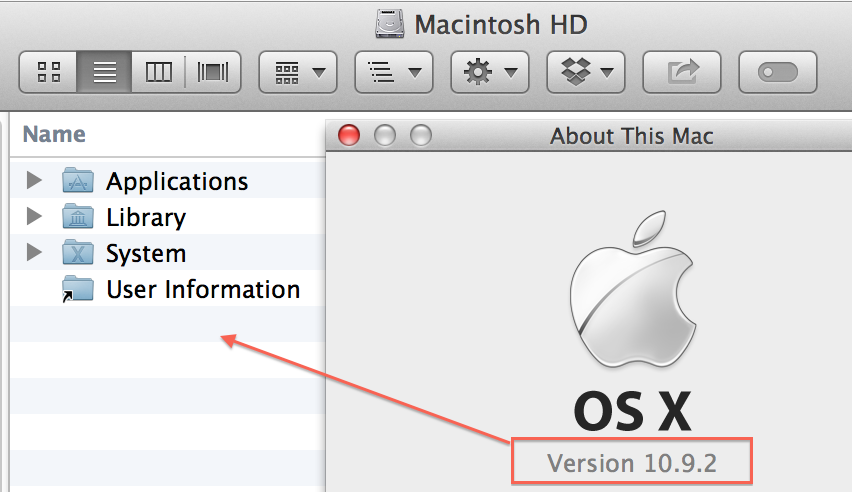

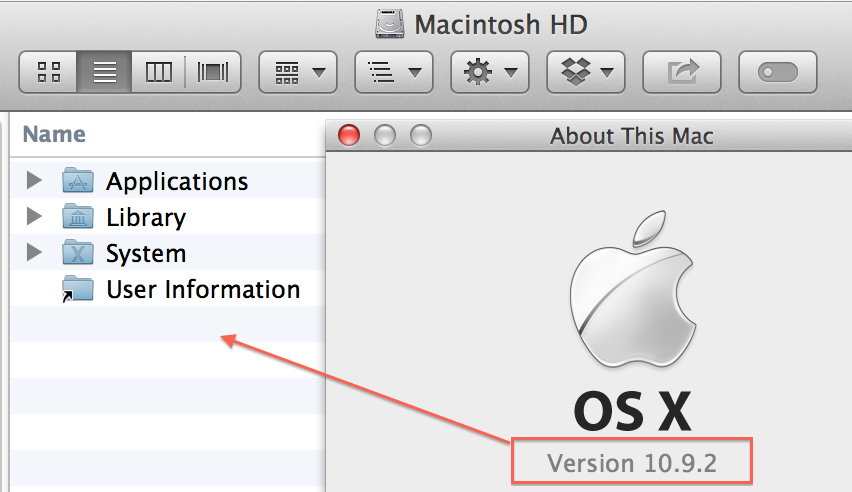

No, I didn't see the other threads. The 10.9.3 and iTunes 11.2.1 updates appeared this morning and I checked the forum before applying them, only searching for 10.9.3. I took that screen shot before, and now that I've applied them, the Users folder is back. It sounded like people were claiming the 10.9.3 update caused the folder to be hidden, but now I see that wasn't true. It was already hidden in 10.9.2.
