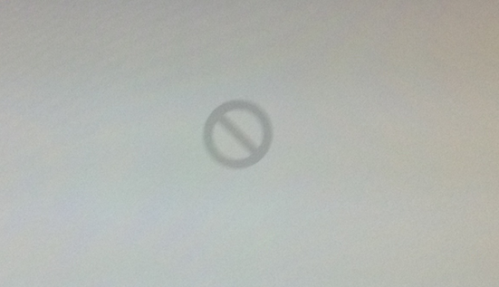

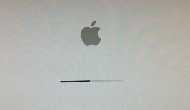

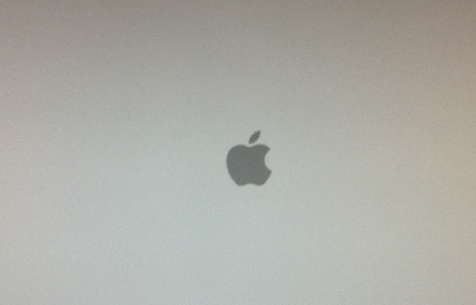

I used the latest boot.efi from Pike R Alpha on my mac mini 2,1
Capture d’écran 2015-10-15 à 16.50.31.png Capture d’écran 2015-10-15 à 16.50.44.png Capture d’écran 2015-10-15 à 16.50.52.png
The sequence is:
- USB disk flashes and loads something
- USB disk stops loading (but USB Hub is still powered) & progress bar appears on screen
- Stop sign appears a bit after the middle of the total progress bar
I do not know if the Install GUI follows a progress bar too, or my Mac loads something from somewhere else and stops ?

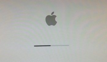

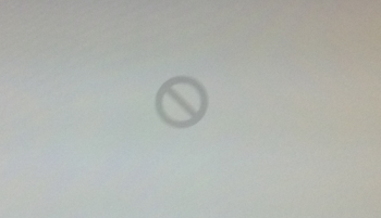

The sequence is:
Thanks for sharing ideas. Also, if somebody close enough to Pike R Alpha could hint to him that owners of Macs others than MacPros would love to get his attention to get our systems to work on El Capitan, that would be superb !
Yep, that is what happens when USB driver quits.

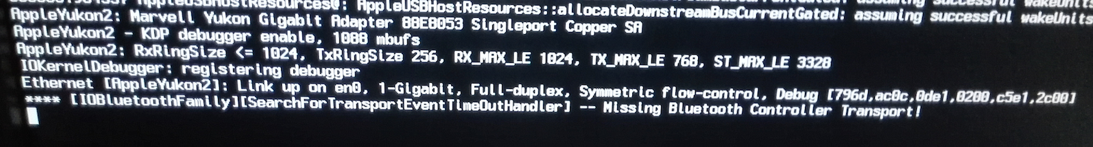

Update:
I used latest commit from Pike R Alpha & new USB installer with CreateMedia method. I changed all the boot.efi(s), the platform support, Distribution list, etc...
Result:
Load hangs at "Missing Bluetooth Controller Transport !"
and then new screen with
"Still missing Root Device"
see below screenshot
Try the Boot.efi commit 70f77b1a86590bdce100b5eda2f7cd574d47be1e with the legacy Installer (Hennesie-Guide). It boots into the Installer-GUI, the install starts, but on the MBP2,2 I get a Kernel Panic after 2 mins.
Is the install media via USB? If so it will never work.

As the load was hanging on the BT Kext, I just tried to replace the IOBTFamily kext by the Yosemite one. Same result though, hanging there & "still waiting for a root device message"
Yes, I tried & same result. Till there is a solution for USB/BT stopping working when EC loads Kexts, there is no way to get the installer to the end.
