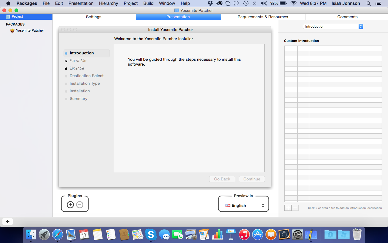

Yosemite Patcher (sneak peek)
We are looking into automating the process of patching OS X Yosemite. Any more help would be appreciated.
