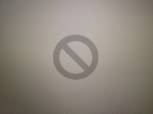

I've done all! Installer reports no problem, but at first boot i get the "can't load on this system" image. I edited both PlatformSupport and InstallableMachines, also created a new OSInstall.mpkg following your steps. I will double check. I've jumped the boot.efi, probably the issue

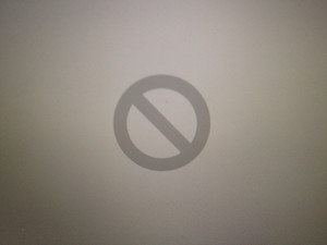

@atvusr
What model do you have? I don't really know if your Mac needed the modified boot.efi or not but first try deleting the PlatformSupport.plist from the newly installed partition using the terminal in the OS X Installer image

I've rereplaced boot.fi with the original Yosemite one and now the installer works again, trying to make a clean install. If still no joy i will try to delete PlatformSupport but should not needed since i've edited it and aded support for my Mac as the guide said. I will let you know later.
If the Installation is successful but the Mac is unable to boot into OS X Yosemite, go back to the OS X Installer and find the terminal. Enter this:
sudo rm /Volumes/[Macintosh HD Name]/System/Library/CoreServices/PlatformSupport.plist
The OS X Installer sometimes adds another platformsupport.plist during installation. I don't know where exactly that copy is coming from though.
