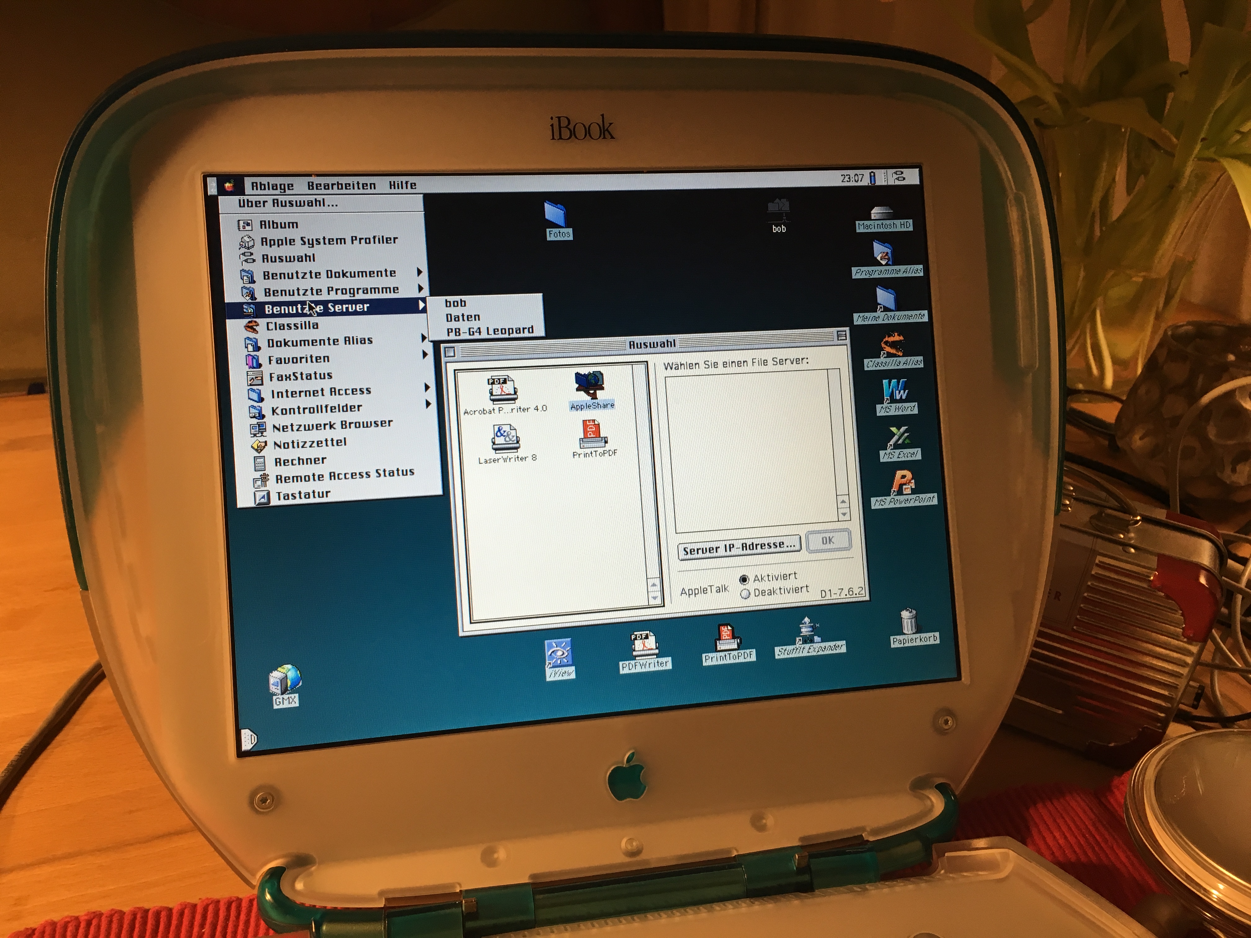

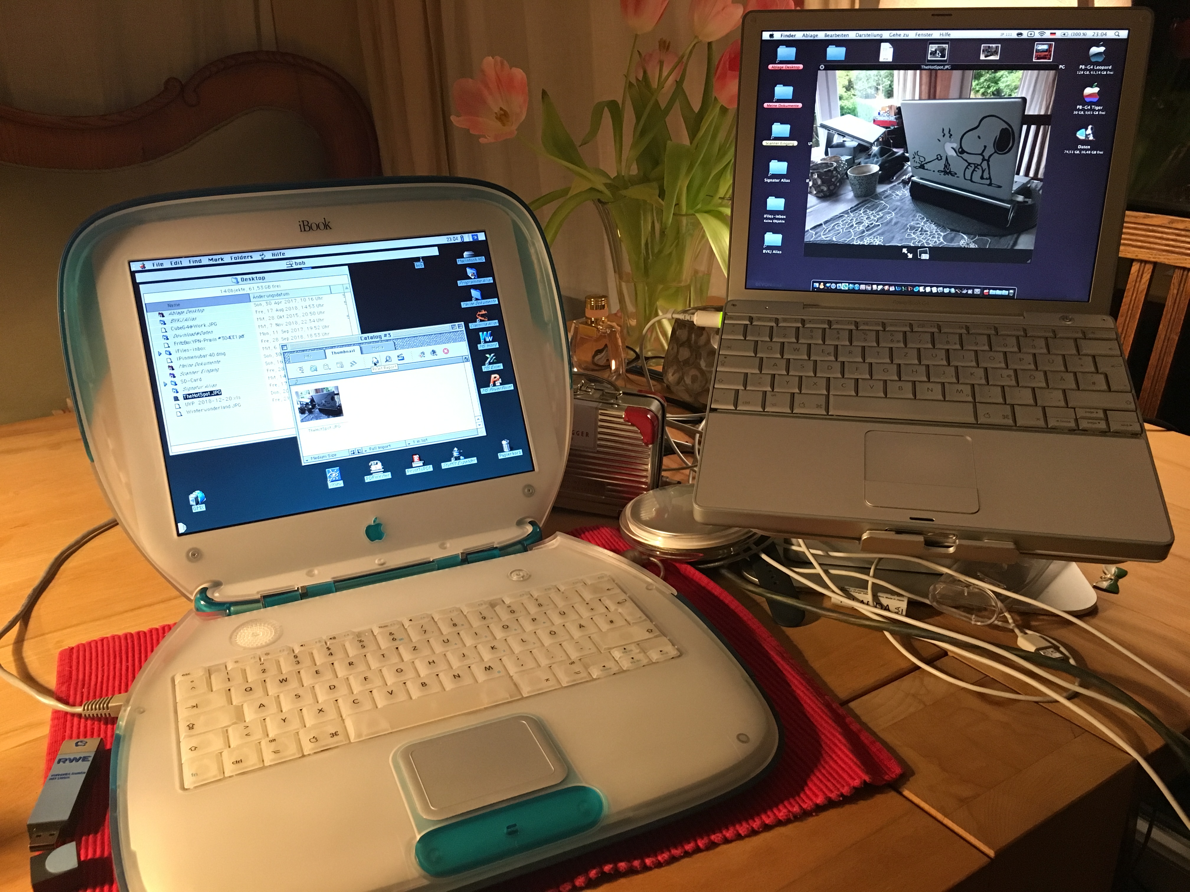

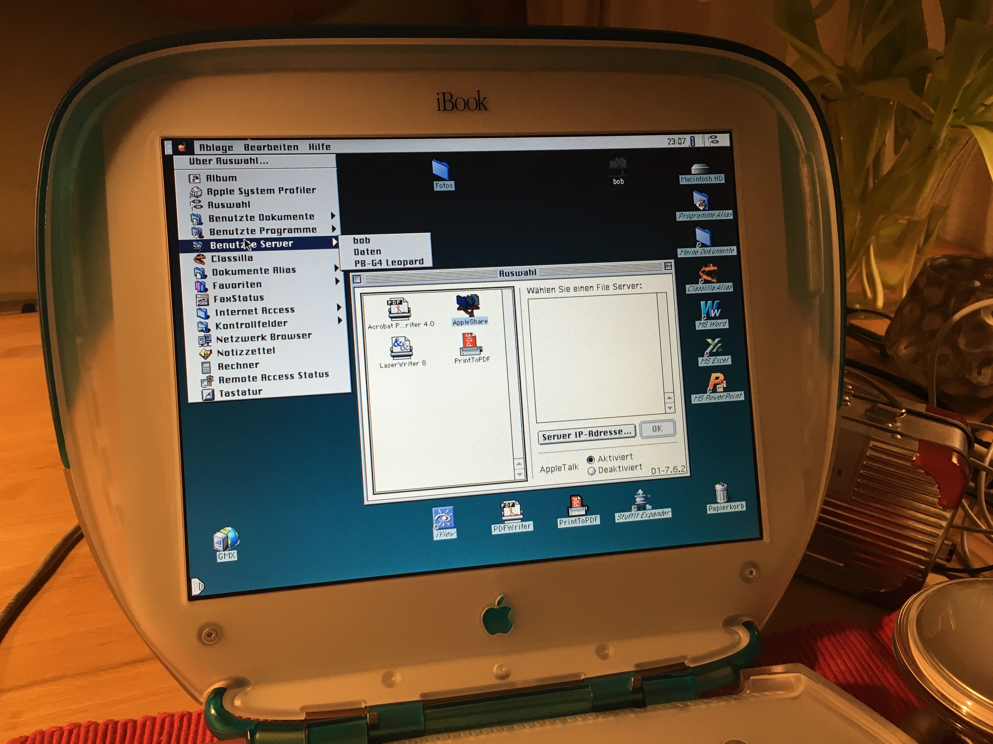

Inspired by the dicussion about the end of the Dropbox-Client for PPC I tried to establish file-sharing not only for my Tiger/Leopard-PPCs but also for os9.
Connectivity with Tiger/Leopard(PPC) and late OSX (ElCap) works fine and is easy to establish.
But it took me a while to find out, how things may work with os9:

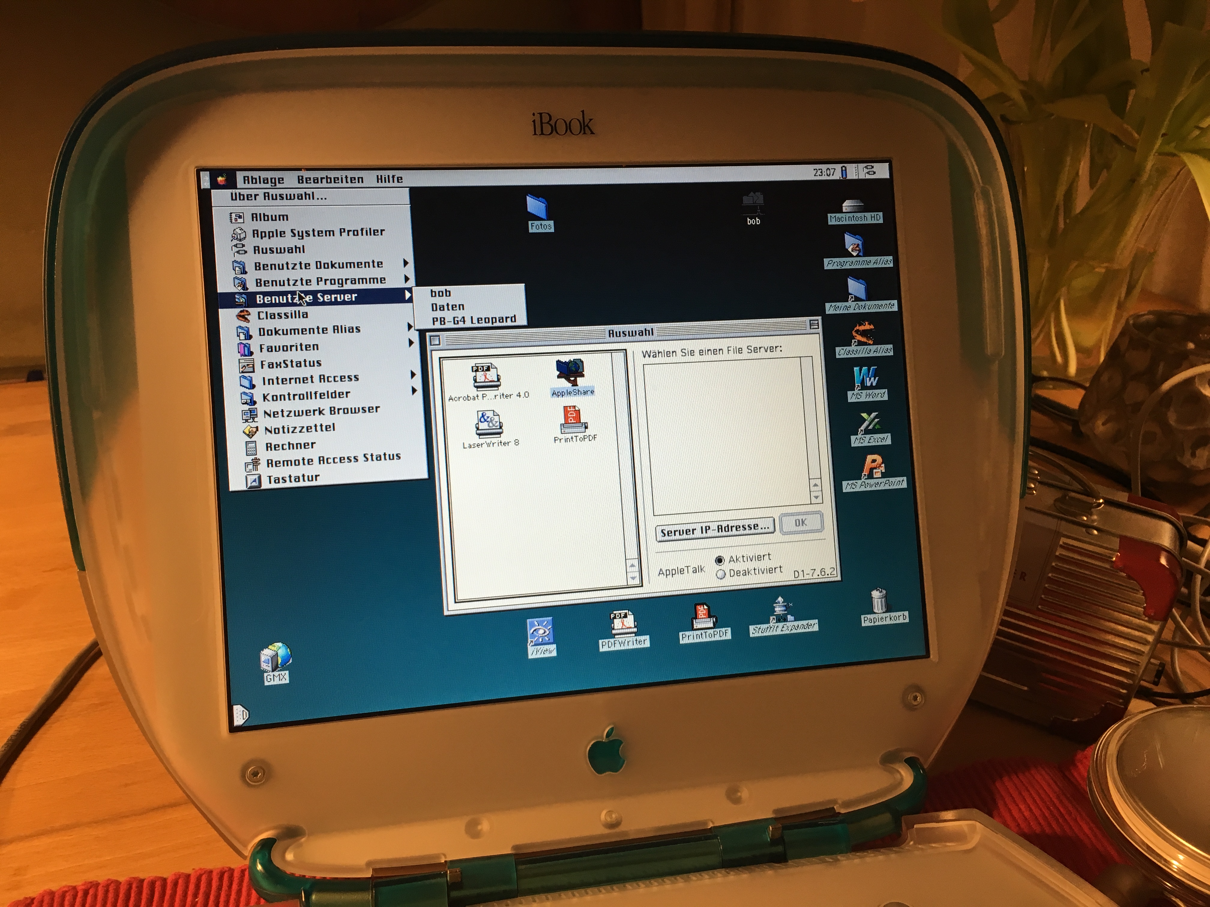

"AppleMenu => Chooser => AppleShare (AppleTalk activated) => ServerIP-Address (192.168.xxx.xxx)"
After editing the credentials for the RemoteMac/Server there will be an Alias for each Server both on the os9-desktop and at the "AppleMenu => ...Servers"
Very convenient!

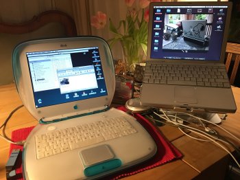

I managed to connect with my 12"G4-PowerBook/Leopard for file-sharing. Smooth handling!
Unfortunately so far no success to get connected with my 15" early-2008 MacBookPro (ElCapitan). Error messages claims "incompatible version of the AFP-protocol"

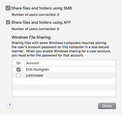

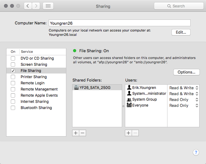

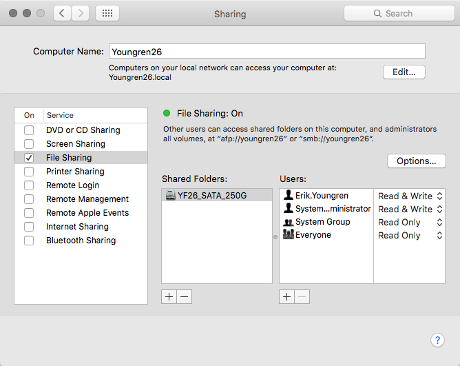

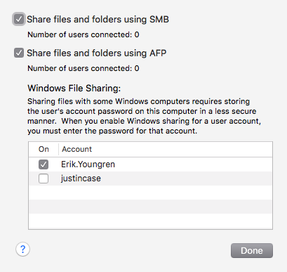

Go to Sharing (System Preferences) and make sure it's on and all your credentials are set.
Click on Options on the right…

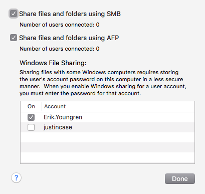

Make sure Share files and folders using SMB is checked and make sure you check the box for the user account on your Mac that you want to have access. Click OK. That's it.

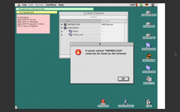

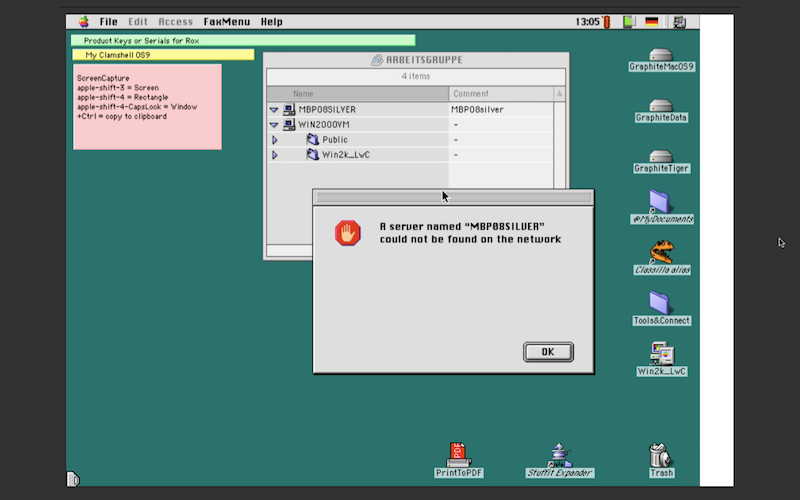

Thanks! Checked that all these settings are correct on my MBP A1260. They seem to be ok indeed - I did need SMB for some occasions somtime somehow and made the setup some time ago, I don't know when ...
But I can't get os9/DAVE4/NetBIOS run properly. Every time NetBIOS-error #5 and no detection of my A1260 MBP.
On my os9 machine settings are: DHCP on, TCP/IP on, AFP on. I'm able to connect with my 12"PB via AFP.
All trials to connect os9/DAVE4 with my MBP-A1260/ElCap were refused.
Maybe DAVE4 is to old to connect with the ElCap-SAMBA-protocol?

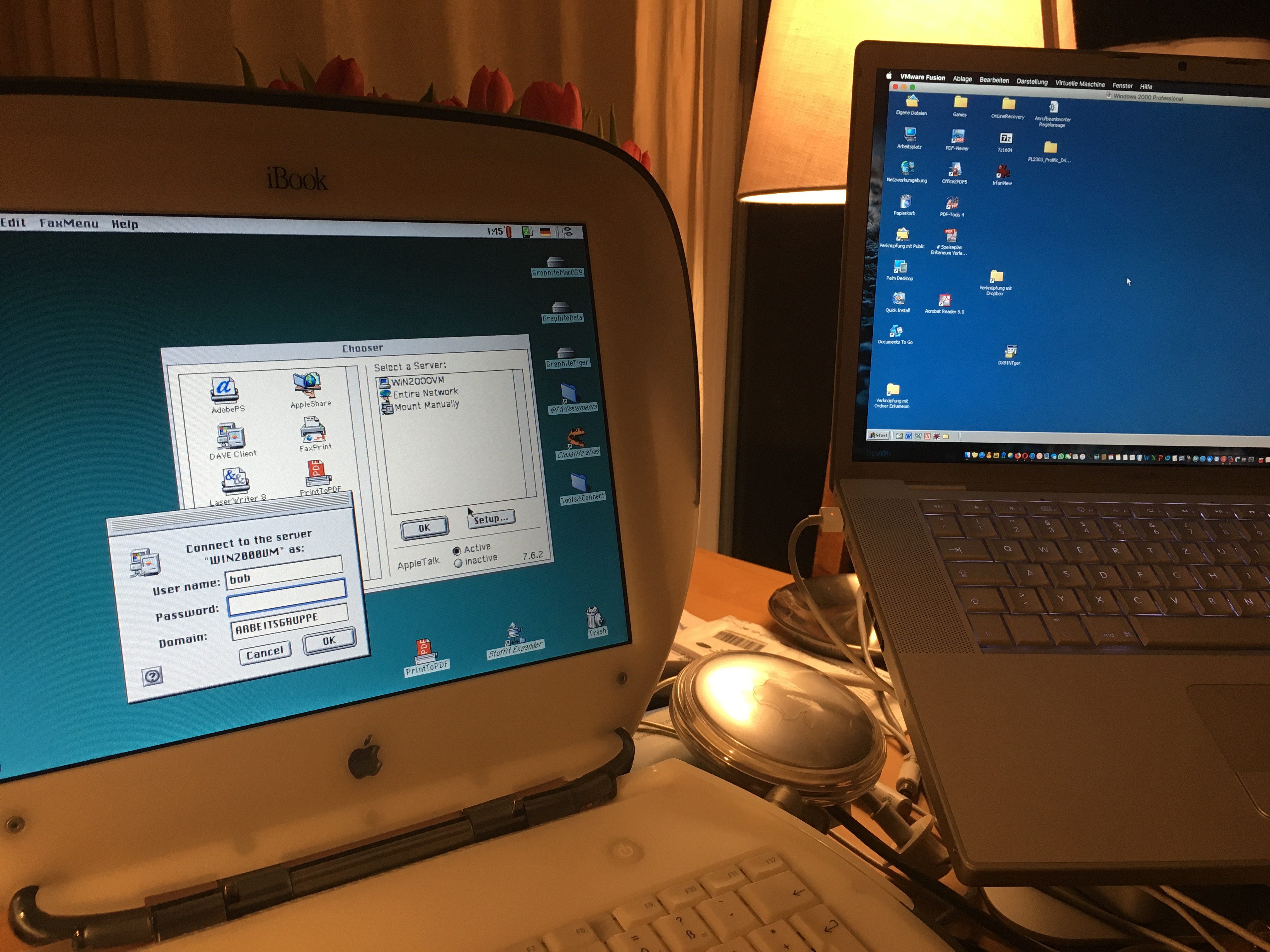

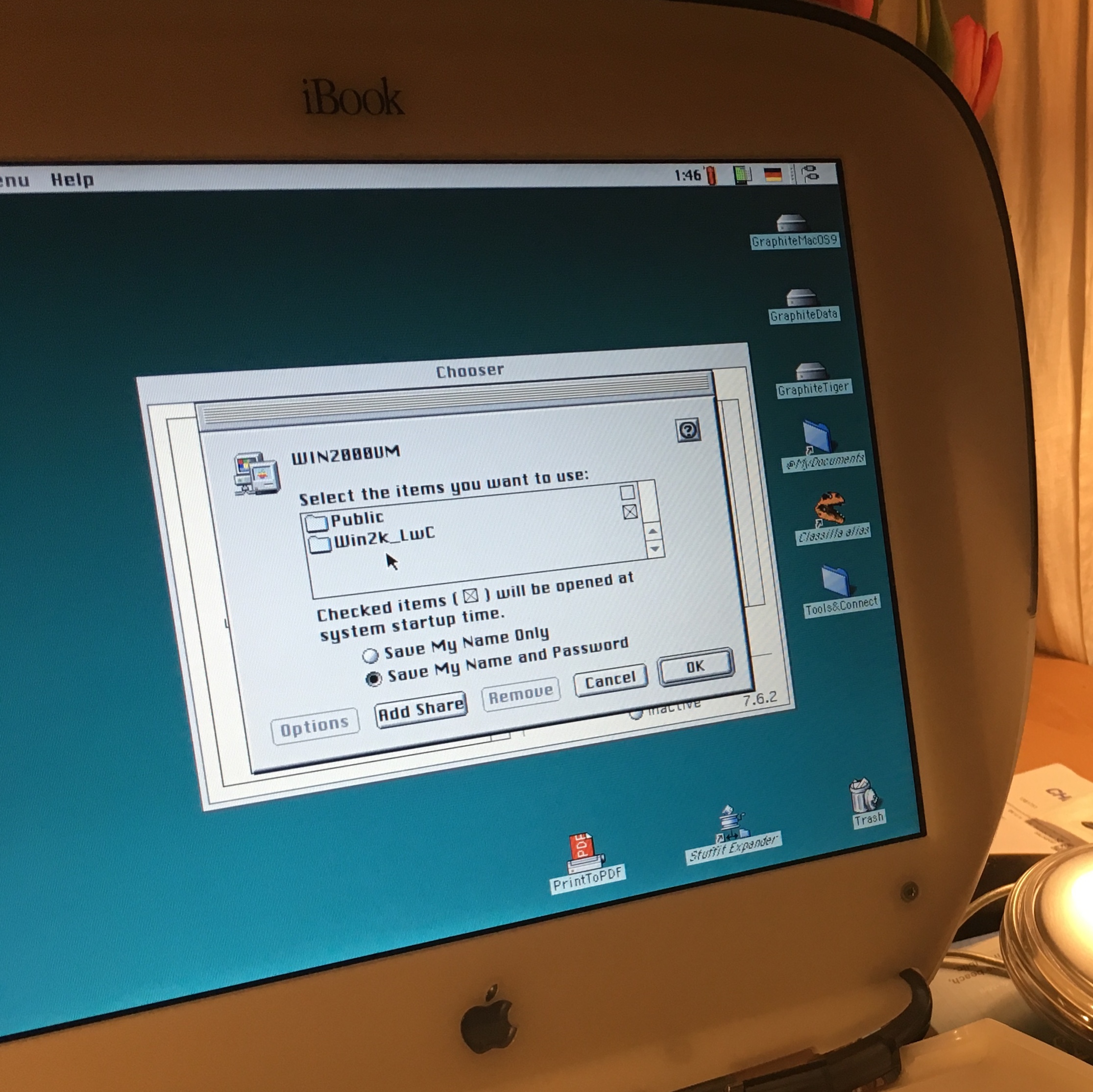

Update:

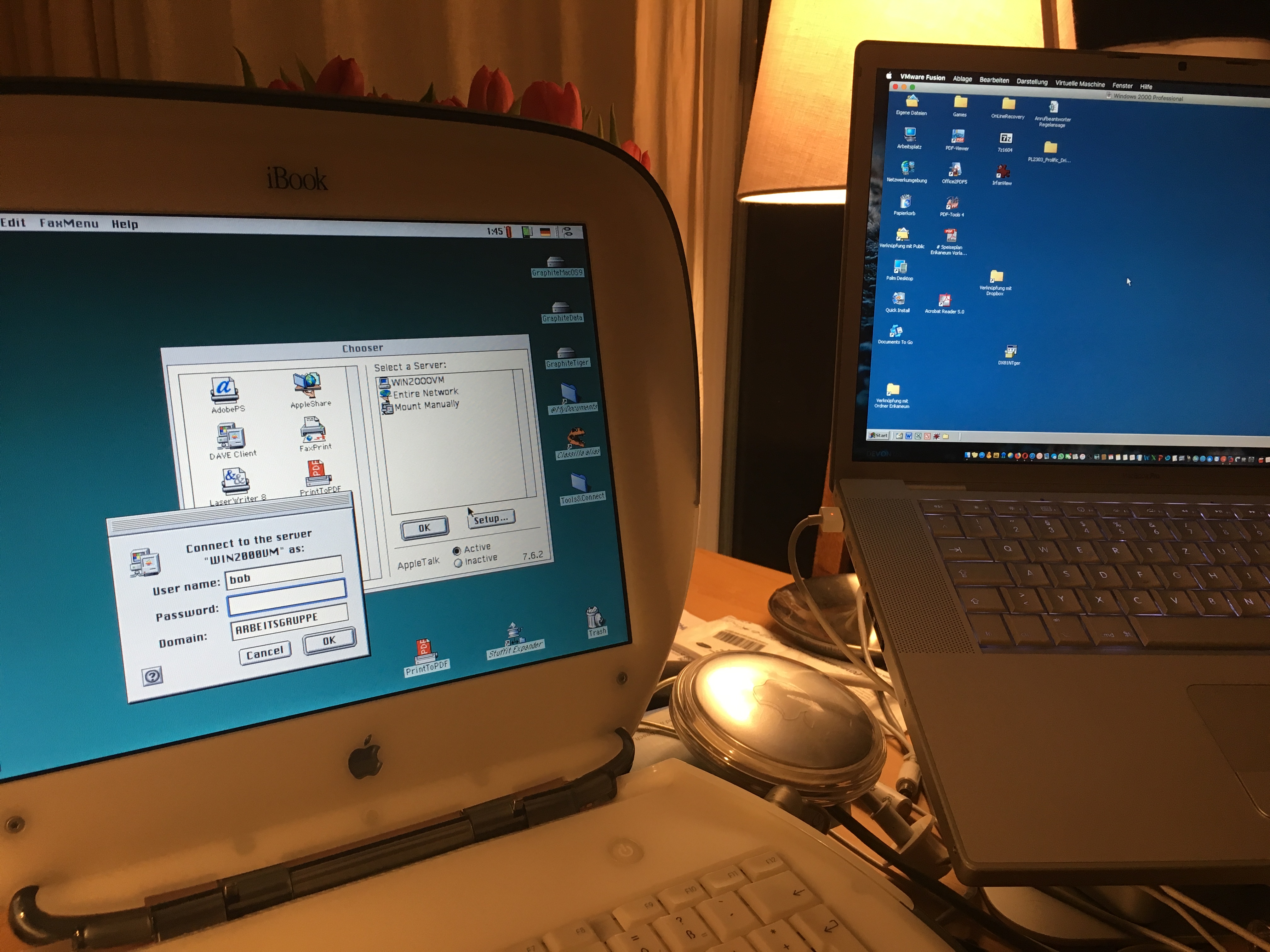

Made proper corrections for the "Workgroup" settings within DAVE.
Started "Win2k" with VMware-Fusion on my MBP-A1260.

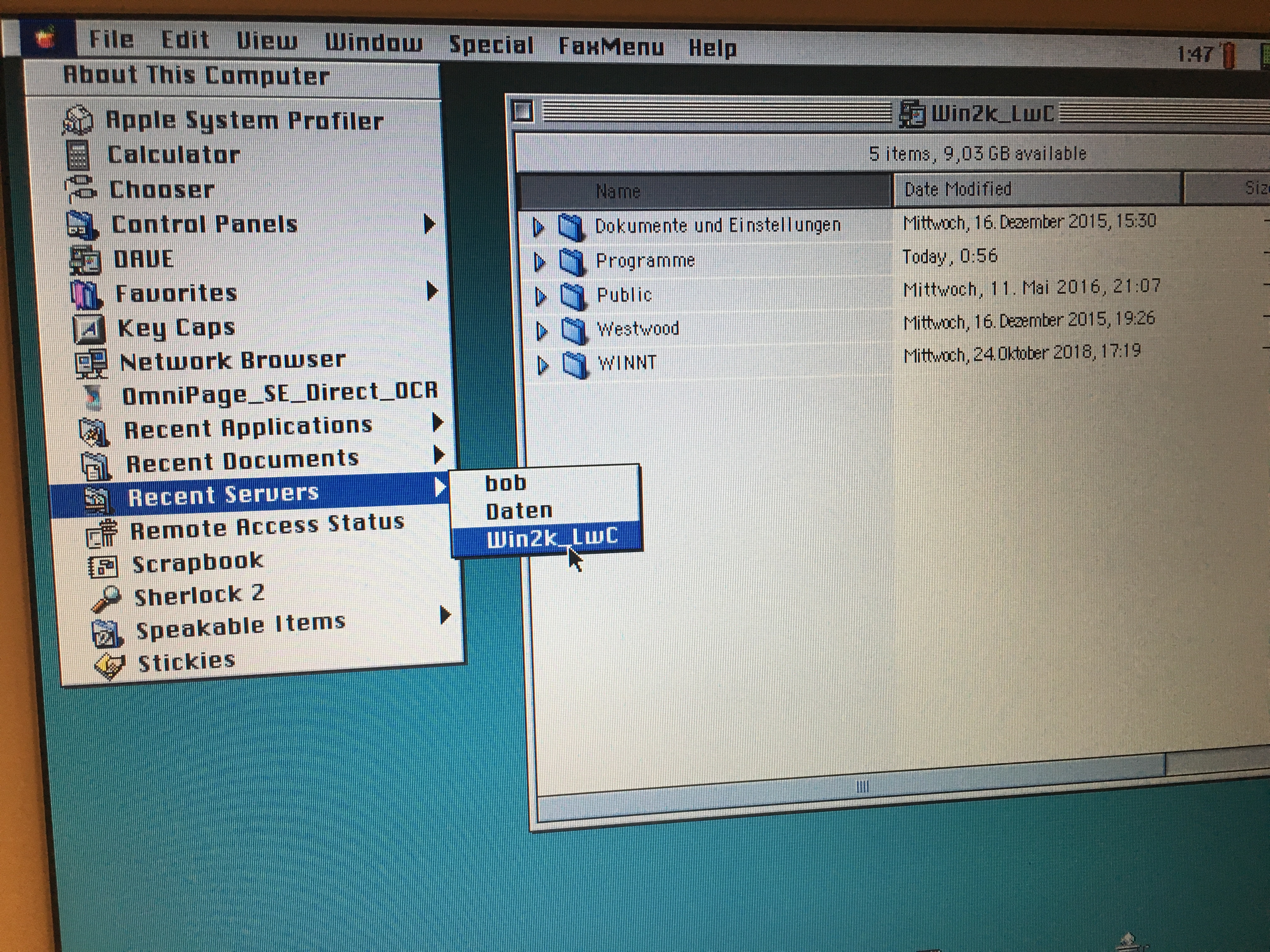

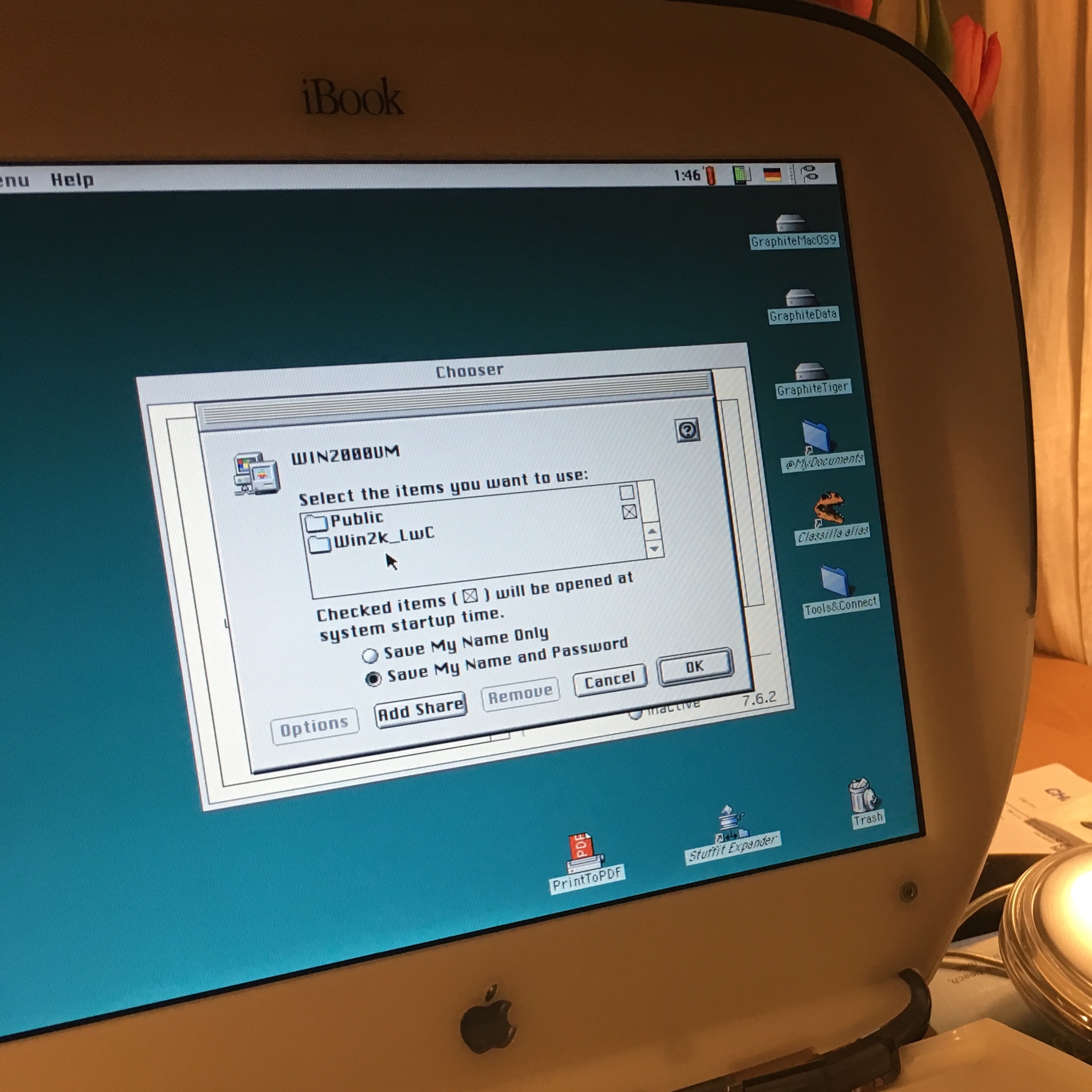

That virtual Win2k shows up in my os9/chooser/DAVE-panel and is fully accessable,
But trials to get access to the Macs filesystem via the virtual-Win2k connection failed, since I cannot share those folders outside of the virtual machine.

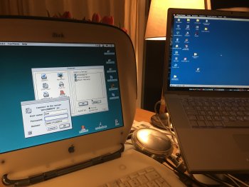

Still no way to get direct access to the Mac via DAVE, but a progress anyway: I could make a VNC-connection to that MBP/ElCap, move files from the Dropbox-folder into the virtual machine via ScreenSharing, then access those files via DAVE on my os9 device. (Well - only prove of concept ... - the mission is, to link os9 directly to a synched Dropbox-folder. Gonna check virtual Win7pro )
6B86AD33-2240-45EB-A4D8-BABF69961431.jpeg 396011C4-7E65-4378-BA11-0CFA9168B52D.jpeg 72A3B246-F71C-4872-A973-404BB716A02A.jpeg

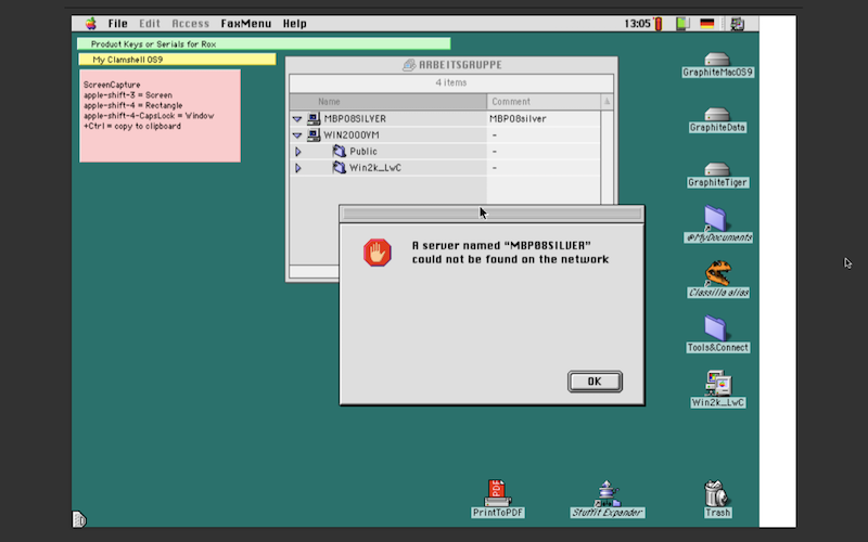

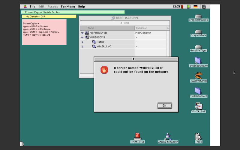

Update: another step forward
Found this article about connecting OSX/Win with SAMBA (https://computers.tutsplus.com/tuto...n-smb-server-in-os-x-and-windows-8--mac-46276)
Realized, that I had to setup correct WORKGROUP-name within the SystemSettings/Network/WINS-panel.
After this, I'm able to view both my "Win2k-VM"-shared folders and my MBP-A1260/ElCap with in DAVE's network browser, but I'm still unable to connect with the MBP ...
