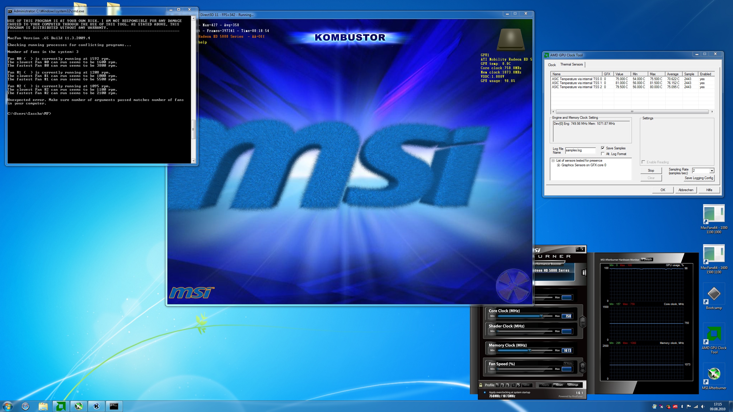

No way to monitor. I've just tested the OC config without any modifications in fan speeds. They are audible, but really really low. Temps did not went higher than 80.5°c while playing PES2010 for 10 minutes.
After playing the MacFan readout for the fans was 1341 / 1279 / 1600
Then, shoudn't u use 1600/1600/1800 in MacFan instead of 1800/1800/1600 ?
I think there was a typo - third readout was 1100. It's way lower than the other two.
Here's more: I've run into a few problems that seem to be linked to voltage issues. Splinter Cell Conviction and MW2 - again. Going down to 750/1073 might have fixed that.
Btw - temperature-wise, going from stock fan speeds to little higher speeds of 1600 / 1200 / 1100 will result in a 4-6°c cooler readout, at least in my environment (it's warm right now).
Please note that MacFanx64 doesn't seem to be reading the fan speeds out correctly all the time or it doesn't set them right. I get a lot of error messages momentarily. And no, I can't be bothered to do my tests more scientifically 😎
