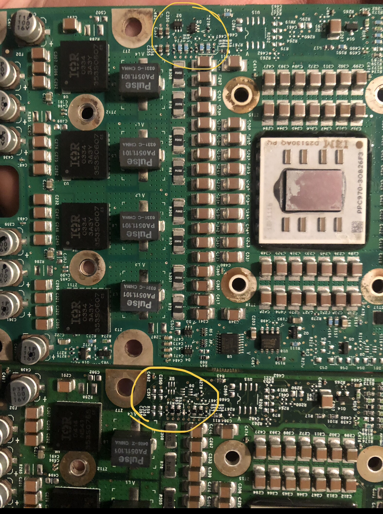

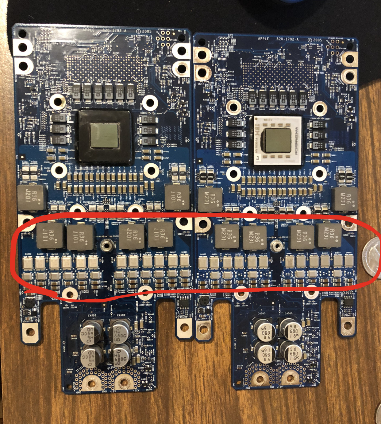

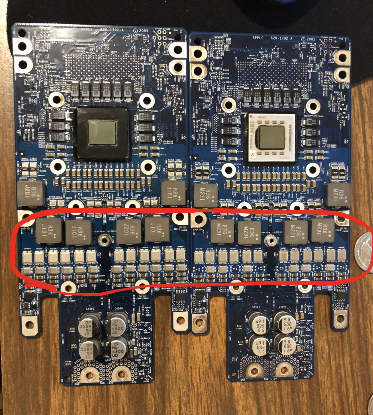

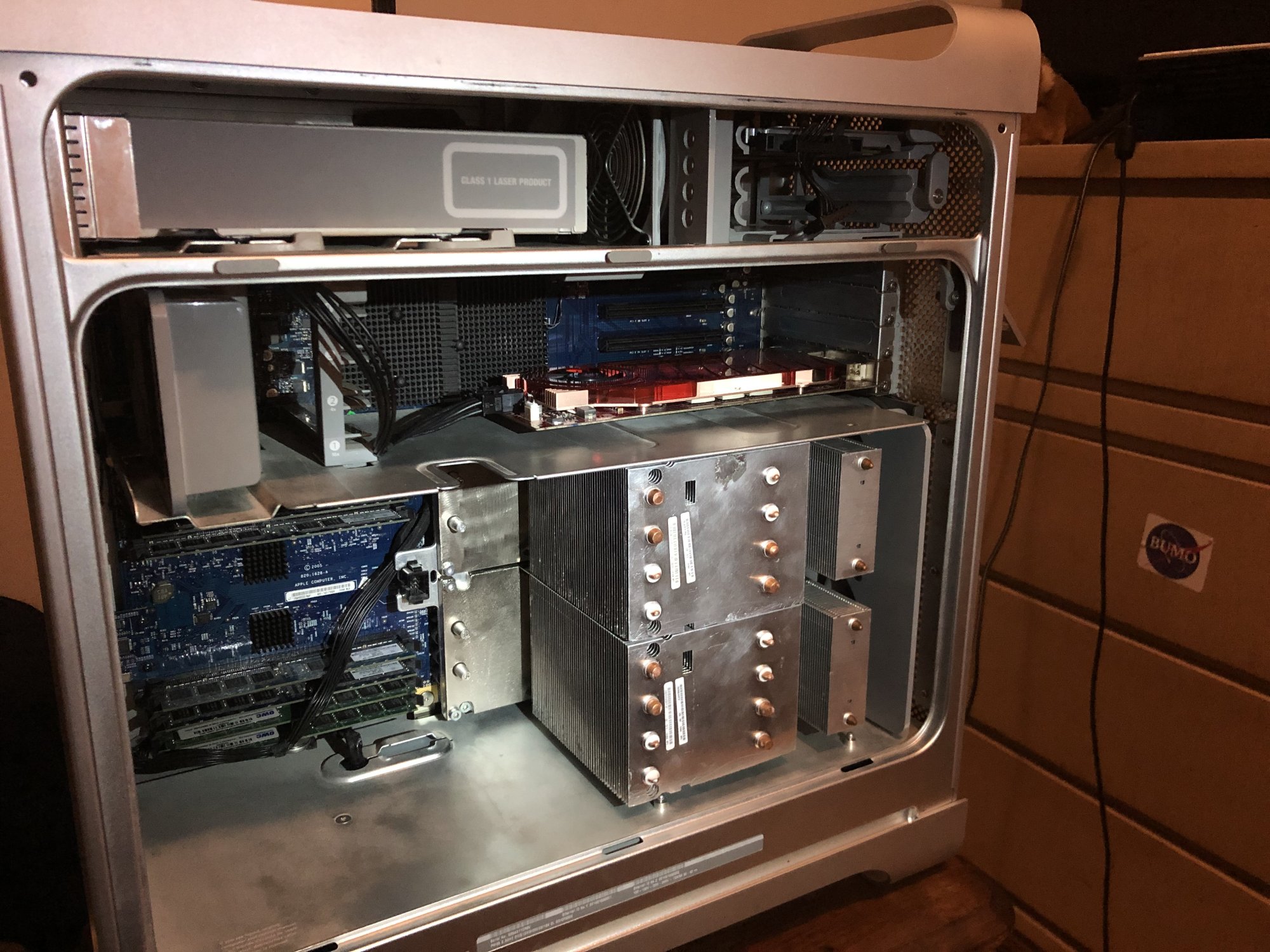

I can share some of my information on this topic. I have a 1.8ghz single 970 powermac that I upgraded to a 2 ghz 970 cpu. I compared them and noticed some chips missing on the 2ghz that are present on the 1.8ghz.
The backside of the cards were identical. The machine ran at 2ghz and upped the bus speed to 1ghz from 900mhz. The fans screamed so I ran AHT and calibrated it. Ran nice and quiet after. I have a g5 quad that I built and air cooled. I cut down 2.3 ghz dual core heat sinks to fit. I obtained a lot of different CPUs and examined them as well and I noticed similar to what I show above.
The left is a 2.5ghz 970mp the right is a 2.3ghz. I also had a 2.0ghz 970mp and that was the same as the 2.3ghz. These chips which appear to be vrm related are less on the lower clocked cpu. On 970mp powermacs you can swap around different CPUs and the fans run fine you can even run 1 cpu on a quad and it’s quiet the mother board just has a light on unless you thermally calibrate for just 1 cpu. the one cpu also has to be in slot A.
The air cooled quad is fantastic and very quiet. quieter than it was with liquid cooling. If stressed for a long period of time with a program called power fractal the temps will rise to a max of 71°c. It would be awesome if it would be possible to run it at 3ghz but I think a 500mhz increase would probably run too hot. I have seen liquid cooled models run at 81°c. I think all g5s are already maxed from the factory. They would probably need nitrogen cooling to go any higher 😂.
I can share some of my information on this topic. I have a 1.8ghz single 970 powermac that I upgraded to a 2 ghz 970 cpu. I compared them and noticed some chips missing on the 2ghz that are present on the 1.8ghz.View attachment 2109881
The backside of the cards were identical. The machine ran at 2ghz and upped the bus speed to 1ghz from 900mhz. The fans screamed so I ran AHT and calibrated it. Ran nice and quiet after. I have a g5 quad that I built and air cooled. I cut down 2.3 ghz dual core heat sinks to fit. I obtained a lot of different CPUs and examined them as well and I noticed similar to what I show above. View attachment 2109884
The left is a 2.5ghz 970mp the right is a 2.3ghz. I also had a 2.0ghz 970mp and that was the same as the 2.3ghz. These chips which appear to be vrm related are less on the lower clocked cpu. On 970mp powermacs you can swap around different CPUs and the fans run fine you can even run 1 cpu on a quad and it’s quiet the mother board just has a light on unless you thermally calibrate for just 1 cpu. the one cpu also has to be in slot A. View attachment 2109886
Fabulous, these could actually control the voltage to the FSB or the CPU or something else.

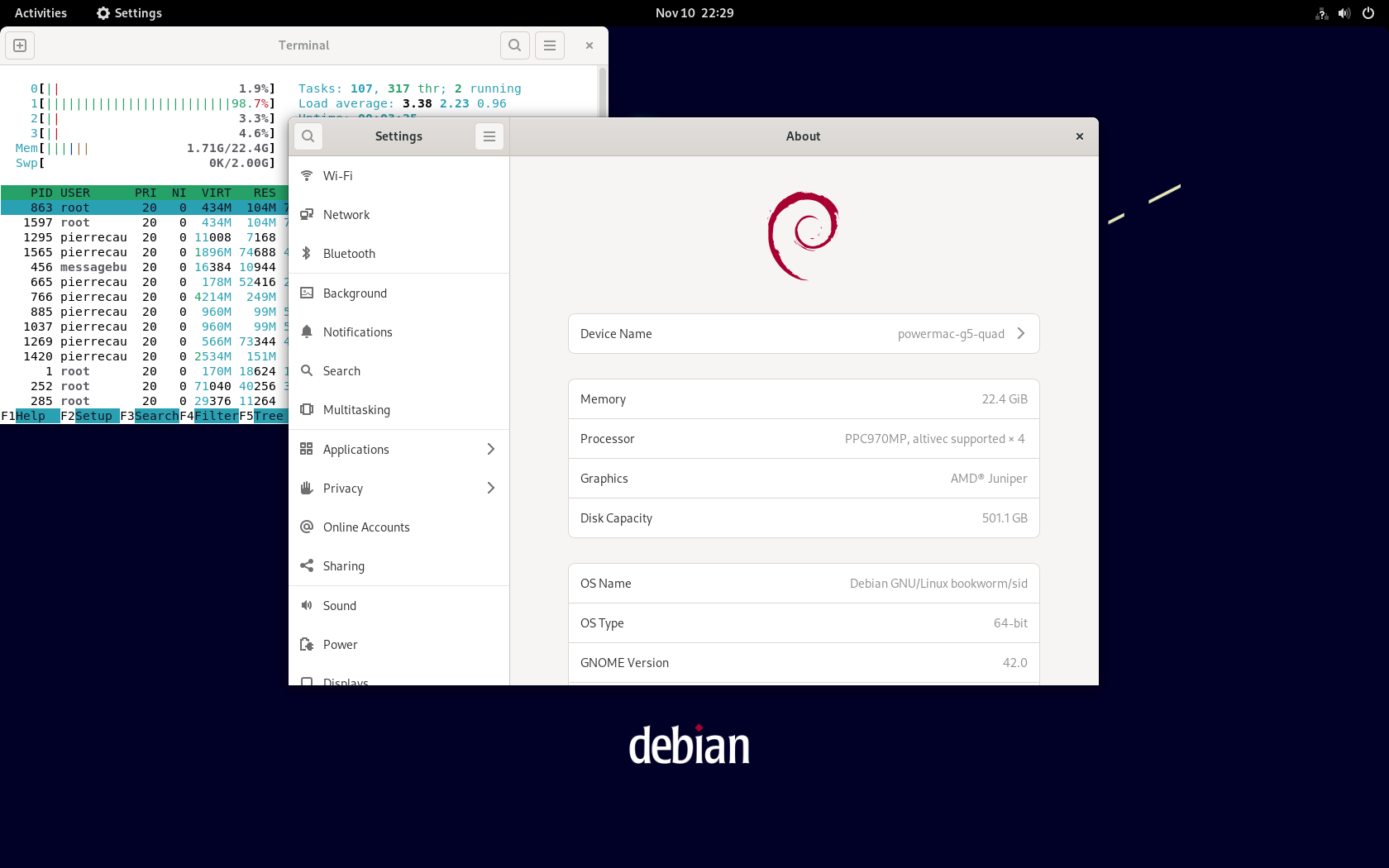

I think I've some sort of success unless - like the linux is doing some smart things under the hood - I crashed the 4GB barrier of 1 GB DDR2 sticks (and it hasn't crashed - I'm still compiling Webkit-gtk on gentoo (which before on 8GB ran out of memory at some point with -j4(using all 4 cores to compile))).
I have the following combination - first 4 slots (on both sides - DDR2 1GB Samsung) then on the other 4 slots on the rest sides DDR2 4 GB Samsung.
The command is:
dev /memory " "(0000000000000000400000000000000040000000400000000000000100000000400000000000000140000000400000000000000180000000F00000000000000280000000F00000000000000380000000F00000000000000480000000F0000000)" encode-bytes " reg" property
*It's only 18 GB - but it's fine for me at the moment - I just wanted to buy 4GB sticks wow.
EDIT: Yeah it's still running last was at more than 5 gb used (which means the 4GB stick are definitely working).
EDIT: Now I only hope my Geforce 6800 won't overheat (as it normally does under linux since I have not installed drivers for NVIDIA - I use Radeon second card normally for it) but if it does - I'll have a chance to cement the mod by adding a nvramrc function and then calling it as boot-command. And then I can also safely remove it ( I need it only for OF).

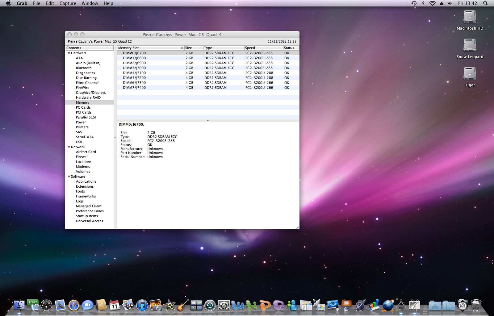

Thanks a lot for that, I confirm success with 4x2Gb PC-5300-E + 2x4Gb PC-5300-U (Crucial, Intel low density) + 2x4Gb PC-6400-U (Samsung, AMD high density)
I have tried with both
0000000000000000800000000000000080000000800000000000000100000000800000000000000180000000800000000000000280000000F00000000000000380000000F00000000000000480000000F00000000000000580000000F0000000
and
0000000000000000800000000000000080000000800000000000000100000000800000000000000180000000800000000000000280000000F00000000000000370000000F00000000000000460000000F00000000000000550000000F0000000
and I can get to the desktop, thanks a lot sasho648!

Aren't there reports of people upgrading their 2.0 DP to 2.3 (and I think even 2.5) air-cooled?
I do have a DP 2.0 and a set of 2.7Ghz CPUs, however those very likely need their LCS, is there any way to fit the LCS on air-cooled models? Or should I just chance it with the 2.0 heatsinks and fans?
I have not heard of anyone fitting LCS to these, but folk have put their own custom-built ones on.

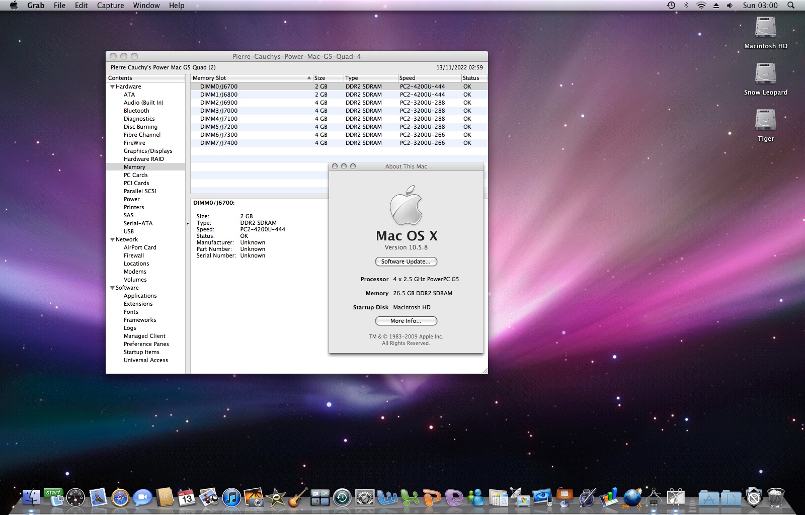

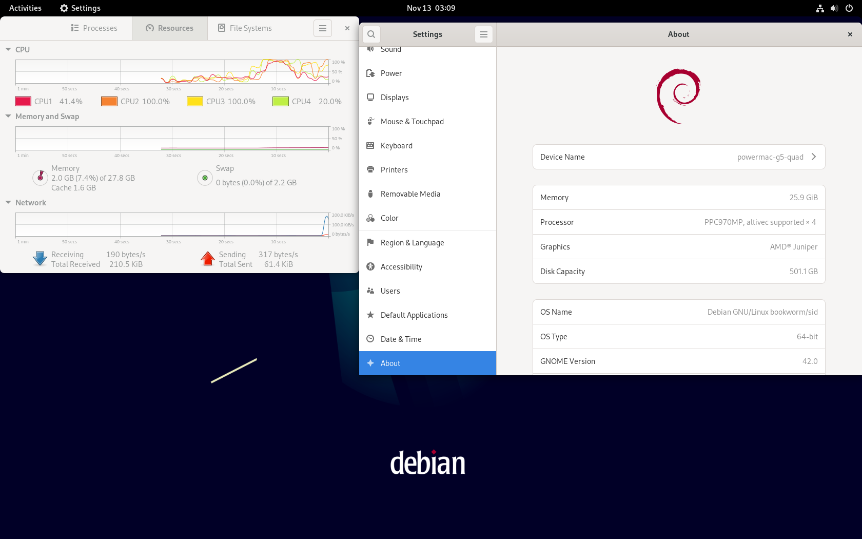

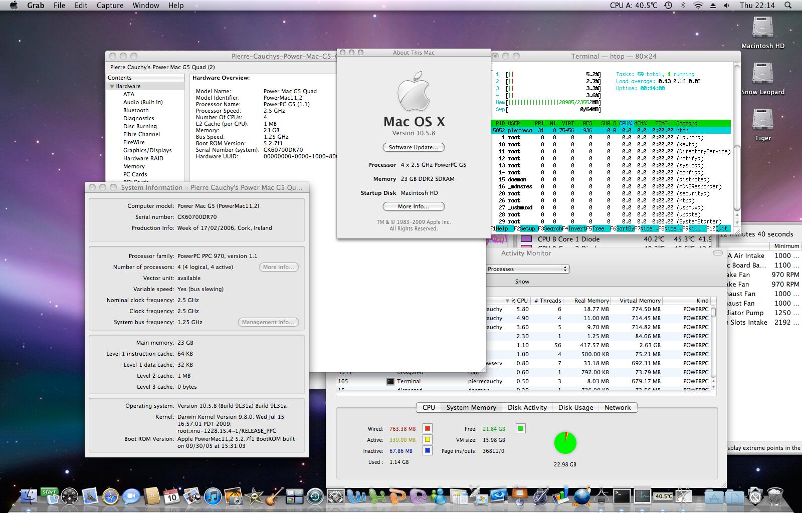

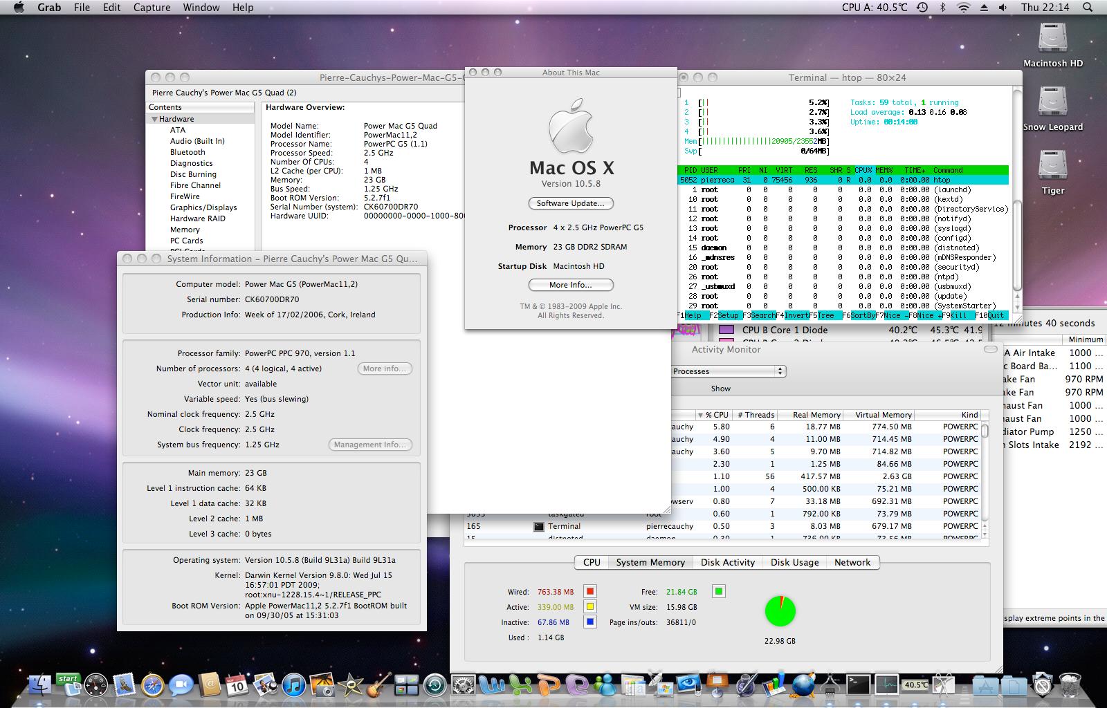

26.5Gb it is officially on the Powermac G5 Quad 😎
Strangely enough gnome-system-monitor does detect 27.8Gb but with 1.6Gb as cache
Trying to work out a way to have a 4Gb DIMM in the second slot to break the 30Gb barrier
Cheers,
EDIT: looks fully functional, I ran an R job (Seurat) using 16-20Gb and it completed successfully

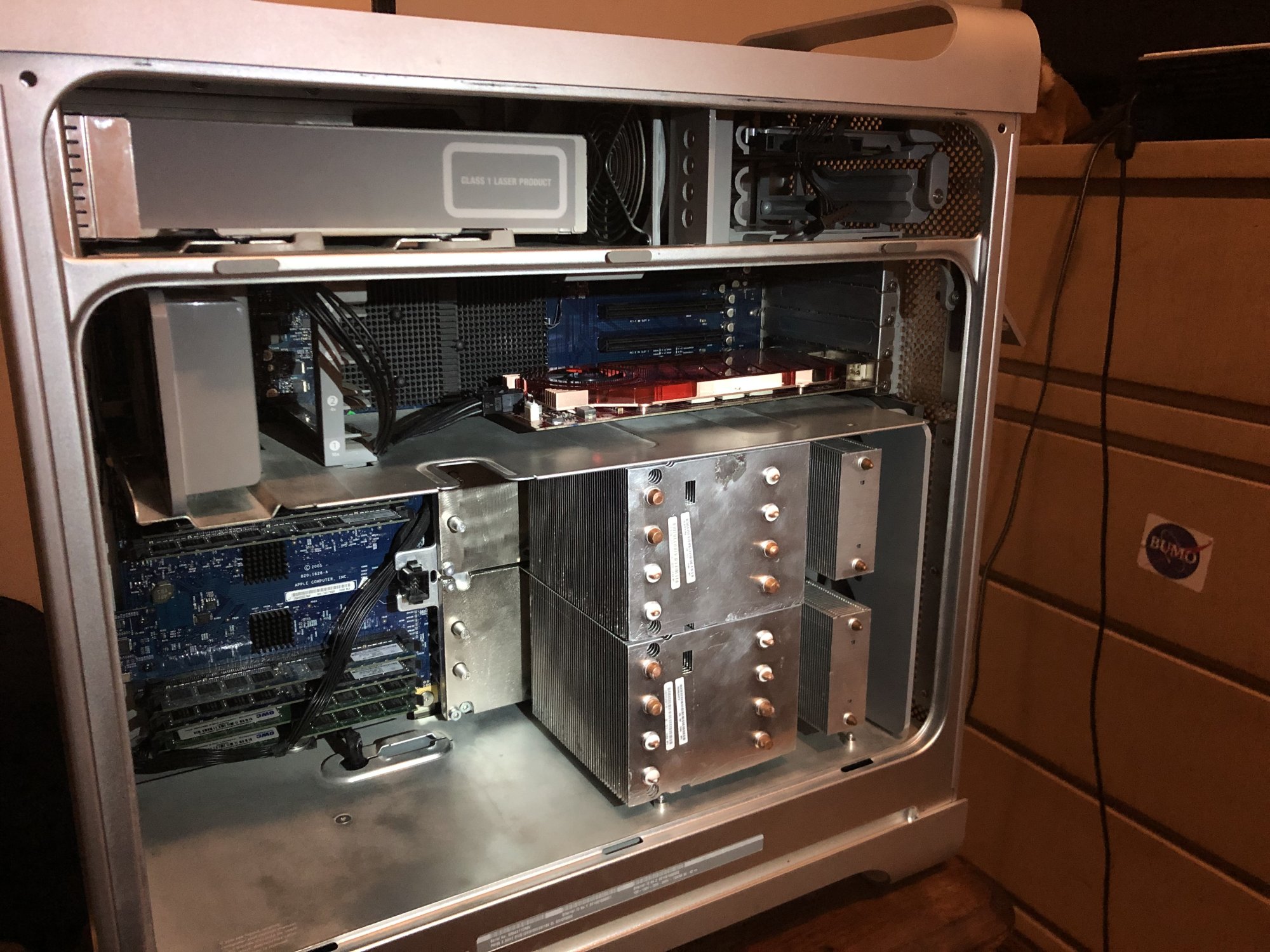

!IBM FAN ASSEMBLY 80MM FOR 8286 S824 PSERIES POWER8 PN: 00FV629
This is a big difference to the unit that Apple designed for the G5. How effective is this unit and what sort of temps are expected from it?
I reckon this is a heat sink and fan in a plastic box.

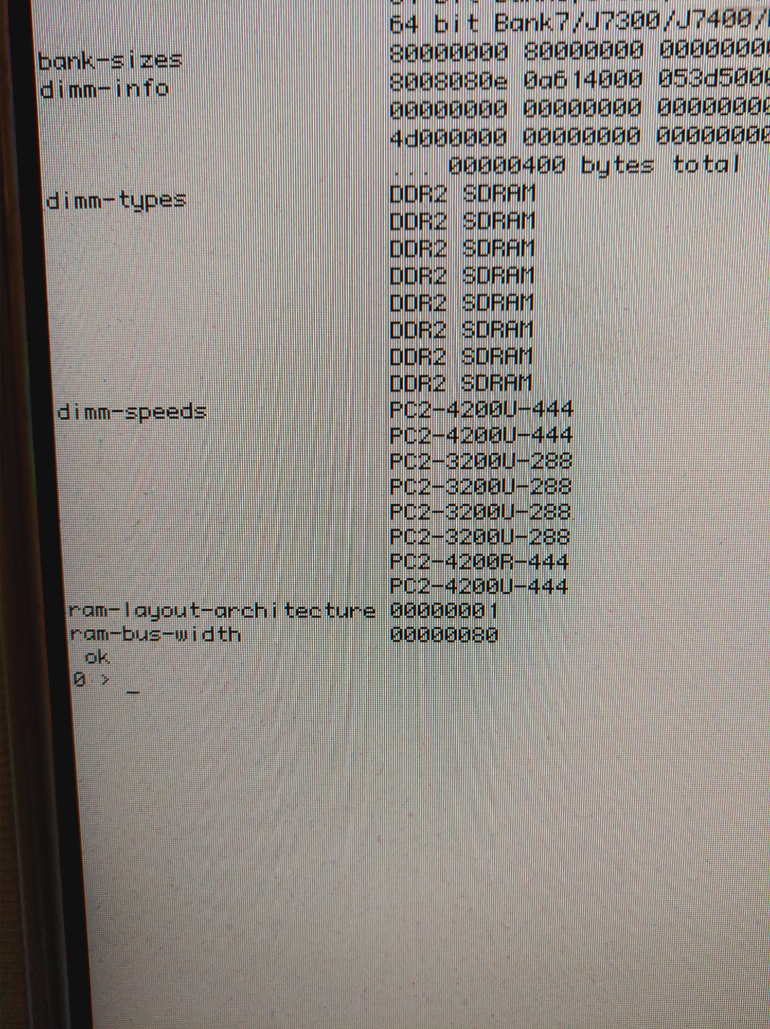

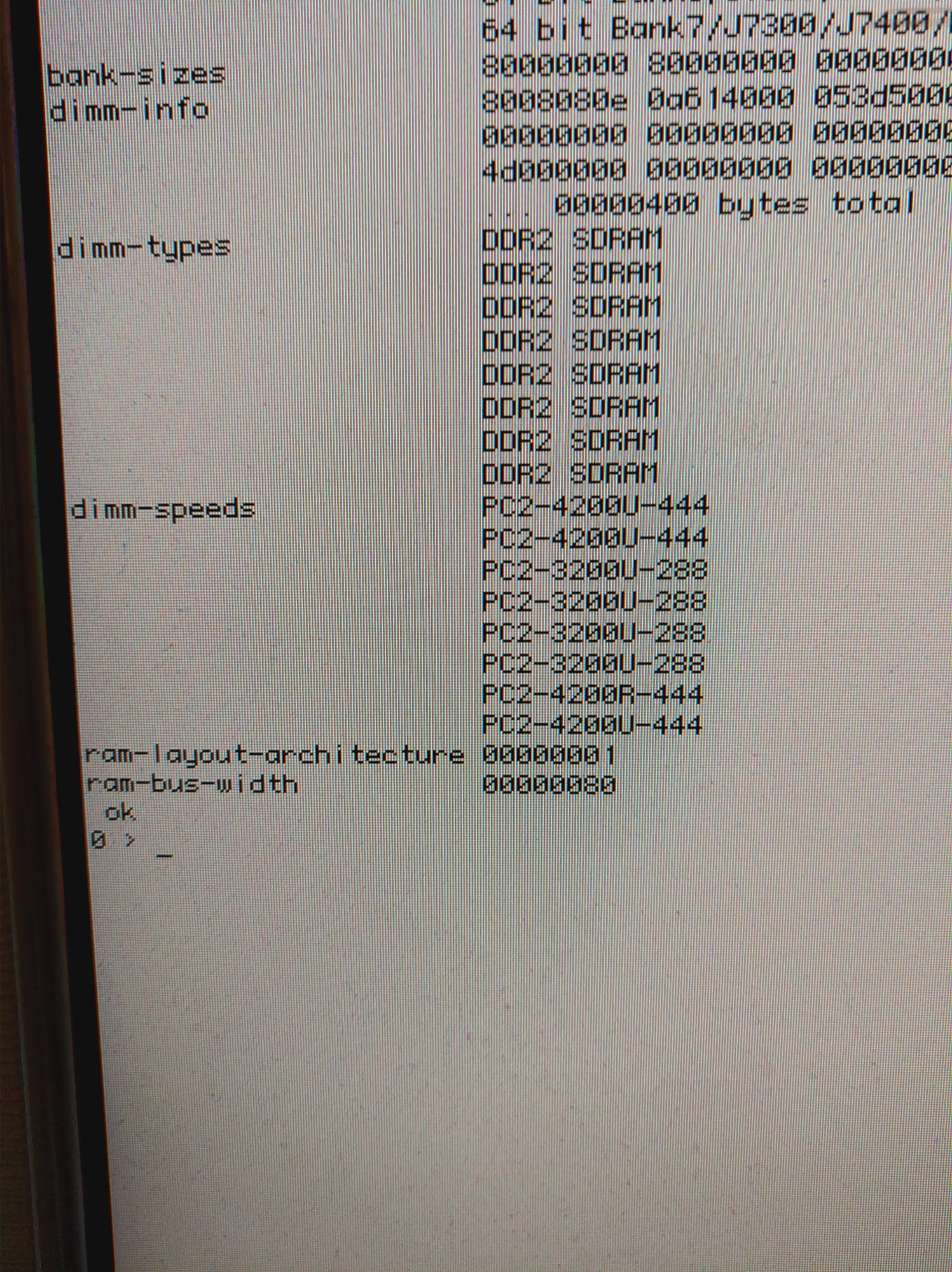

Just to show that PC2-4200-R modules can be detected (here with one only, second last), I only managed to have them working in pair once unless I'm mistaken, will keep trying. Haven't tried to allocate it yet though.
On that note, it could be that single-channel is needed for this, potentially needing to change ram-layout-architecture to 2 / ram-bus-width to 40?
