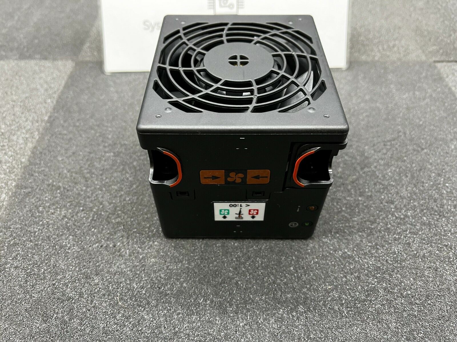

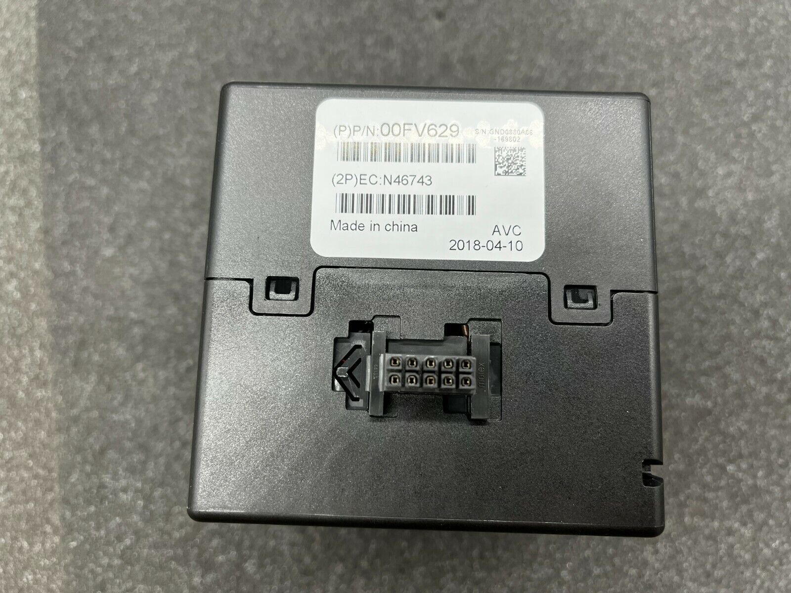

!IBM FAN ASSEMBLY 80MM FOR 8286 S824 PSERIES POWER8 PN: 00FV629
This is a big difference to the unit that Apple designed for the G5. How effective is this unit and what sort of temps are expected from it?
I reckon this is a heat sink and fan in a plastic box.
Looks bigger than the ones Power7 systems, e.g. on the Power7 770 the heatsinks are within the CPU drawer, so it could well be that this is indeed the case

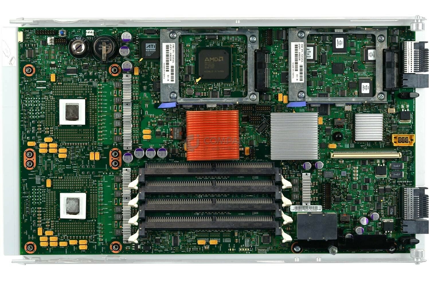

This is the IBM BladeCenter JS21 max speed 2.6Ghz to 2.7Ghz single core and 2.5Ghz dual core.
Amazingly it can only run 16gigs of ram
There must be similarities between this board and the daughterboard in the Mac Pro, If there is an Eeprom then IBM must also use one and possibly the same one.
I ran a power 8 server in my homelab for a bit(s822l), and trust me you don't want those fans. Even idling they are pretty loud, it has 2 fans in it and can move lots of air

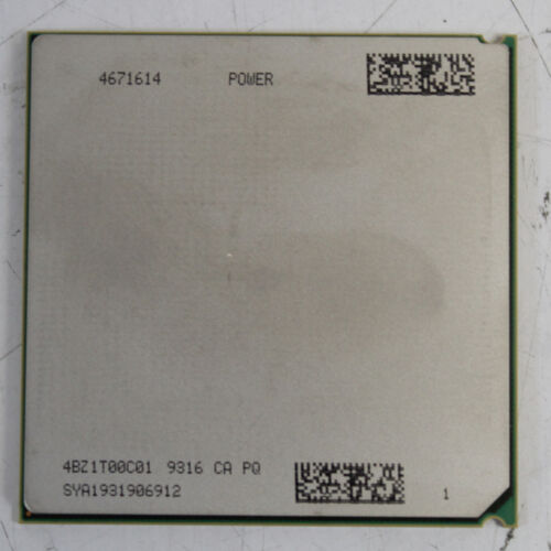

If you want I have a couple of Power7+ 4-core 3.8 GHz CPUs to donate (from a Power7 770 9117-MMD machine that was badly transported, the midplane has massively bent and missing pins and the CPU drawer connector is damaged beyond repair on the drawer side)
I do have another 9117-MMD that I am trying to get online, the FSP works but for some reason I can't get the CPU drawer recognised and bootup fails with a resource not available BXXXXXX error code, possibly also slightly damaged midplane, I need to take it out and straighten whatever is slightly bent there
