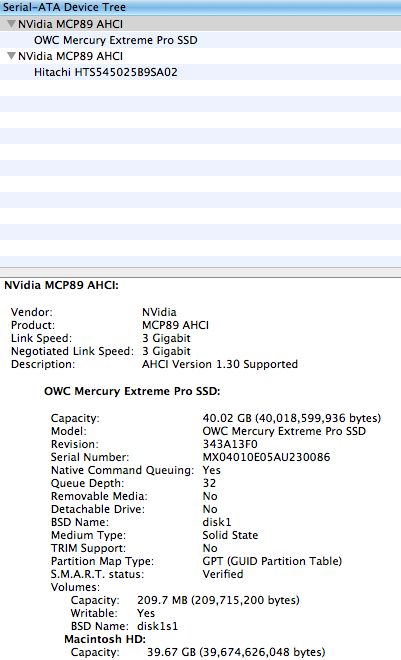

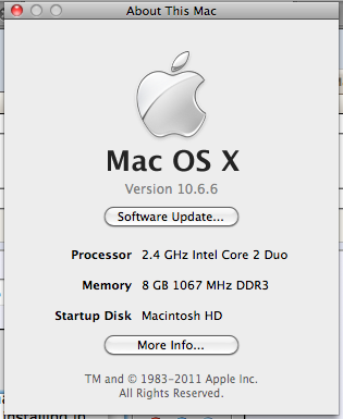

MacBook Pro 13.3" model 7,1 + OWC SSD 40GB
Hello,
Just replaced my stock HDD ( 250 GB ) with OWC SSD 40 GB one. Stock one, i placed in Data Doubler, also from OWC. Before placing stock hdd in data doubler, ofcourse, I installed from DVD , Mac OS X 10.6.3, formatted SSD to Mac OS Extended (Journaled), after that, I turned my Mac off, and replaced DVD/CD Rom with Data Doubler, on which i put stock HDD ( 250 GB ). I turned on my PC, formatted second HDD ( stock one ) to Mac OS Extended (Journaled) too. After that, I have done upgrades, to 10.6.6.
My problem is that in normal work, surfing trough firefox, skype and so on, somehow Mac start to be unresponsive for at least 10-15 sec, and this is happening randomly, even durring I am writting this post.
While the Mac is un-responsive , i can see marble of doom (
) which is spinning.
After 10-15 sec, Mac is responsive, and I can continue doing stuffs....
Also I attached to this post Info about Mac, and Info about S-ATA....
If anybody can help, I would appreciate it.
Many thanks to everybody.
