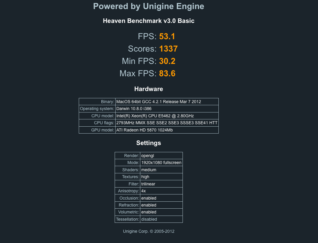

I have a MP 3,1 bench but it is Heaven 3.0 not current; you would need the earlier version to compare:

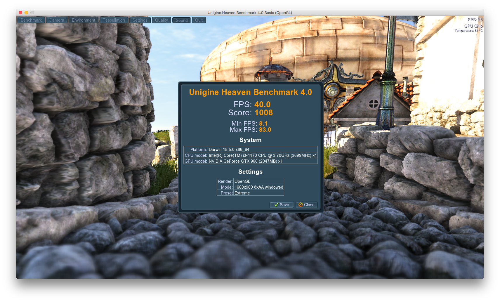

View attachment 634572 There's my passive 960 2GB paired with an i3 it should be close to a 3,1
Won't be close. 3,1 has about a half of single threaded performance of i3 4170 and this is what affects overall score in Heaven/Valley.

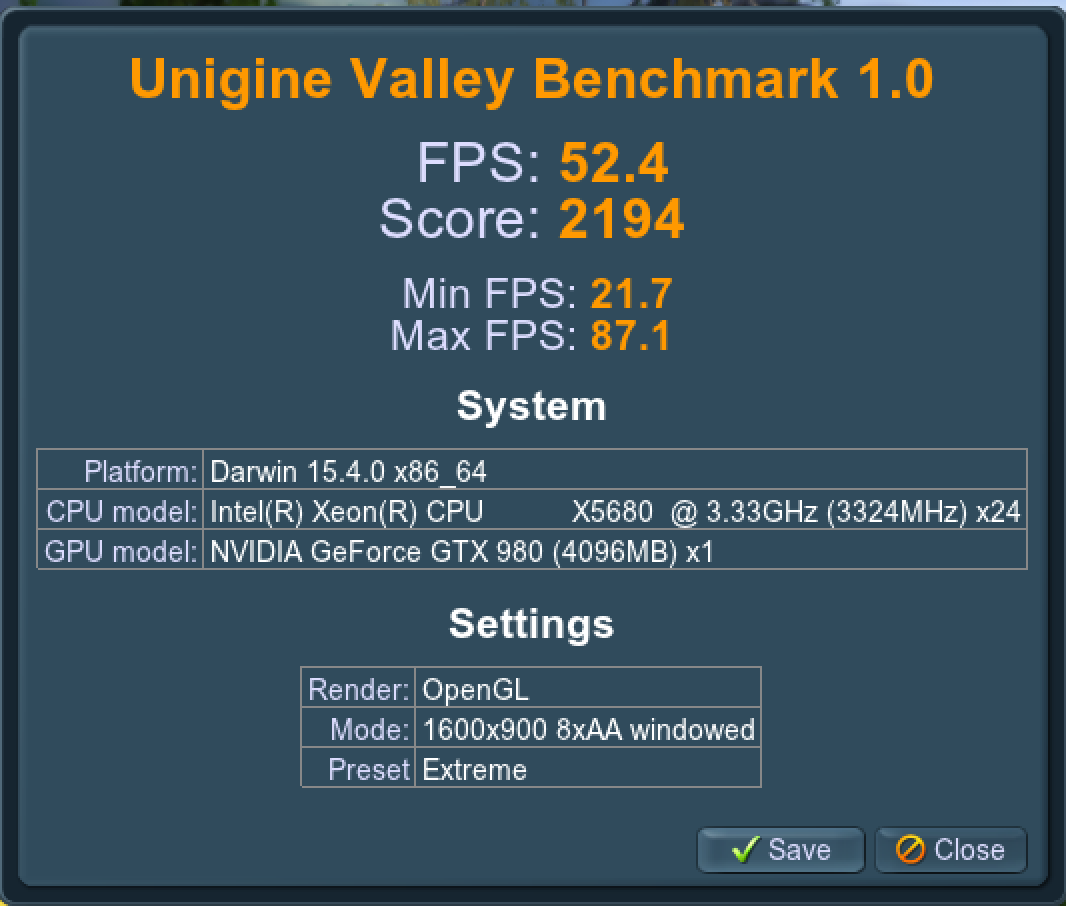

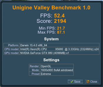

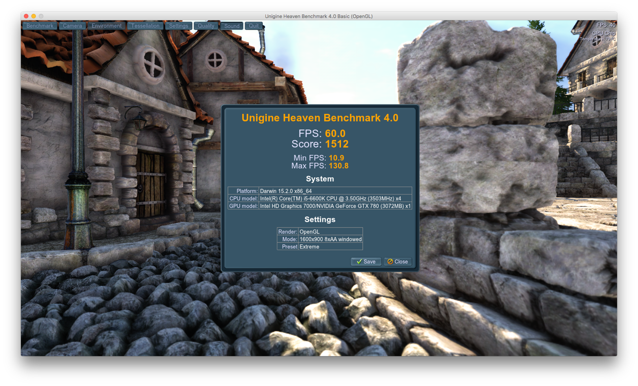

I'm getting slightly better results with 5677 and GTX 780 than pastrychef with his 5680s and GTX 980. Same OS and same presets in above benchmarks.

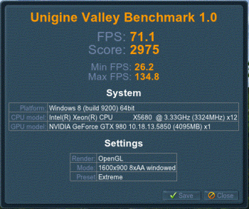

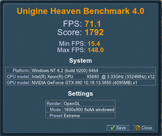

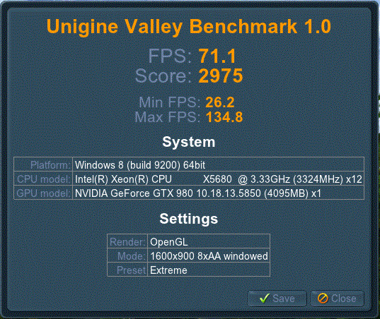

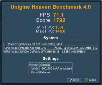

"Here are results from Windows 10 OpenGL. Same machine I used for above benchmarks."
Thanks Pastry, that shows a real difference a driver makes. About 20 average fps gained from Windows OpenGL drivers alone. Can you do DirectX ones too please?

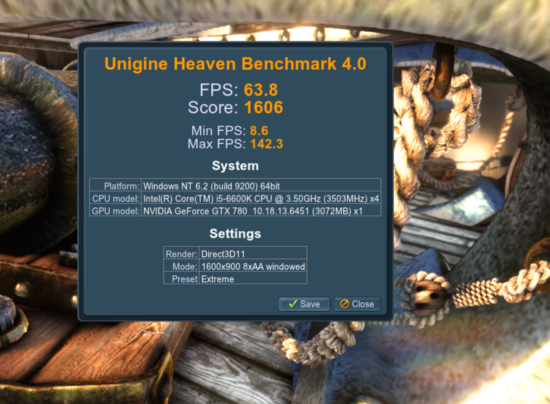

Different machine with different GPU, but I uploaded Heaven benchmarks (El Capitan OpenGL vs. Win 10 DirectX) in this thread yesterday: https://forums.macrumors.com/threads/the-ultra-settings-thread.1974637/#post-22983396
Both benchmarks were done in Ultra@1440p. Difference is a measurable 12% (=3FPS in my case), nothing I'd care about.
With Extreme preset it's even less than that: 60 FPS vs. 63.8 FPS (~ 6%)
