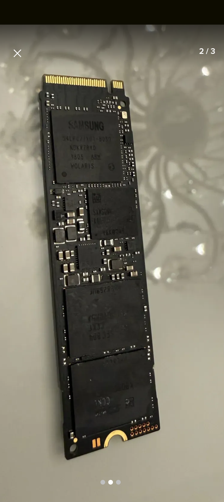

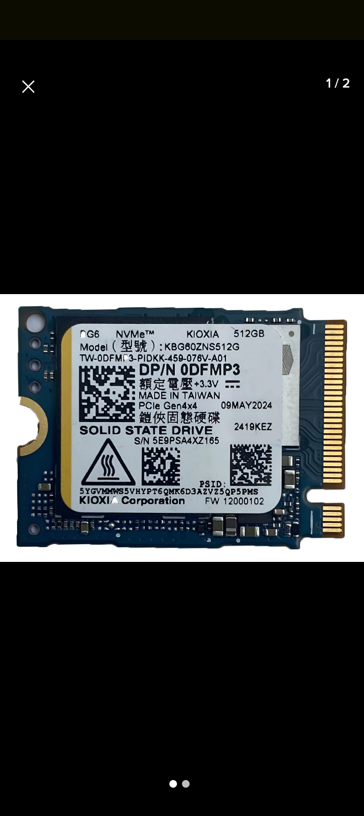

Ok, now i found two more units, the two are listed as good on the first post, but both disks has some other info on their Labels, so i Will add that info plus pictures of each one...
Samsung 960 evo 500gb (mzv6e500)
Toshiba Kioxia XG6 (kbg60zns512)
Are both good for booting Monterey on a MP5.1? Are both good as Scratch disk for Reaper active Projects? Is one better than te other for booting or scratching?
The Samsung is used but the Kioxia is new and i could bought two of them If they are the right ones

Ok, now i found two more units, the two are listed as good on the first post, but both disks has some other info on their Labels, so i Will add that info of each one...
The Toshiba is the wrong one, the seller confirmed he published the product with the wrong name...
