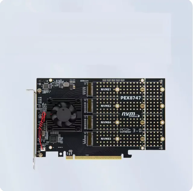

Has anyone tried one of the PLX8747-based boards which look like this one on AliExpress (the x16 version)? These are considerably cheaper than HighPoint lookalikes despite using the same chip, but I wonder if there are any compatibility pitfalls, with Mac Pro 5,1 in particular.
apparently works
apparently works
Yes, but that board has a different layout similar to HighPoint products (PLX chip closer to the tail of the PCB). On the one I'm curious about, the PLX chip sits closer to the mounting bracket, and it's ~30% cheaper for some reason.
