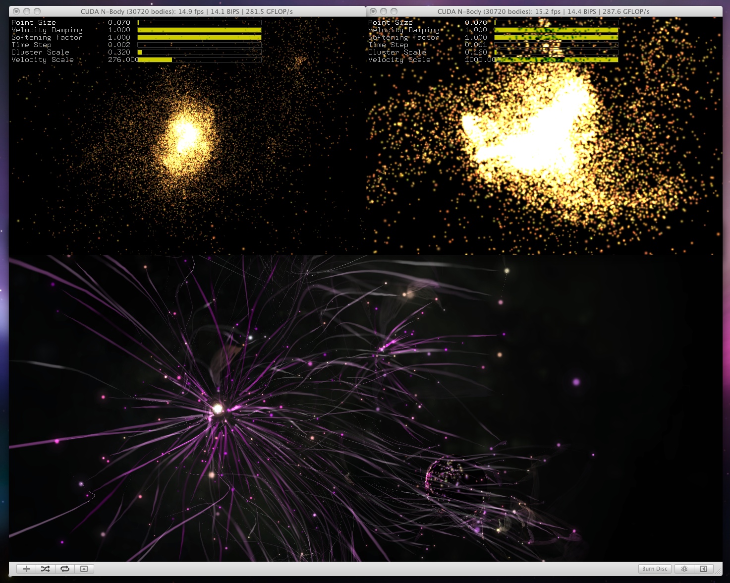

I ran 2 instances of the nbody CUDA demo simultaneously as such:
./nbody --device=0 & This will utilize the first GPU
./nbody --device=1 & This runs on the 2nd GPU
Afterwards, I ran iTunes with the visualizer enabled inside the window.
This is where I witnessed the fluidness of Leopard's OS (possibly the kernel) when moving windows around, minimizing and resizing. It remained fluid. The interactivity of the OS shined.
Now, I did the same test under Windows 7 and SUSE Linux 11.1. The fluidness is not quite there. Kudos to Apple for it's amazing OS. Kudos to BSD. Kudos to all the amazing folks who made Leopard what it is today.
The power savings of utilizing one PCB versus 2 discrete cards installed in 2 slots is another plus. My system utilizes 150 watts in idled mode. With one GPU running nbody, the wattage goes up to about 280 and 350 when both GPUs are running nbody.
EVGA GTX 295 Co op Edition works
This is truly amazing to see 2 nbody demos running simultaneously from the single PCB edition containing 2 GPUs and computing near 650 GFLOP/s combined. All this utilizing 355 watts (not including the displays). The graphics card makes less noise than a busy Power G5 2.5 GHz.
Attaching the photo.
Technology has come a very long way since the Power G5 days.
Amazingly and very fluid Leopard OS in processing the interrupts for the underlying hardware. Attaching an image showing 2 nbody demos running -- note down to nearly 600 GFLOP/s and iTunes running in the background.
Enjoy.

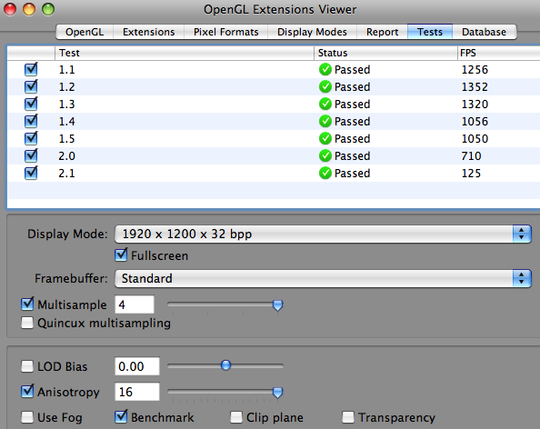

The results from OpenGL Extensions Viewer. I believe only one GPU is utilized for this unlike with CUDA both can be utilized simultaneously.
This is all fascinating. The OpenGL scores are weak but in all other respects this is amazing, especially now we see a boot card is not needed.

The slightly lower OpenGl numbers are in line with what could be predicted given numbers from 9800GX2 and a 4870x2. (slightly lower than base card)

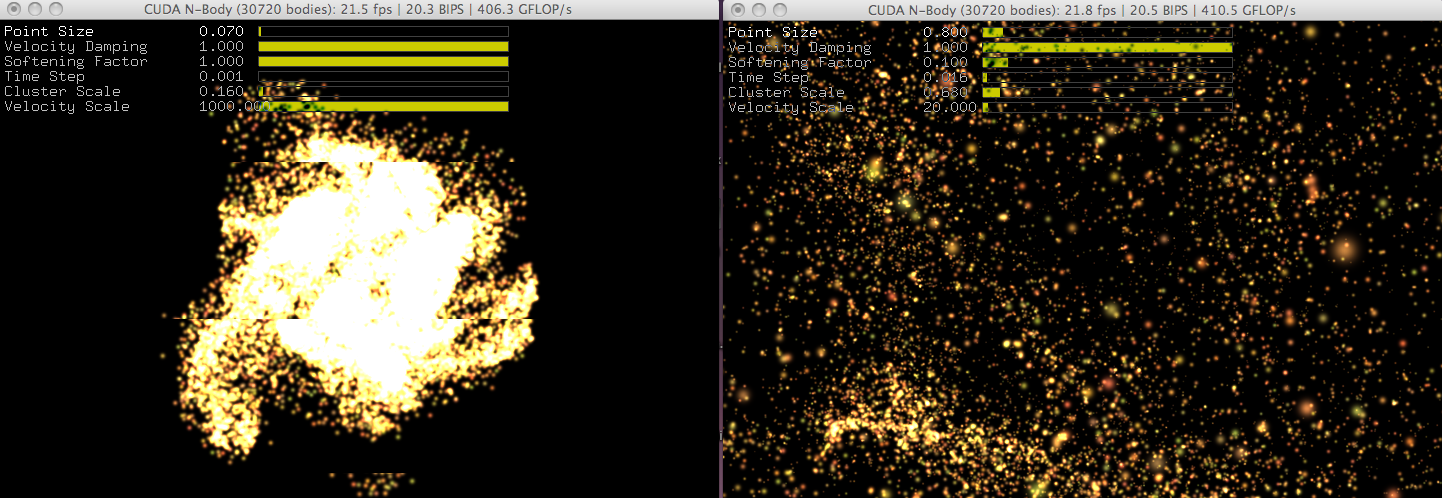

Rominator - I do not have those games - I just use these cards for CUDA apps and there the full 2G is recognized without difficulty in the calls to the card. The Hackintosh explains the boot success - thanks. For peak performance comparison against a pair of 285s, I just ran two lots of nbody targetting the separate GPUS as above, and this combo of a Mac 285 and a 2G PC 285 comes in at about 816 GFLOP/s, which is better than the 295, but obviously I had to spend rather more cash to get it. Shot attached (from Mac Pro 08, 8-core 2.8GHz)

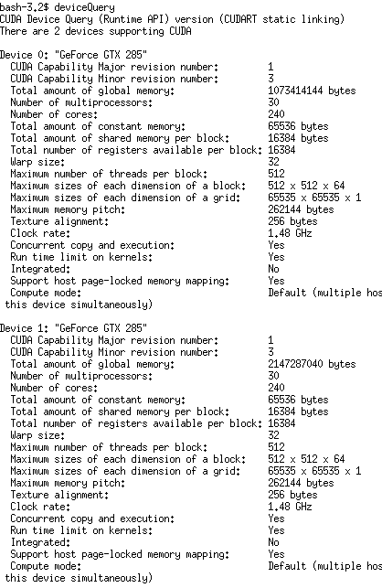

Here also is the result of CUDA deviceQuery and OpenGL EV for easy comparison with the new 295 results. EV is running off the Mac card. Note that the full (+)2G is recognized under CUDA on Device 1. I recall that when running EV off the PC card I got -2048M but all the tests worked with similar numbers. I am very impressed with the price/performance of the 295. To get the full 1.48GHz on the Mac card requires that a 3D app be up, as is the case here.

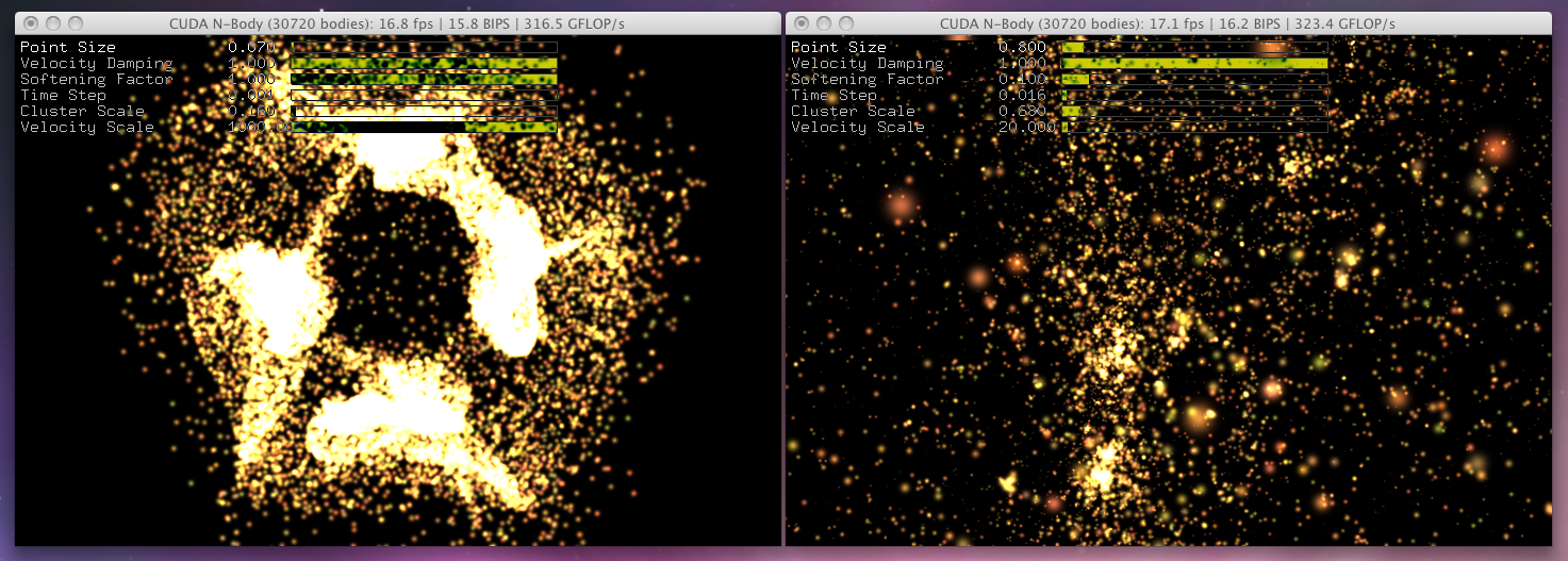

Edit: I just reran the twin nbody test on the 2X285 under XP32 under bootcamp. Despite being a mac fan I have to confess that (under CUDA 2.2, the Mac was 2.3) under Windows I was getting just over 900Gflop/s. I am not sure what to make of the difference.
