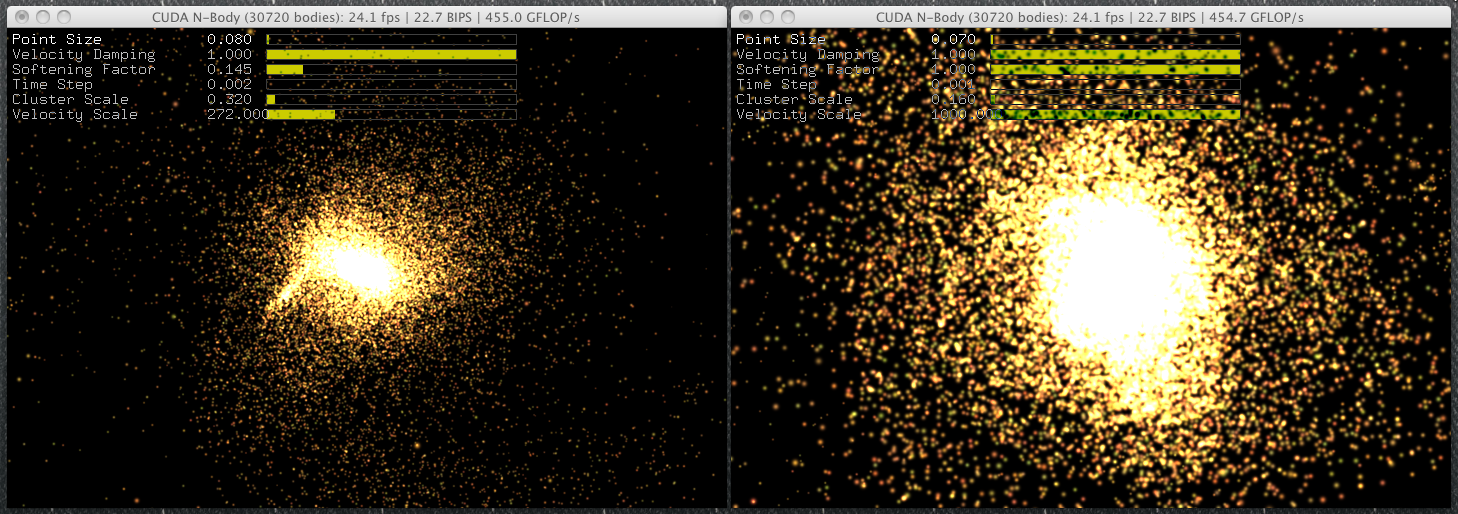

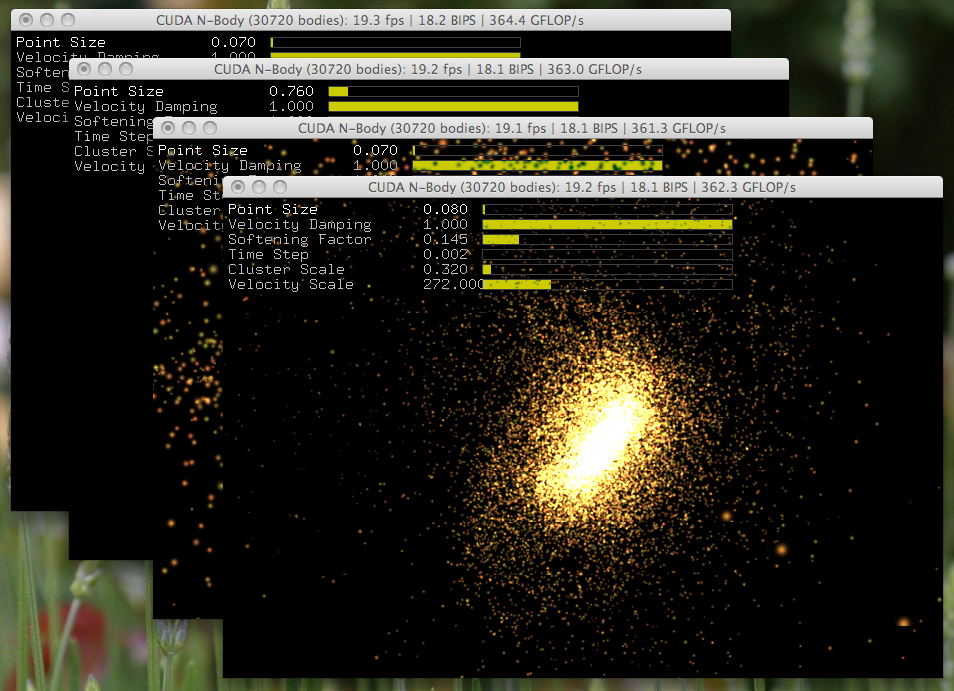

CUDA N-Body Dual GTX 295 (4 GPUs) under Leopard 10.5.8
1451 Combined GFLOP/s. This requires 600 watts of power consumption (not counting the display). The power includes the 4 busy CPU cores -- each at about 90%. The system is still responsive. I wrote about enabling the GTX 295 card via EFI string in the boot plist file this past weekend on insanelymac.
When idled, the system requires 153 watts.

Fantastic numbers mroy - thanks for this. Now feeling underpowered with only a pair of 285s at home! I also get about 80k options per second per GPU. One 285 does >100k ops.
