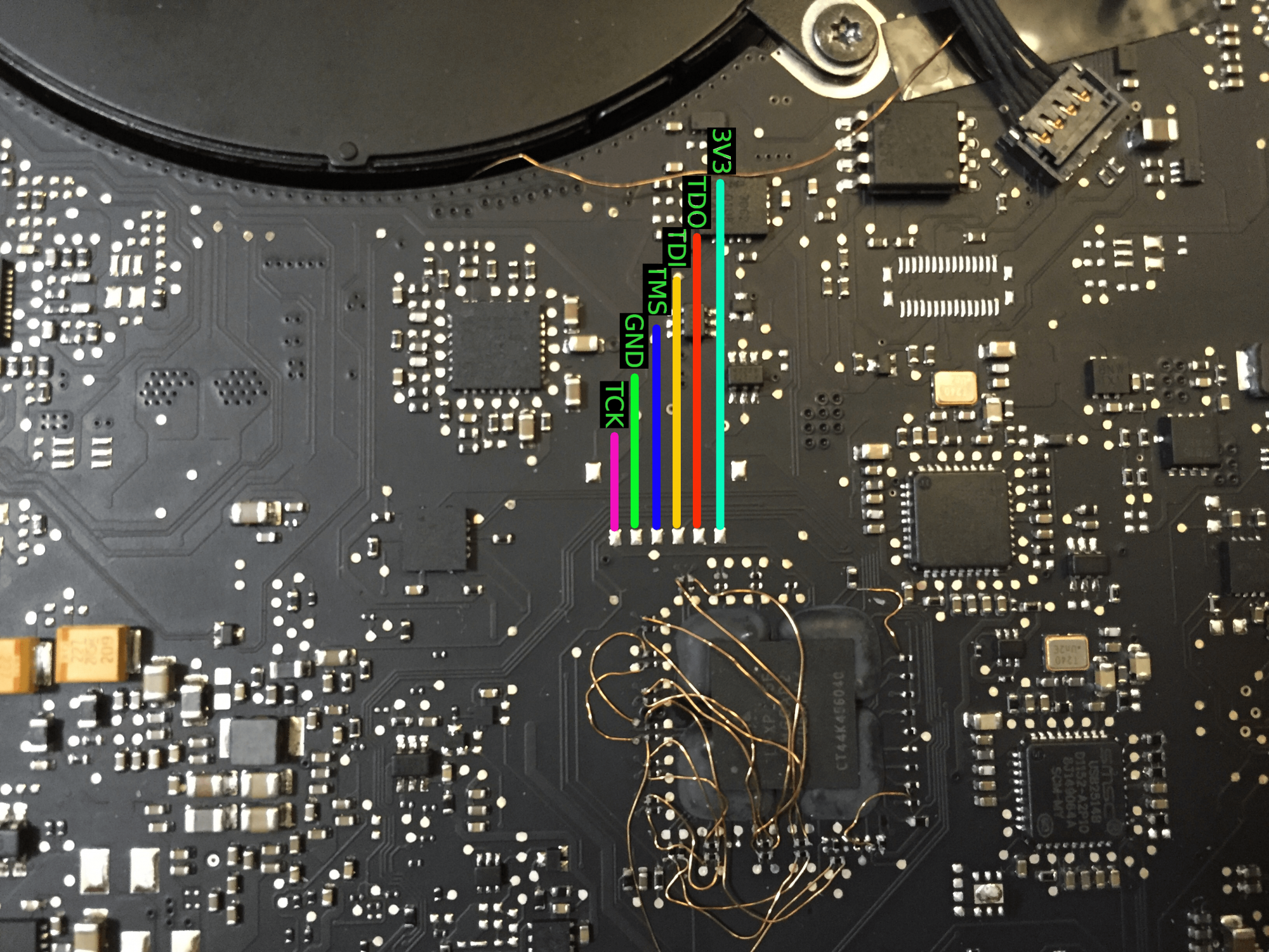

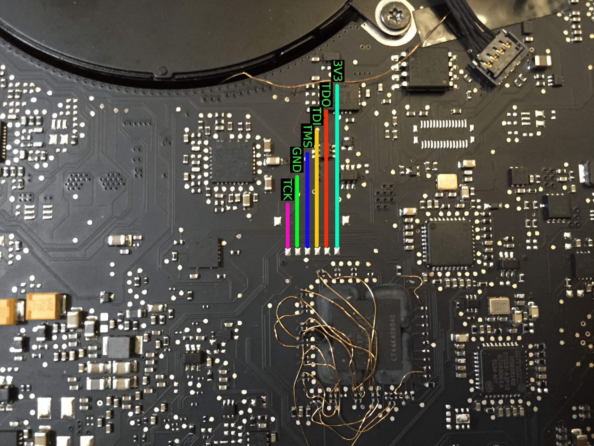

Hi, I recently flashed gmux on my mbp15 (with a lot of effort because it would not flash it if I didn't removed the coil) and everything seemed OK until I tried to install bootcamp on this machine. For some reason when I select the windows dvd to startup (from startup boot menu) it gets the selection (pointer stop moving) dvd spin up but it does not go further . I tried also to start an EFI win 10 installation with the same results. Is that a known limitation with gmux flashing? Can I bypass it somehow?
No bootcamp without discrete GPU.

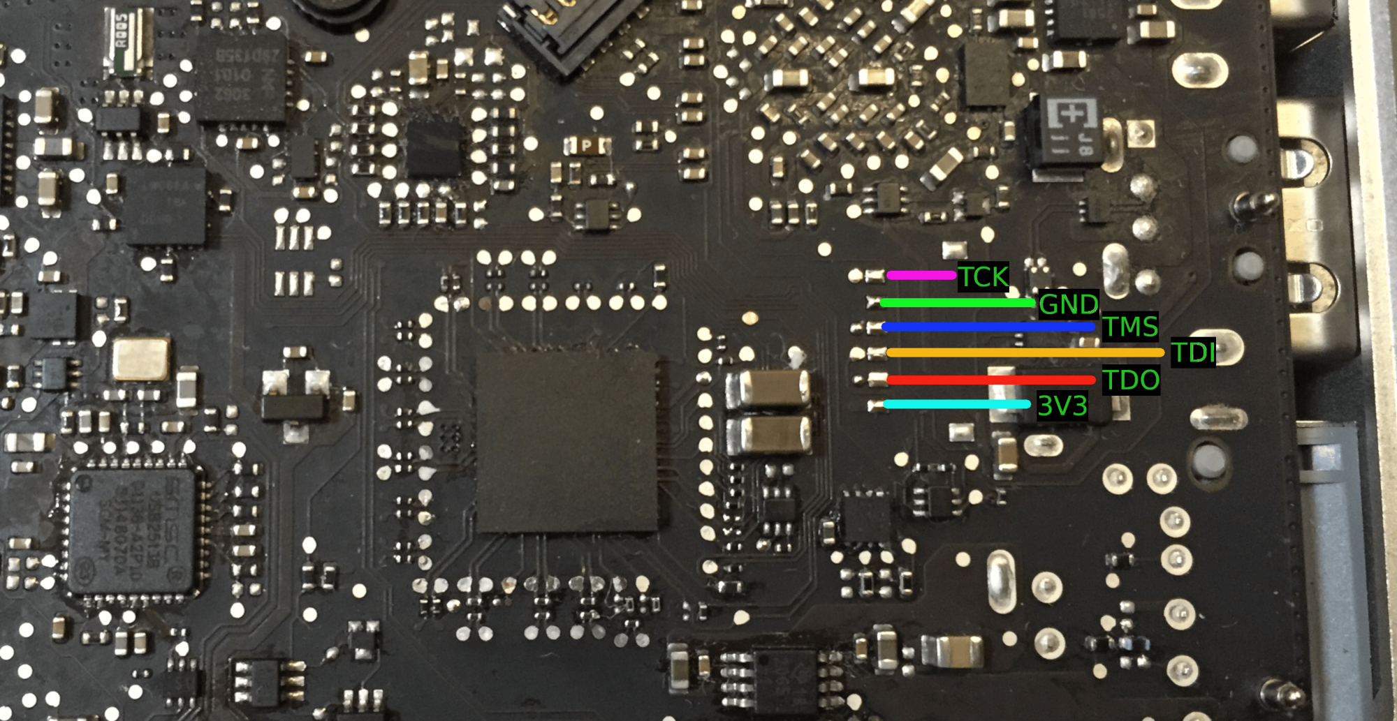

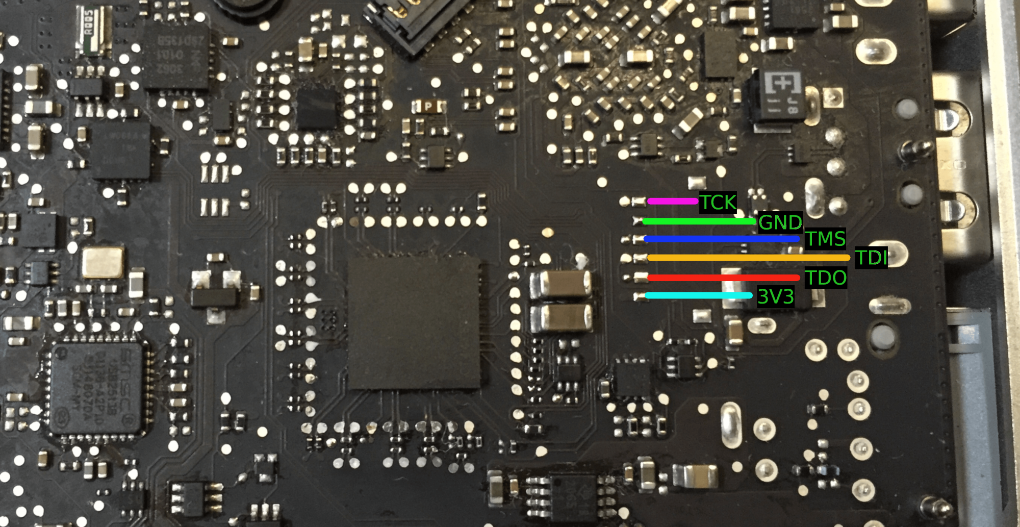

Hi everyone, my first post here.
First, thanks to @dosdude1 and the macrumors community for all effort to save our MPB.
I flashed gMUX on my MPB and its working fine. I have tried the battery button method to get brightness control working.
After the wiring I cant get the button working (double checked the wiring and solder points)
I missed something ?
Thank you all.
Check the spacing on the pins where you attach the 6 programming cables. I would be siurprised if they are a diufferent spacing
Uhmm. Interesting. They seems to be the same...
