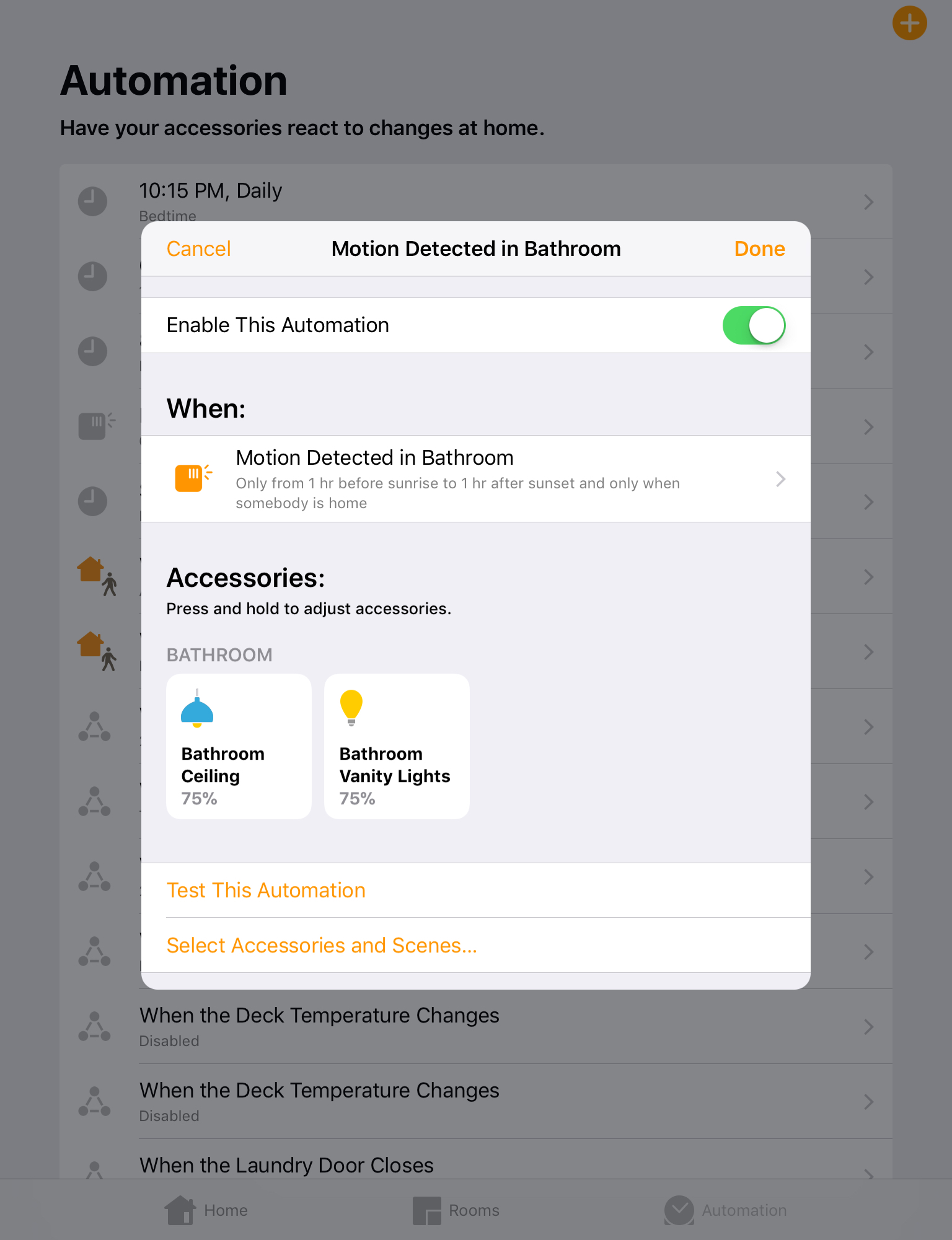

My Homekit sees the hue motion sensor, and they’ll show triggered on the sensors icons however none of my automations will work in the Home app?!View attachment 723284
I had to reboot my Apple TV to get them working but they seem fine now.

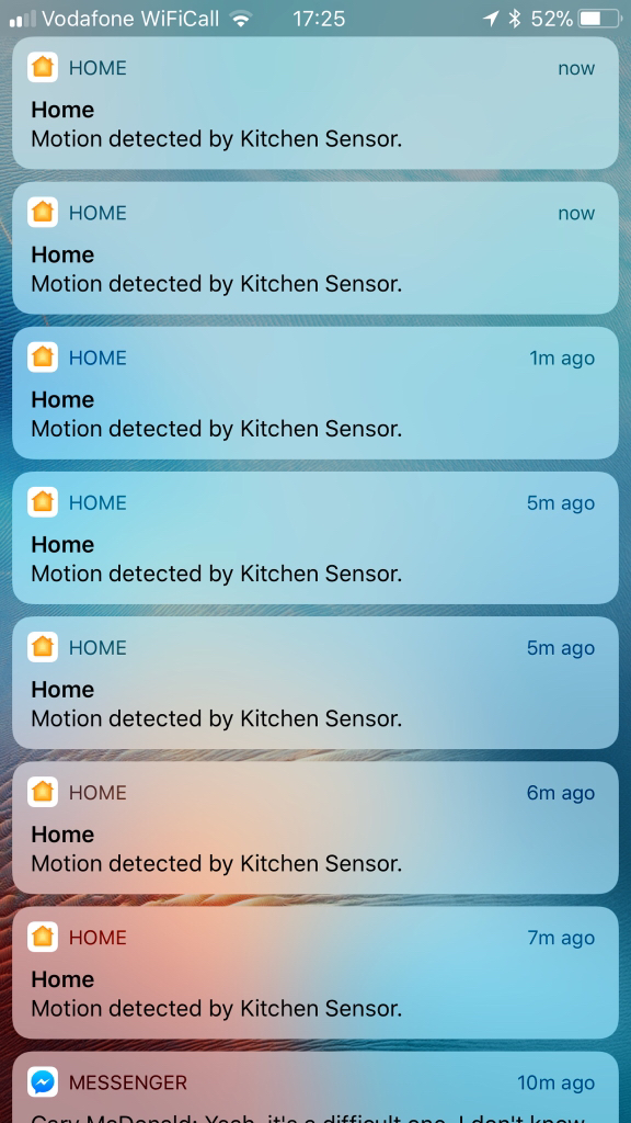

How do you get a notification to trigger for motion?
Not sure if someone else had replied yet, but if you click into the motion sensor in the Home app there’s a section for notifications.
However it’s fatally flawed for me in that it fires the alert over and over so wandering round my kitchen (which is square with about 2x2m floor space) keeps triggering as I must be slightly out of range at one point in the kitchen.
There’s minimal control over notifications - there’s a time of day option and an option for whether you’re in your home (eg only alert if you’re out).

Curious if anyone else is having issues setting up Switches/Sensors in the Home App. I updated everything (Hue App & Accessories) and following Hue's instructions successfully set up my first Hue Switch to control my lights along with a lamp plugged into an iHome device. When I tried to set up a second Switch following the same procedure all of the Hue based setting stopped working, but the new button commands I set up in the Home App would not work either.
I tried multiple switches along with a motion sensor all without success. Even tried to unpair a switch, re-paired it in the hue app, and set it up again. No luck 🙁
Anyone else having this experience or have any tips? Thanks!
The problem right now for the motion sensor is that there's no way to control how long the sensor remains in the "detected" state. It goes into "not detected" state in about 10 seconds without motion, so unless you're hyper-active the movements it missed will show up in the notification like that. Elgato Eve Motion mitigates this somewhat by letting you control this detection duration.

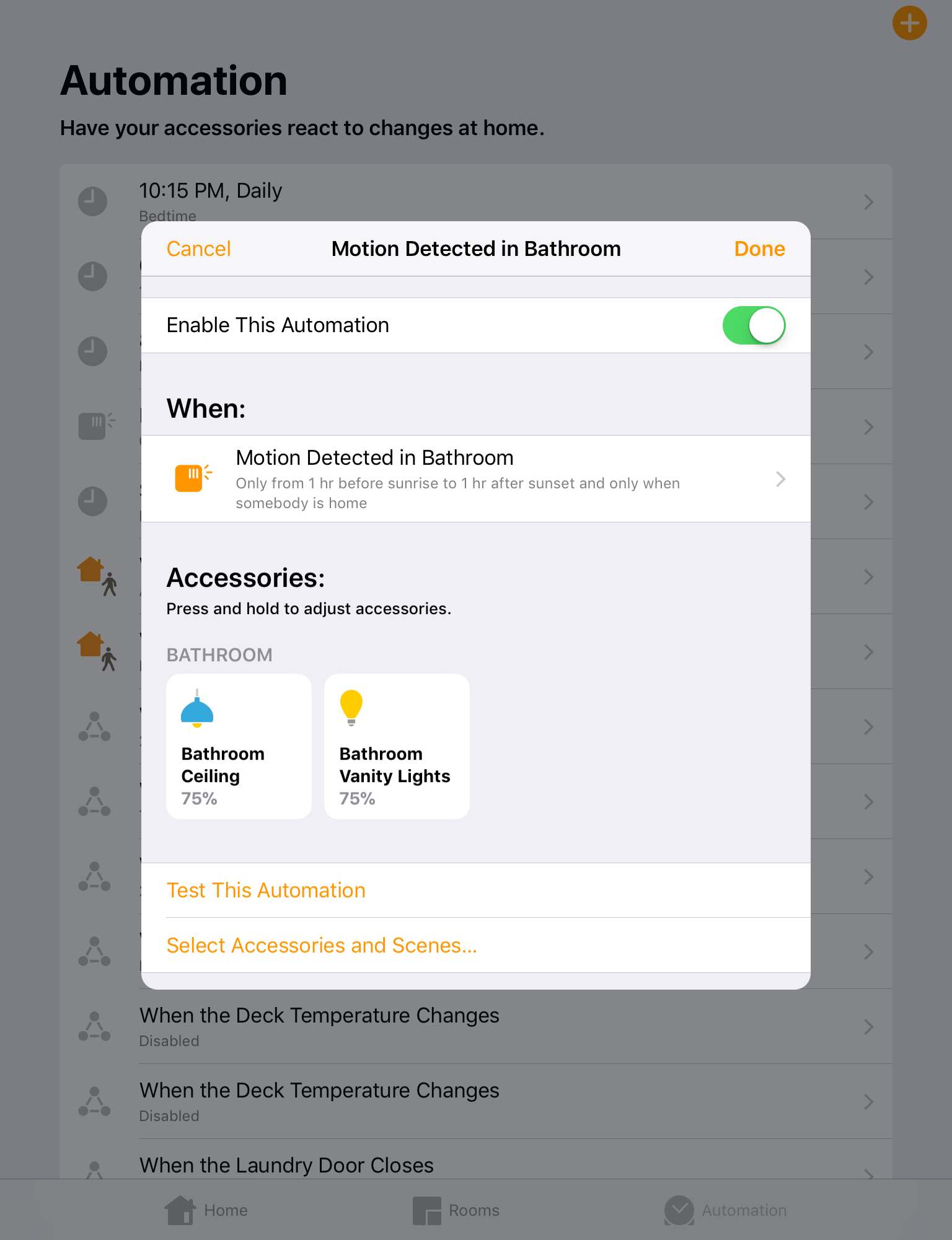

Has anyone looked into how the ambient sensor works with the lights? I don’t see a way of telling the automation to not work when there is enough natural light. The Hue app had it all in one page. I don’t really want to add a separate automation turning off the light as I think the two will just battle turning the lights on and off.
It's not possible yet... but I wouldn't be surprised if this sort of functionality is added down the track.
What you *can* do is to make the automation only activate during certain hours (ie. daylight) in the meantime.
Ahh. I feared as much. I guess it no big deal really. Just means I’ll have to leave it set up to the Hue app. The only trouble is they don’t actively talk to each other. Each app doesn’t know if the other one has turned lights on/off. Hopefully they’ll add the twinned sensor that hue labs have as well.
