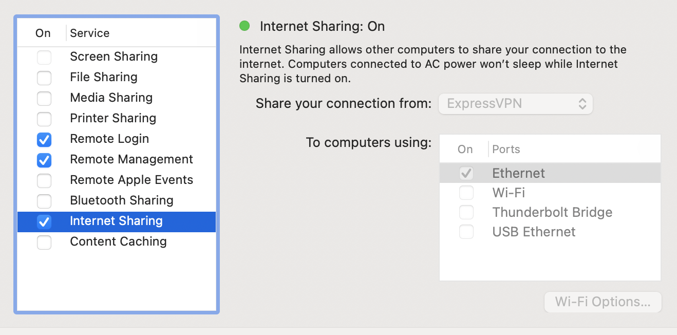

This doesn't work for me. Here's what I did:
1. Connected Bridge to Mac using Ethernet
2. Connected to ExpressVPN using L2TP to a Netherlands server
3. In System Prefs -> Sharing, Enabled Internet Sharing
4. Under Internet Sharing selected "Share your connection from: ExpressVPN" to computers using "Ethernet".
Hue app on phone cannot connect to Bridge.

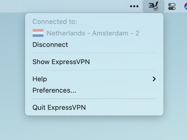

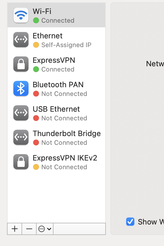

Yeah, been through exactly the same myself with no luck. Got the blue "Internet" light flashing on my Hue Hub, but it just won't go solid :-(
Mac connected to router via wifi​
Hue Hub connected to Mac Mini via ethernet​
Express VPN on MacMini connected to: Netherlands-Amsterdam-2 using: L2TP/IPSec​
Internet Sharing On, Share connection from: VPN Express, To computers using: Ethernet​
The VPN is working as if I check my Internet IP address on a site like whatismyip it comes up with a Dutch one.
Is there a step I'm missing here?

Same as you here. Really hope some guardian angel on here can shed some light - feel so close!
OK, persevere! I rebooted my Mac with everything set up as in my post above (i.e. the Hub still connected and powered-up), and once it rebooted and I reconnected the VPN it worked - three steady blue lights, and it's now downloading the update. I'd already rebooted numerous times with no luck, this was probably the third or fourth attempt and I didn't do anything differently, so just keep trying - good luck!
Congratulations!!

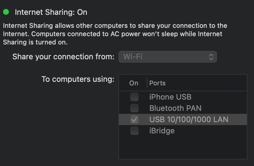

Here's my set up. Mac connected to router via WiFi, Bridge connected to iMac via Ethernet. Bridge only has the first two lights blue, not the globe one.
Have tried restarting to no avail.
Any ideas?
EDIT: Ticked USB Ethernet too and now 3 solid lights but Hue app "Unable to connect"...
Woo! I got it to update. Well... it's "Updating..." so fingers crossed!
I fixed it by enabling the Remote Access in the Hue app.
Yeah, that's a very good point, you'd need Remote Access active in the Hue app as the Hue won't be sitting on the same network as your phone - glad you got it sorted!

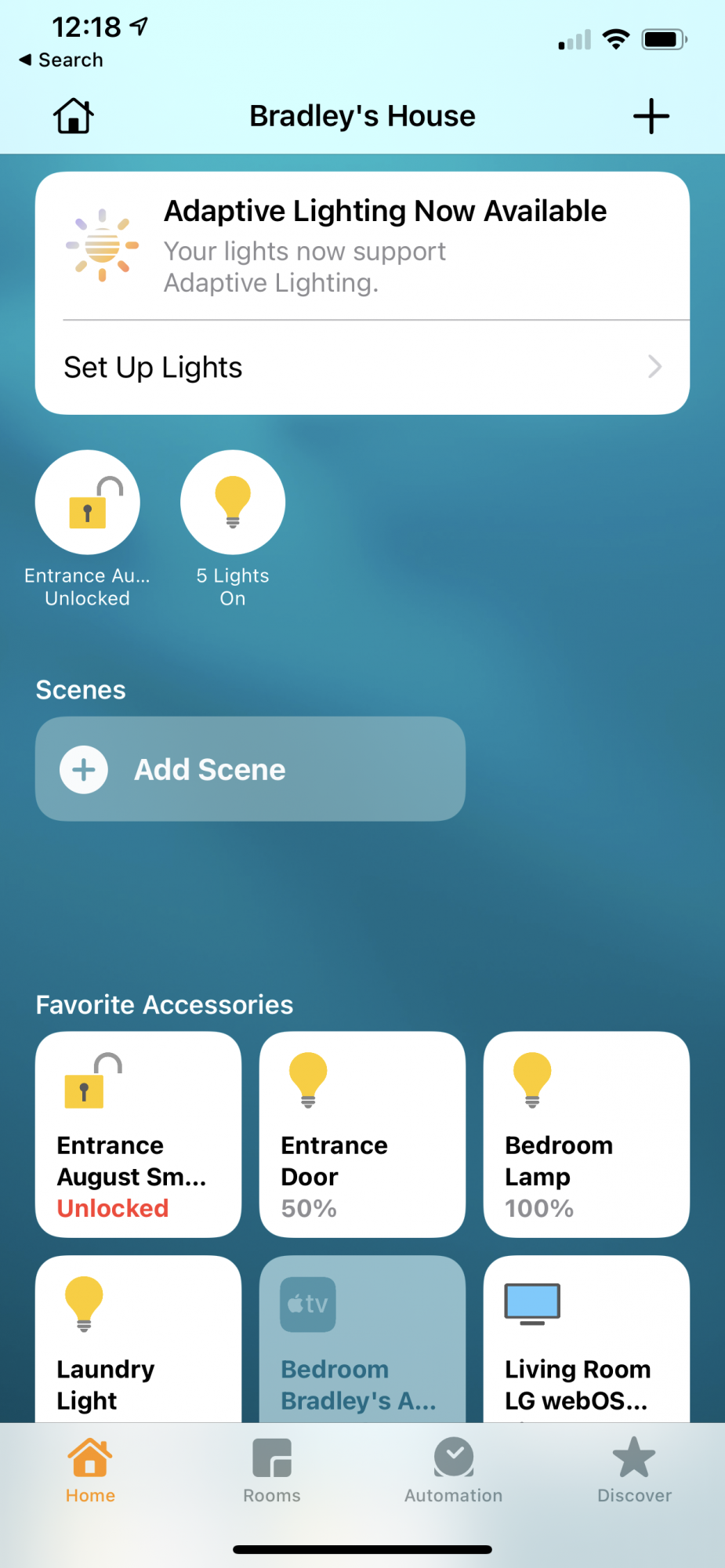

So folks, how do you get the update then? what is the definitive answer? I'm a UK resident... Is it rolled out here already?
It hasn't but if you have a computer and put a Netherlands VPN on, connect the Bridge to the computer via Ethernet and share the connection (see the steps above) it should work. Make sure Remote Access is enabled in the Hue app.
As for the feature itself, it's running well - the sun has recently set here in the UK and it's definitely warming the temperature but very slowly. It's a little bit less warm than I'd like for this time of day, but I can handle it if it gets warmer than this over the next few hours.
Notably the lower the brightness, the warmer the bulb (I think this is in addition to the gradual warming at a fixed brightness, but not 100% yet).

Woohoo, thank you for the tip! I found out that the Hue app signed me out of remote access in the past year or so. After turning it back on I was able to update it!
