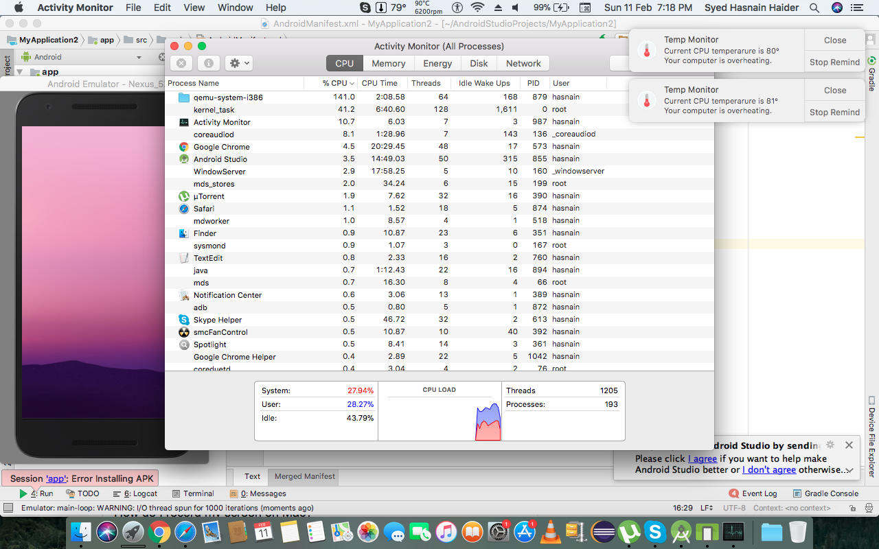

Hello, i recently bought a macbook pro 13 inch 2011 late. I bought it for development purpose and i am worried about its temprature. Please have a look at the temperature of my macbook and suggest me is it ok ? or should i do something in order to prevent ruining my machine.
As you can see the temperature is about 91 celcius & rpm is 6200 as per smcFanControl readings. and Temp Monitor app showing 79 celcius.

Note: I am using my machine on a hard surface so everything regarding ventilation way is clear.

That’s normal when the machine is working hard, and it is—according to Activity Monitor. The CPU monitors itself just fine and will slow down if it needs to to keep its temperature within operating limits. Those two warnings you see aren’t from macOS, and should be ignored.

This is incorrect. It is most definitely normal...the "temperature warnings" are from a useless app installed by the OP...and they are making false statements saying "your computer is overheating." 80C is not overheating...over 100C is overheating, and the computer will not allow the CPU to get hotter than that...
OP, your temperature and fan speeds are normal for what you're doing. When the CPU is working hard, the system will heat up, and the fan will come in at full speed to cool it down and maintain performance. Get rid of the temp monitor or at least the notifications and you will be much less paranoid.

U r right. Thought it was Apples warning. There is one which I triggered once while having my MB in full sunlight

OP has a decent load on the CPU, so nothing surprising here for 2011 13" : Elevate the rear of the notebook will help a little, try Chrome canary versus Chrome, might lessen the load. Ideally you'd like to be peaking at 85C, equally not always practical and nor terribly detrimental if exceeded. High 90's CPU will throttle, exceeding 105C CPU will potentially hard shutdown.
Also worth cleaning out the cooling system on a notebook of this age, just be mindful the fan blades are very fragile.
