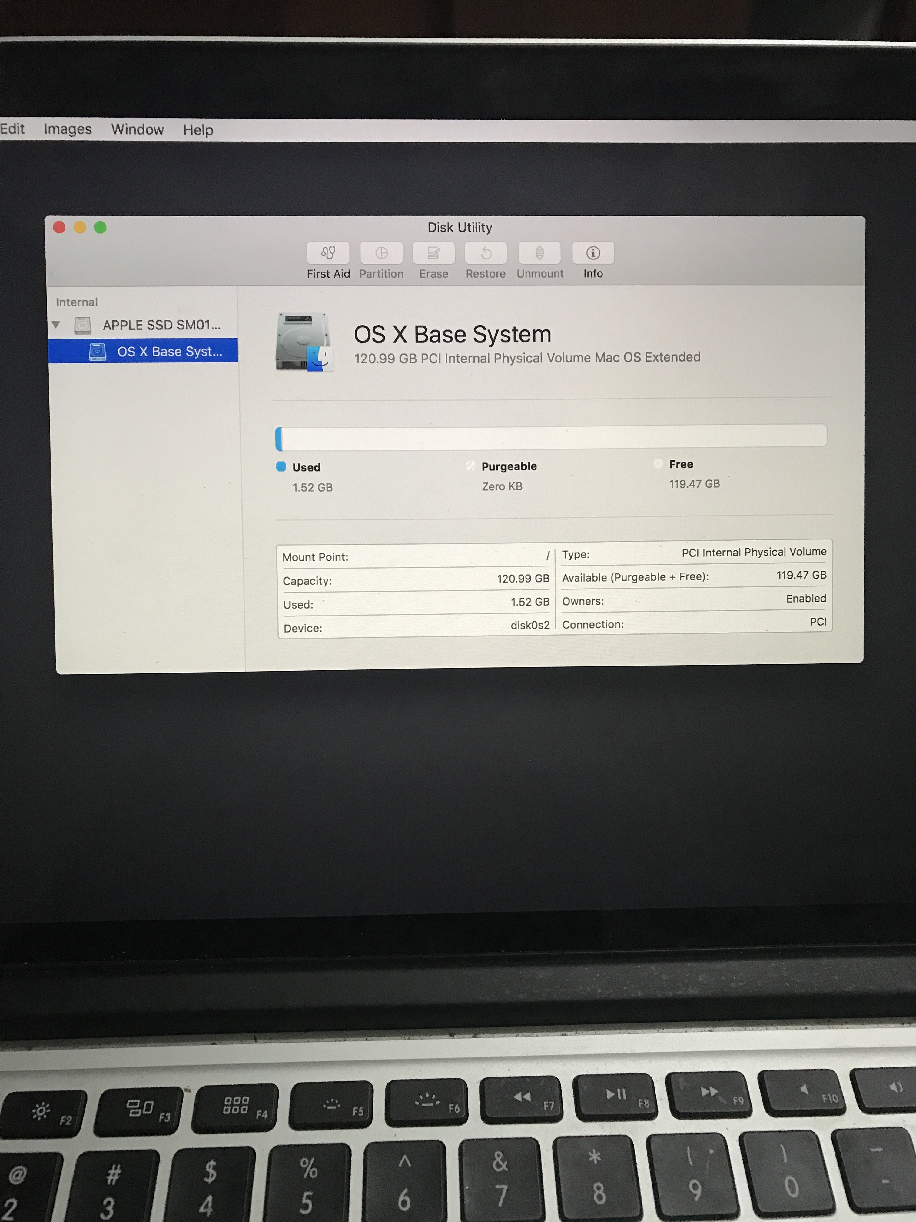

Hi, I'm lost, I wanted to reset my MacBook Pro retina back to factory reset. However, when I erased the startup disk I did not back up anything because I did not have anything valuble to save. Now, when I try to reinstall macOS Sierra I am unable to select the "OS X Base System" HD. It's says "this disk is locked," and I'm unable to install it. Is there anything that I can do to fix this issue?

OS X base system is the recovery OS bit IIRC. Basically sounds like you need to create a new volume in Disk Utility for the OS to install to as you won't be able to install onto that.
Go into Disk Utility and you should see an indented partition under your SSD which is about the size of your total drive. If you don't see anything there you'll need to create a new partition.

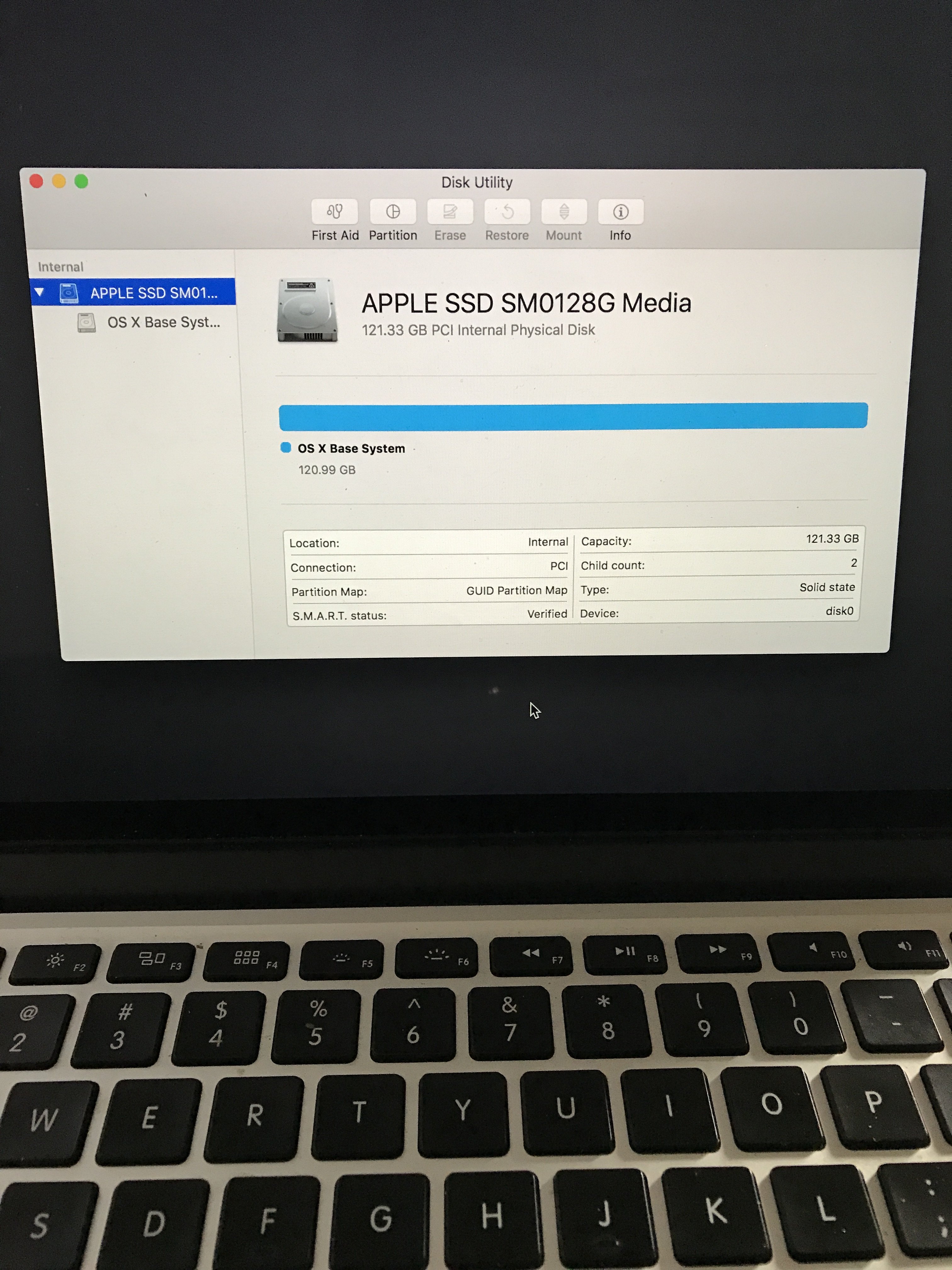

This is what I see appearing on my screen

Try clicking the APPLE SSD SM01.. , I reformatted my Mini recently and I think that's where I had to select because I could do any kind of partitioning. To put it simply, the SSD is the base container, while the OS X Base System is just a partition. I think.

Ok. When I click the Apple SSD everything is greyed out. I'm only able to select first aid, partition, and info.

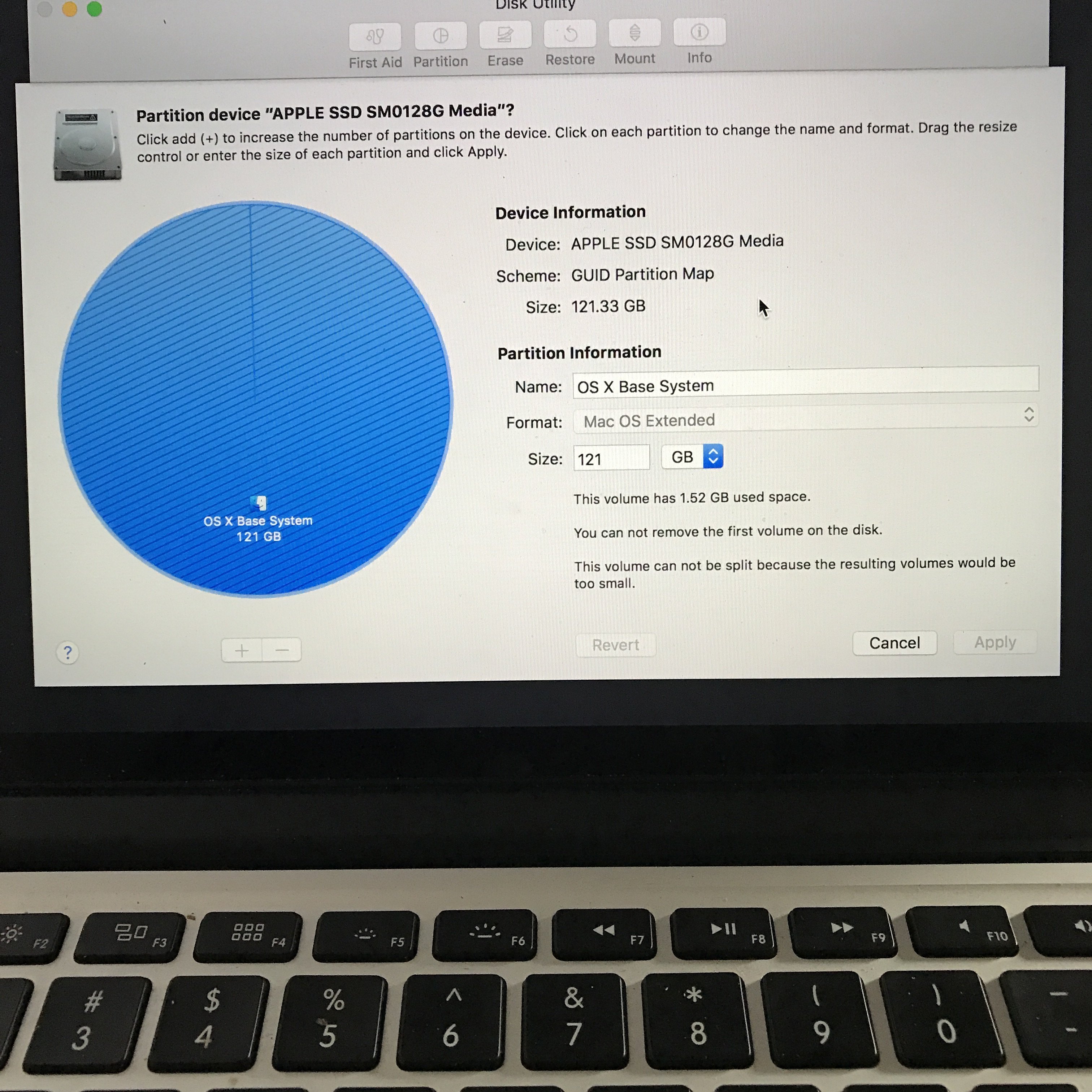

I tried to make a new partition but it does not allow me to do so.

I think the issue there is you have done a command-r boot to the local disk based recovery, and you cannot format the drive since you are still booted to it.
Reboot and hold command-option-r to get to Internet recovery. After selecting your wifi you will see a spinning globe while the recovery utility downloads. Then you will see the recovery screen. Now use Disk Util to erase the drive by selected where is says Apple SSD at the top there then erasing.
