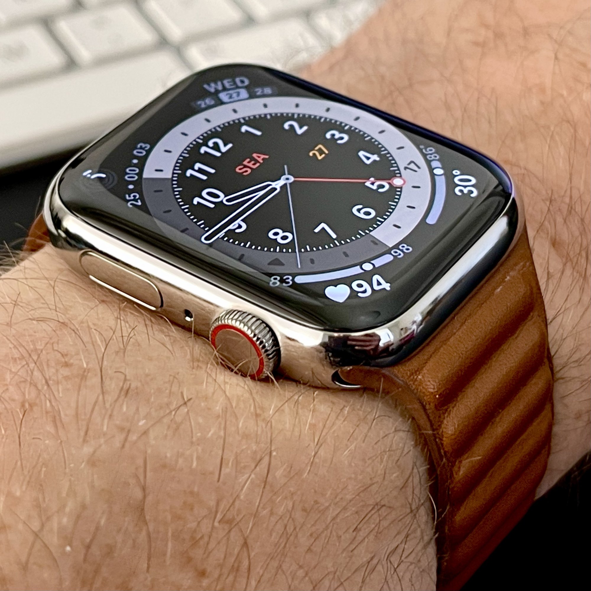

So I posted some pics of this in the 'show off your watch' thread, but I wanted to share more detailed instructions for anyone who's interested in doing this.
After owning nothing but stainless steel AWs since launch day in 2015, I decided to go with Natural Ti for the S7. While I think the brushed finish looks classy, I really missed the polished look of the stainless steel models. So I decided to polish my watch to a mirror finish to see how it would look. It turned out pretty good!
On my first attempt, I used a CapeCod cleaning cloth, and followed up with a Blitz polishing cloth (both from Amazon) and it looked decent:

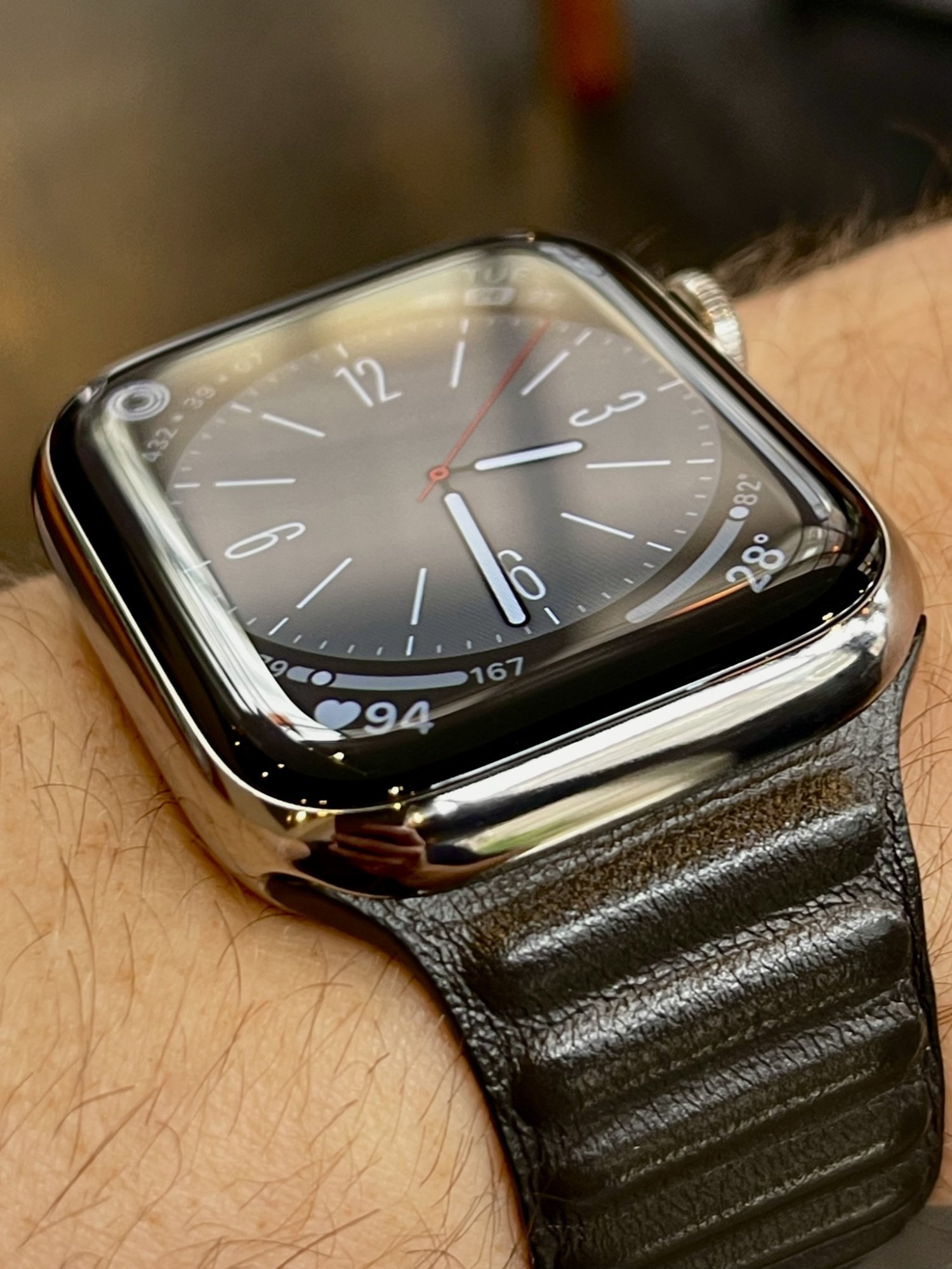

I noticed some very faint striations in the metal, though, and decided to use a heavier-duty polish - Mother's Mag and Aluminum polish, with a Dremel Micro. Basically, I cut a Q-Tip in half, and use it with the Dremel to polish the watch. I then switch to a polishing disc and use that to buff it out. The entire process took about ten minutes, but it made a big difference. Here it is with a Nike Blue Orbit / Gamma Blue band:
and with a black leather link:
Very shiny! Lol ... My Titanium Apple Watch looks like a stainless steel model now, but I think the polished finish looks much better than the brushed finish. If you want to polish your Titanium watch as well, it only take a few minutes!

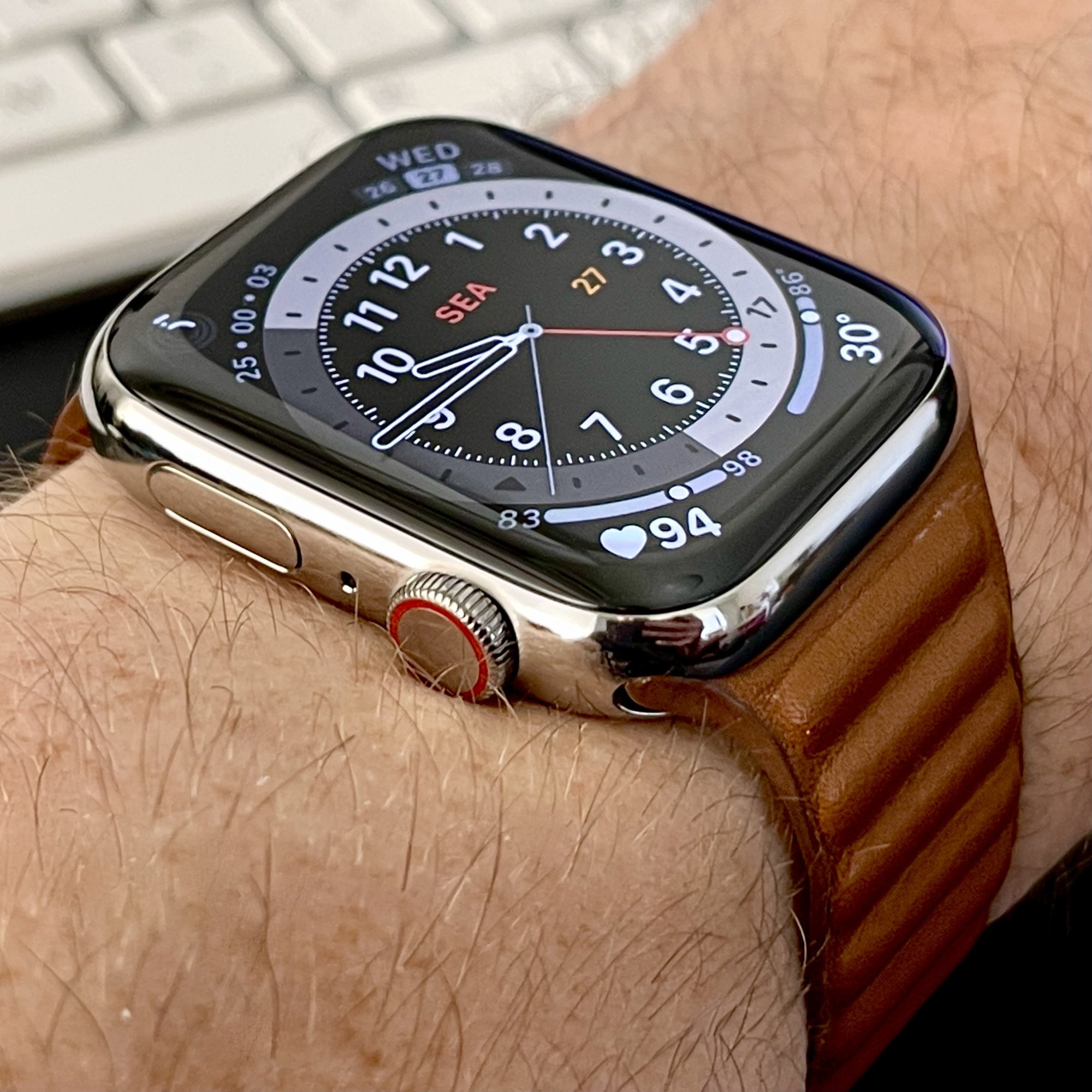

Here's a quick snapshot - I'll try to take some decent pictures later. The button/crown side looks ok, but there's a .5mm area around the crown that I can't get to, to polish. Not actually noticeable unless you take a picture and zoom in.
edit: sorry, just realized that I wasn't wearing a shirt in that pic and you can clearly see a nipple. 😂 I'll post pictures later.
edit2: here ya go. No nipples visible. lol

you did a real nice job, and yes, I was wondering about the area around the crown since you can’t pull that out.
It looks from the pic that the side button is shiny too, so that must be Ti then. I honestly can’t tell from looking at mine if it is or it’s a nice fake one :)

Yeah, the button seems to be titanium after all. At first I didn't think it was, because it didn't seem to polish as nicely/quickly as the rest of the watch, but after trying again with my rotary tool (not a real Dremel Micro, just a cheap knock-off) it ended up polishing well. Anyway, I'll try to post some additional pictures later today or tomorrow.
