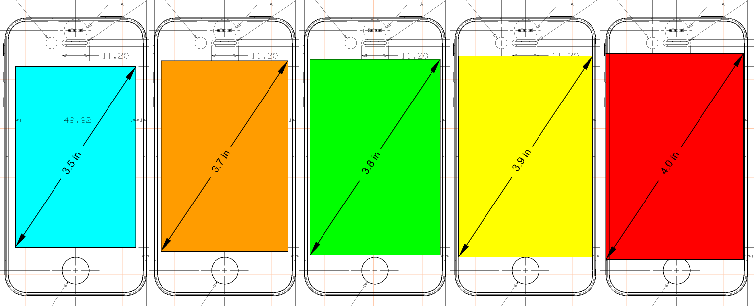

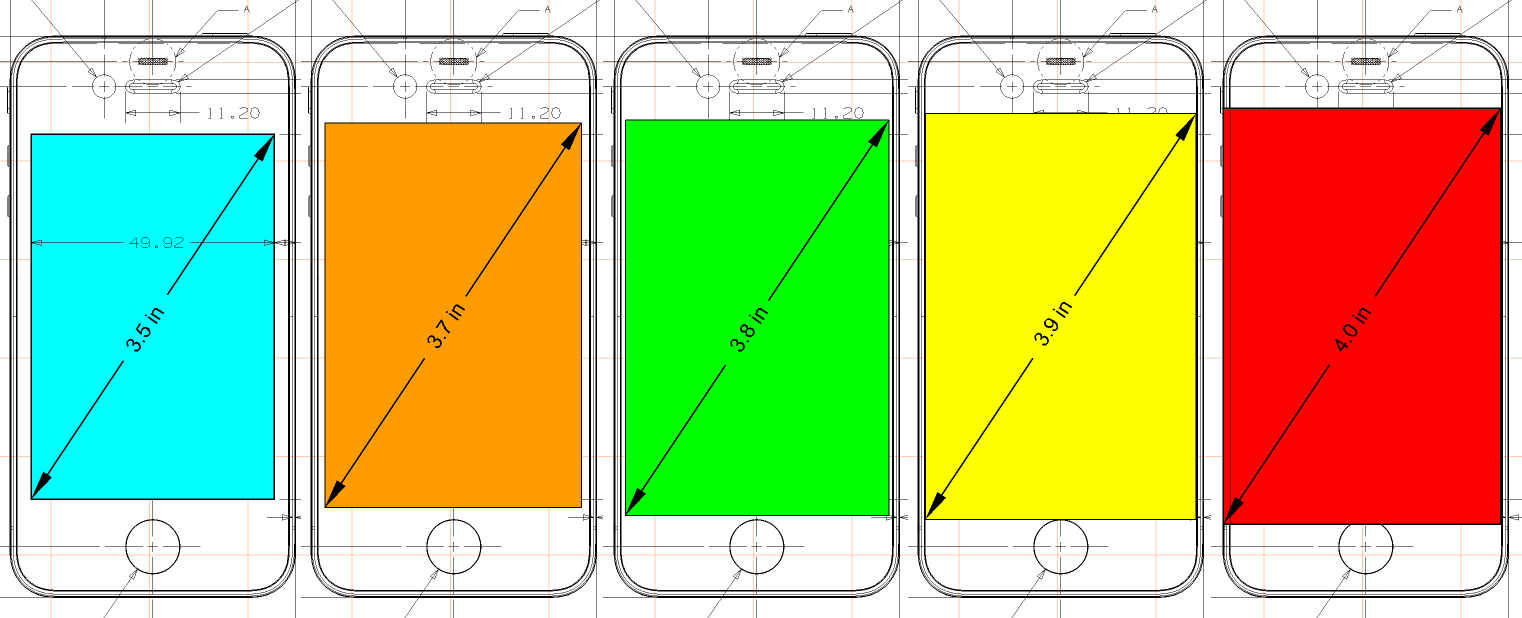

Since I had the iPhone 4 CAD drawing that Apple gives out to case makers, I put 3.5, 3.7, 3.8, 3.9 and 4.0" overlays on it so show exactly what will and what won't fit in the same iPhone housing. As you can see, 4.0 is not even possible. 3.9 will go edge to edge and I'm not even sure that's possible. It looks like 3.7 or 3.8 is the only option...
The current 3.5" "retina" screen is 326ppi (pixels per inch).
Variations according to size:
3.7" = 308.39ppi
3.8" = 300.24ppi
3.9" = 292.42ppi
4.0" = 285.25ppi
Technically, the human eye cannot descern anything above 300ppi, so Apple could do 3.8" and still call it "retina".
Anyway, this is good for reference if nothing else...

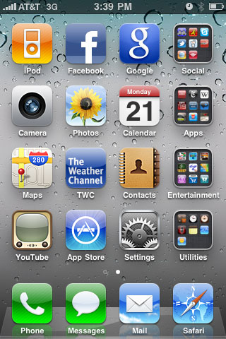

Pretty nice! Hopefully it's at least 3.8", I'm hoping for 4" though since otherwise I feel the increase would be negligible and wouldn't really allow for any benefit (such as a 5-column homescreen, for example).
Great to get an idea of exactly how it would work though. I think a 4" 'edge-to-edge' screen might still be able to work if the metal antenna bar in the center still extends out slightly from the front and back panels though. Thoughts?
Are you sure these measurements are correct? Because there were articles of an edge to edge 4" screen posted on numerous tech sites. How about moving the home button down a bit and increasing the sides just a bit? Hmm.. i doubt Apple would do that though.
Well, i hope Apple changes the form factor a bit then. Otherwise heres hoping for a 3.8" screen.
You mean 5-row homescreen right?
Well there are 5 rows right now if you include the dock, so essentially what I mean is for 5 icons across (and 5 down) above the dock, and 5 icons in the dock.
Understood. Do you think that'll be reasonable though on a 3.8" to 4" screen?
I'm confident they're correct. Now, if Apple decides to change the aspect ratio (which I kept) then they could go skinnier and taller and get 4" in, but that would screw with everything...
This is good info, thanks. I'm surprised no one had done the calculations before.
Apple would never screw around with the aspect ratio, so 3.7 is probably what we'll see if there's a screen size increase.
I completely agree, and i doubt they would be messing up with the aspect ratio. So we're looking at a 3.8" screen then, to go hand in hand with the rumors. Well, would .2" make a difference?
I think it would make a difference. It doesn't sound like much but its still a 5.4% increase. They have high paid marketing people that will make you think it makes a difference.

Sedrick would you mind to put all 5 pictures in one row, so i could better see and imagine the differences?
I really want a 4" screen, but if 3.8" is the max. for apple because the wont change the size of the device, from what i see 3.8" is a difference you will notice.
Als keep in mind, that if the go above 3.8", the ppi will go under 300, so i think it wont happen.

I wish someone would take the time to post hypothetical homescreens and app windows - because then it would be apparent how there is basically no benefit in such a small increase in screen size.
If all Apple does is increase the screen size by a measly .2", big damn deal.
That's like paying .99 cents for something as opposed to $1.00. The difference is so minuscule why even bother.
