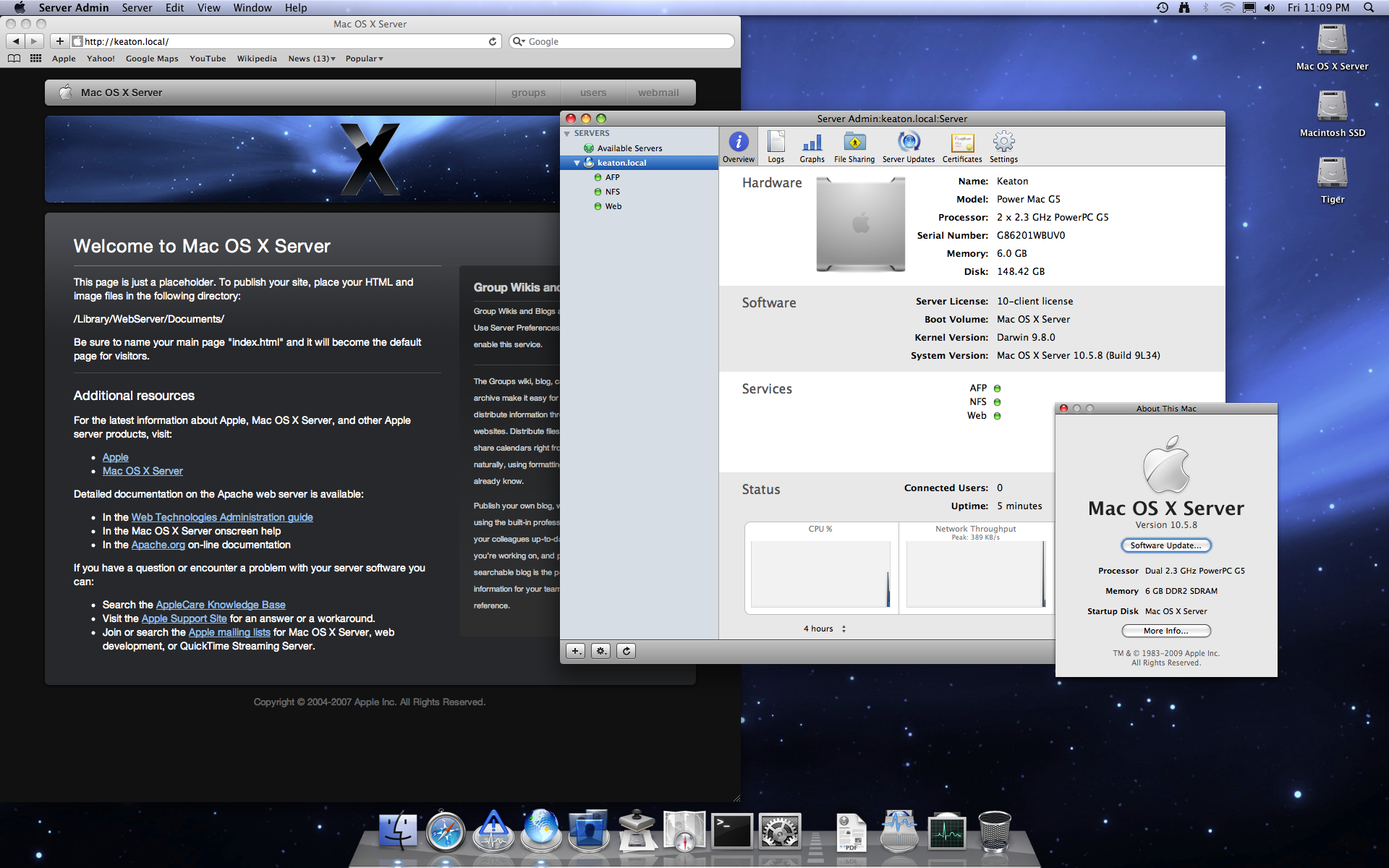

Since I was only able to find a single low-res shot of Mac OS X Server in this entire thread...
Got a Mac OS X Leopard Server retail install disk earlier this week and today installed onto my current best PowerPC Mac, my first time running a server version of Mac OS X that predates the App Store. Still seems to be pretty capable, though outdated and probably with known vulnerabilities.
I do wonder if it would be possible to install newer versions of Apache/PHP and use this as a modern web server, but truthfully I already have a Mac Pro running Sierra Server for that.
Reactions: AphoticD
What a beautiful Server UI!
I imagine Homebrew or MacPorts would allow you to update to a current web stack, then you could manually use symbolic links for the default binary paths. In theory, things should click into place so long as there were no major infrastructure changes for support files.
I have Leopard Server setup in VMware Fusion as it is fully supported and makes a usable test machine for Leopard-Intel app support.
It really is beautiful, I was thinking I even prefer it to Apple's current Server app for MacOS Sierra. Simple to set up, but the more advanced stuff is there for when you need it. Even MySQL is built in, which is not the case for Sierra's Server app.
These methods are compatible with PowerPC Leopard? Not too familiar with either, only once used Homebrew to install something on an Intel Mac.
I didn't think of virtualizing it on a newer Intel Mac, but you're right, the server version is supported to virtualize. Should make an image of my install disk and try it for fun sometime.
Reactions: AphoticD
Yes, but I should say TigerBrew for PPC Tiger/Leopard ‘brewing.
MacPorts is possibly a little more on the stable side, whereas Tigerbrew is more experimental. Either way, they both work and in my experience, ‘brew is quicker to install and often doesn’t require as much compiling from source.
