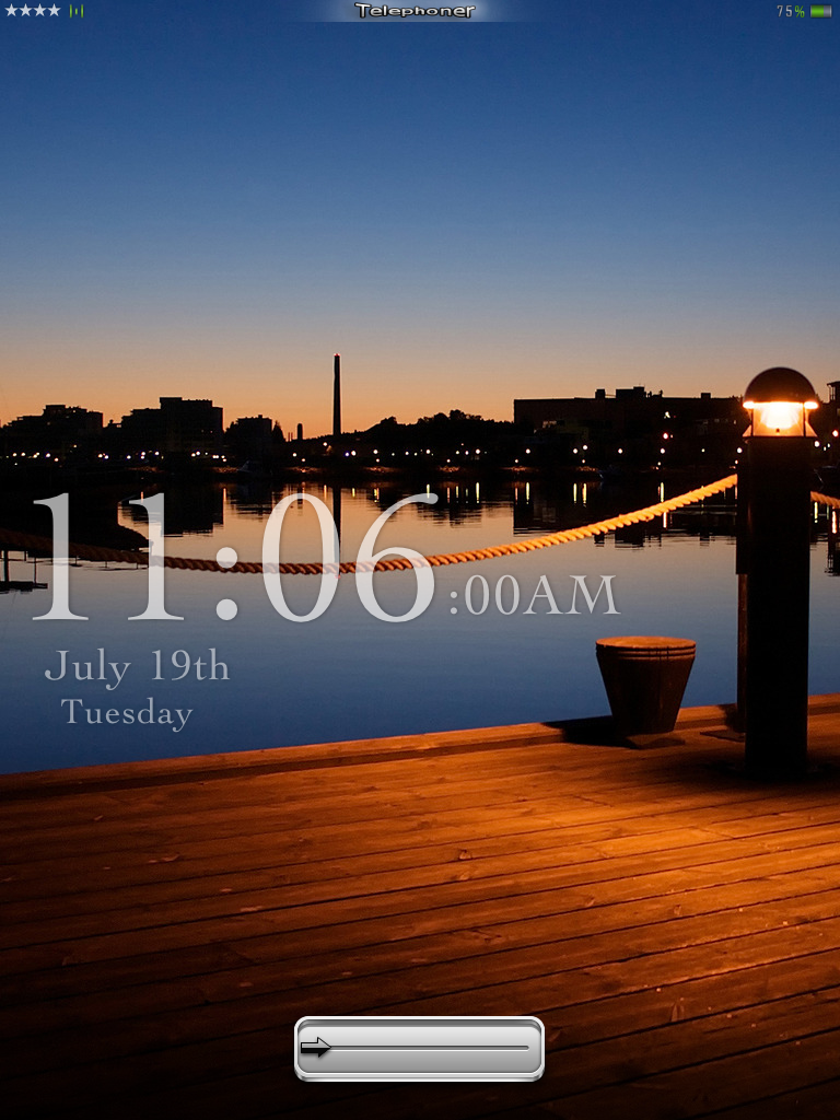

iPad Ring Slider & Transparent Status Bar
Transparent Status Bar 4.0 from Cydia works fine, but I've also included it in this download. The Ring Slider credit goes to the creator (I've never been able to find out who made it.) All I did was move it up a bit and get rid of image files that the iPad can't use. Included are the Cydia themes for Slide to Unlock Killer (bar) and (text) so that you can use just one theme in WB to cover all of that. Less clutter and fewer performance issues that way.
I didn't include the picture frame button killer as some people do use that function. I'll be adding that one to my personal master theme though. LOL
[For newbies to theming--this will clear the bottom of your lockscreen (except for the picture frame button) and give you a ring slider in its place; you'll still need to download Lockscreen Clock Hide or the equivalent from Cydia to clear the top for your LS widget.]

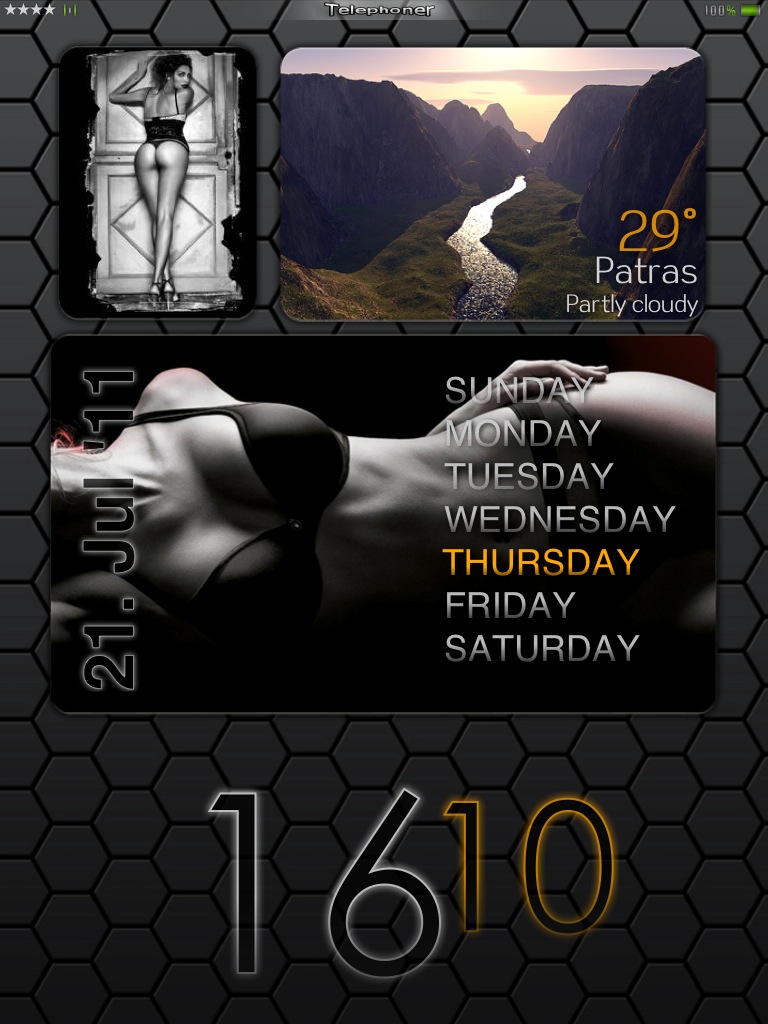

Man i like that lockscreen you got there.. mind giving me some details on it and how to get it set up.. ive been figuring it out and i cant get **** to work.
Looks like a mod of Breeze HD Classic version (I'm running the Alt version on mine). You can download it from here: http://macthemes.net/forum/viewtopic.php?id=16807187 and tweak the position of the time/date in the HTML.
If you're having problems getting things to work, more details on what you're seeing are going to make it a lot easier for anyone here to help you. "Can't get **** to work"--well, I've been there, and I know it's frustrating, but I can't help you fix it based on that description. :D
My current LockScreen and HomeScreen setup (thanks to my friend romeodim)

Looks like i managed to get it to work after the poster posted a url and what he used to make it work, right now im trying to figure out how to set the weather to my location, its hella confusing finding it.
The default for the original code is the AccuWeather.js, and you should be able to change it in there. If you prefer YahooWeather (most widgets use that instead), you can replace the code in the yahooweather.js instead, and then you'll also need to change the code in the HTML:
Code:
<!-- Choose your source of weather information, accuweather.js or yahooweather.js -->
<script type="text/javascript" src="yahooweather.js"></script>
(The original says AccuWeather.js in between the quotes. Change it to match this one for Yahoo.)
Open yahoo.js and var postal = (your zip)

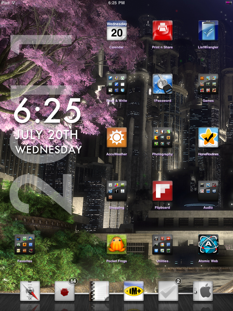

Today's setup, using surlygirl's port of z|ui, plus moved Breeze to the SB & tweaked a bit. No, it doesn't rotate, but I use my iPad in portrait 90% of the time anyway, so it'll do until someone figures out the rotation issue or I have time to work out another widget. Maybe one at the top...
click below to see bigger version
(wall from Digital Blasphemy)

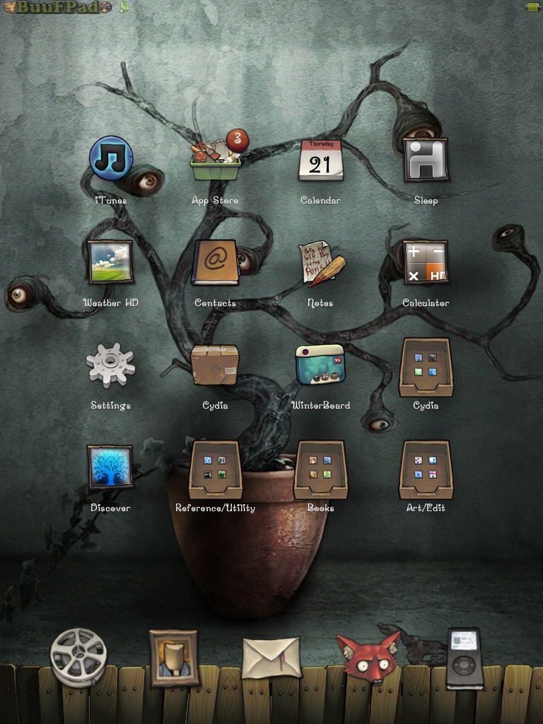

The new BUUF for iPad. Although I'm a freak for a good calendar\weather widget, I just couldn't get past the subtle blinking of the eyeball plant.
